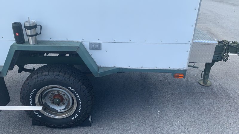

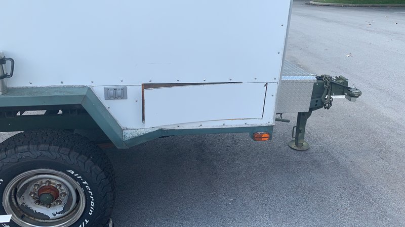

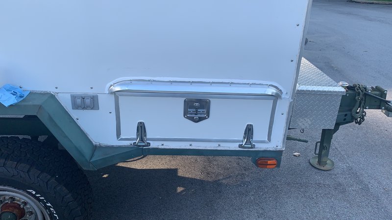

Some significant progress today on the passengers side door!
Where we started:

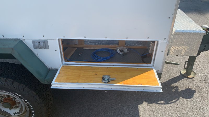

Routing out the door opening:
It looks like a door now! Better get it sealed before tonight's rain!

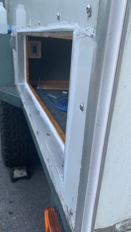

Aluminum trim cut, drilled, sikaflexed and screwed into place.

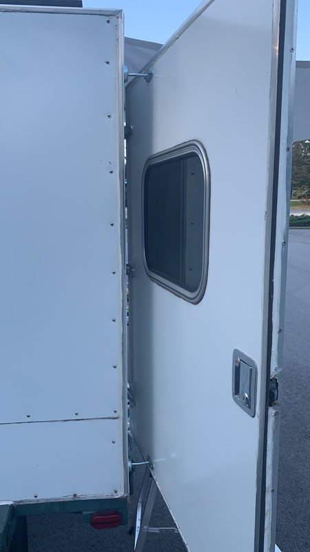

Door attached.
Drip cap installed.
The foam gasket is nice and even on this side. Look at those tolerances!
And everything buttoned up. Looks like we will survive the rain after all.

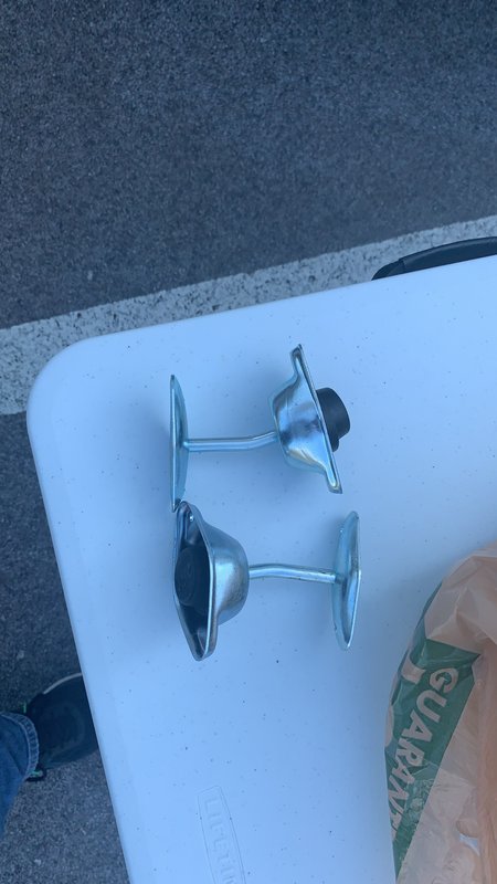

I also had some door catches to install.
They're on.
They keep the door from slamming open in the wind, and also hold it in place.
All of this accomplished and a bad sunburn. :? It was 97 F in the shade today.
