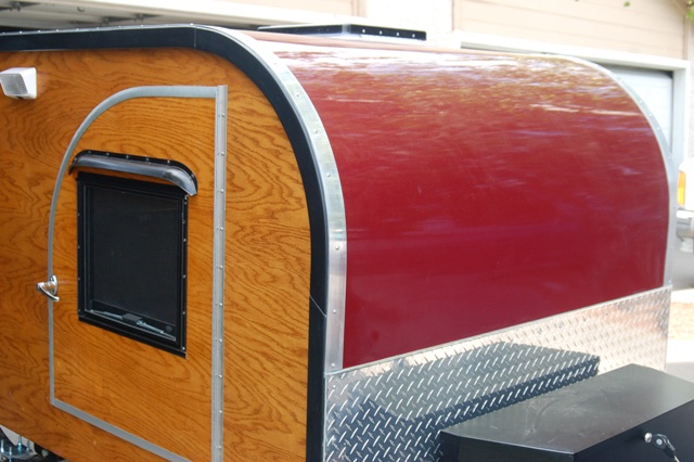

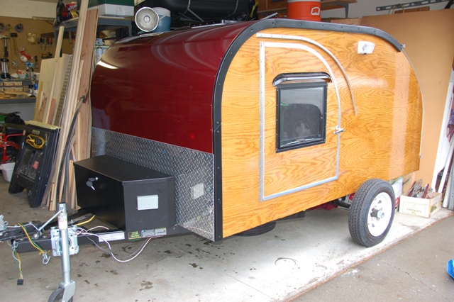

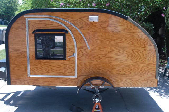

We sent baby to get painted last week and got her back on Friday. It looks really good! We decided to have it painted to match the CRV tow vehicle, tho we did give serious consideration to how much hotter it would be. It really does look amazing...we keep walking around looking at each other smiling! We're still trying to get 'er campable by the Dam Gathering...3 DAYS from now!!..so we've been busy.
This weekend, our son Dave polished the aluminum strap that will be running the length, overlapping the edge of the as yet uninstalled wooden trim. We predrilled all the holes for the aluminum strap...prior to painting, so reinstalling trim should go fast...we hope! We're painting the wooden trim gloss black.

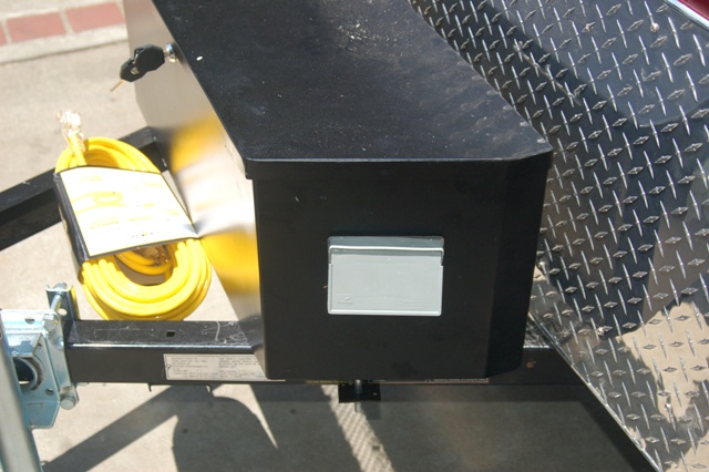

We have finished getting the tongue box ready, with battery, tender, shore power, etc. Will mount manana. We installed the Fantastic Fan without a hitch, and permanently attached the hatch hinge (which was removed for painting) and wired the hatch. (Lights work!) Played around with fenders...may wait for the great minds at the DG to offer suggestions. Bought the diamond plate for the front.

Thanks Cliff, Miriam. We'll get the trim and the diamond plate on before we head out! The paint color is "Tango Red Pearl". A friend of ours shot it for a lot less than we would have had to pay commercially; we bought the paint and gave him a couple hundred dollars...more than we should have spent probably...but we like it!

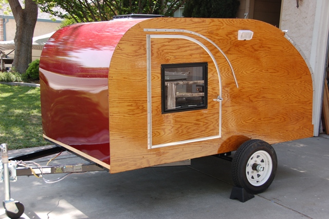

We got the wooden trim on the tear...will be using some 1 1/2" aluminum angle mounted to the hatch to mount hatch trim...but lost our oomph when we realized we wouldn't be making it to the gathering. There will also be a 2" aluminum strap overlapping the wooden trim.

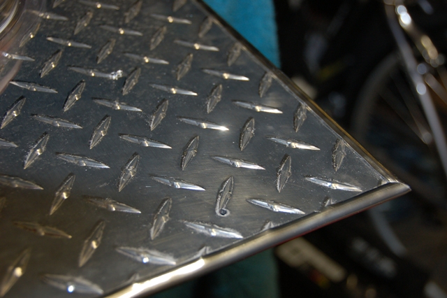

Got the diamond plate on the front. Looks great! Finished the edges with chrome door trim...it's uv treated so should last awhile.

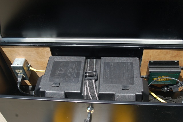

In the flurry of activity trying to make it to the Dam Gathering, I left out some updated pics. Leo did get the tongue box mounted and wired and shore power inlet installed.
He did a great job on the interior...nice and neat. Tho you can't see it in the photos, the battery box is vented to the outside using pvc.

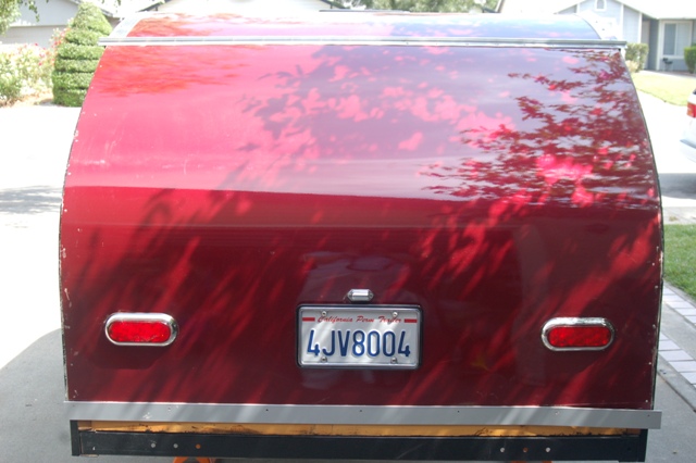

Taillights and license plates installed. Went with LED lights. The bottom will be finished with diamond plate.

We did get the aluminum strap glued and screwed on. Used a poly sealer underneath. Looks sweet!

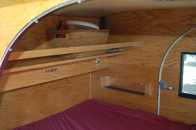

Cabin is campable. We went with a simple shelf with a rail. I just installed the lucite bin on each wall. We'll use it like a nightstand for glasses, water, books, keys & such. I got them at IKEA for $5. I put some of that bumpy shelf liner on the bottom. They're removable when you're making the bed & stuff.

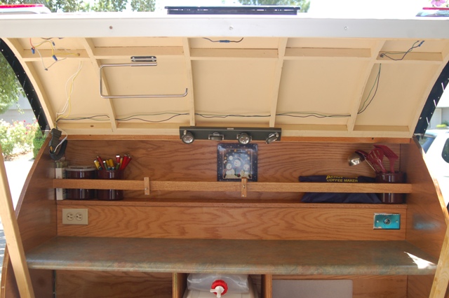

And the galley is also campable...tho unfinished. We still need to line the inside of the hatch & put drawers in & stuff...but so far, so good!

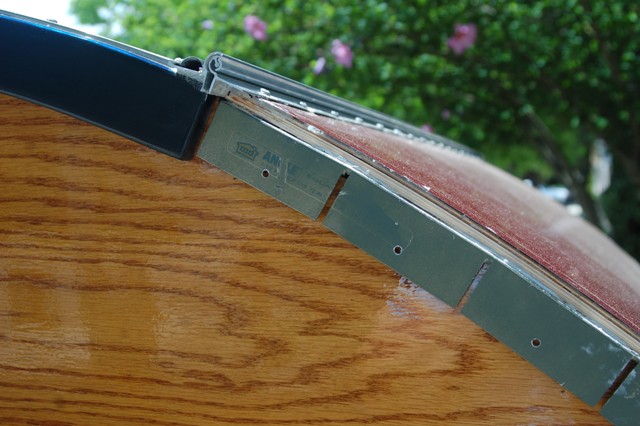

We kerfed some 1 1/2" aluminum angle and are gonna mount the wooden hatch trim this weekend. We'll then mount the aluminum strap on it also.

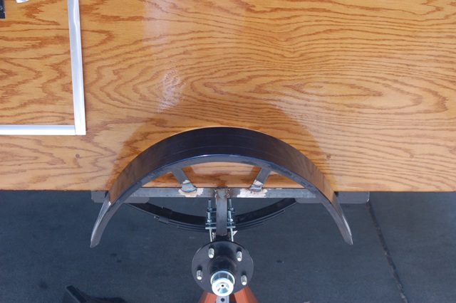

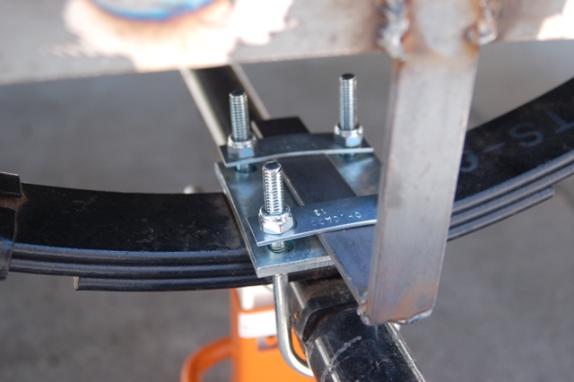

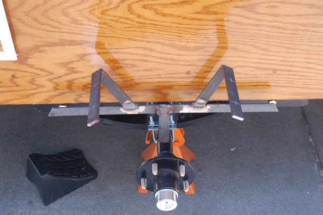

Fenders, finally!! We had a friend help us out ...he and my brother fabricated a bracket that lets us use the HF fenders for now...and doesn't mount through the plywood side. Slightly overbuilt but...it works!!
They replaced the U-Bolt with a longer one. The bracket mounts between the plate and the axle.
We'll use bolts to mount the fenders to the frame. Progress..anyway!!

Postby Cliffmeister2000 » Wed Jun 10, 2009 7:11 pm
cdfnchico wrote:They replaced the U-Bolt with a longer one. The bracket mounts between the plate and the axle.
Cathy, your trailer looks fabulous! :thumbsup: :applause:
I would like to suggest you put a nut between the normal u-bolt mounting spot and the fabricated strap. That soft strap will bend soon enough, and your axle might try to take advantage of its new found freedon and wander!

Postby cdfnchico » Thu Jun 11, 2009 11:31 am
Cliffmeister2000 wrote:I would like to suggest you put a nut between the normal u-bolt mounting spot and the fabricated strap. That soft strap will bend soon enough, and your axle might try to take advantage of its new found freedon and wander!
Thanks for the concern Cliff... that's not quite the final mount...I just slipped it in for a pic...everything should be snugged up tight!

Postby kennyrayandersen » Thu Jun 11, 2009 5:47 pm
interesting fender mount -- giving me an idea! :thumbsup:

Postby cdfnchico » Sat Jun 27, 2009 4:04 am
OK...the fender mount was a BAAAAAD idea....they shook like crazy! Despite a sturdier mount than my last picture...the movement sheared both U Bolts on one side our first time out! Then the welds weakened...finally just had to bust one off...it was not fun!
Have spent the week revisiting the fender mounts...as we have a week long trip planned for the 4th next week. Will post pics as soon as we get 'er done!

Postby kennyrayandersen » Sat Jun 27, 2009 7:36 am
[quote="cdfnchico"]OK...the fender mount was a BAAAAAD idea....they shook like crazy! Despite a sturdier mount than my last picture...the movement sheared both U Bolts on one side our first time out! Then the welds weakened...finally just had to bust one off...it was not fun!
On the plus side....the camping was awesome! The side tent worked great...and tho we went through a thunderstorm on our way home...no leaks!!
/quote]
OOPS -- This is not an uncommon occurrence during FSD (full scale development). Next, revision A. I guess mounting on the body might not be a bad deal after all -- it doesn't move so much. Incidentally a question comes up now and again about NOT using suspension on a tear... This is the exact reason that soesn't seem like a good idea either. :thinking:
