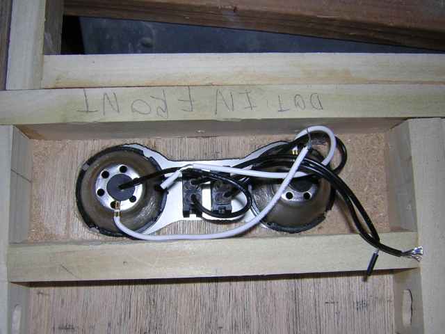

The lady at RV supply store had suggested that I purchase only lights that could be attached flush with the ceiling. That was good advice; but, I was so dazzled with this one set of lights that what she said didn’t even register in my mind and I ordered them anyway. :o
These lights require holes to be made in my newly attached ceiling skin to accommodate them. I thought about making platform boxes for them but didn’t think it would look right and it might have caused some performance issues. So, I decided that, if I was going to cut the ceiling plywood, I might as well do it now, before coating it with urethane. That way, if I goofed, I wouldn’t have wasted urethane or as much effort. Talk about being a chicken! :chicken: It took me two days to think about how I would do it and to get up the nerve to make the cuts! I cut only as much as was necessary to allow about 1/8’ space between the area where the wires are and the plywood. However, I have wood boxes built into the ceiling framework so that the lights will have their own dedicated space.
All the ceiling lights have been cut in and fitted. The little single in the corner is for the middle-of-the-night porta-potty.

I have VERY similar lights in mine, I love the look of these lights. As long as you have the board lined up for the screws to sink in to and you don't cut the hole dramatically too big, it's easy as pie. Easy to say once it's done eh! I think you are smart for taking the time to think about things, More than once, I have thanked myself for thinking about things for days on end. Sometimes that nagging feeling is right, and you discover what could have been a fatal error! But you know what, many times I have done this and still over looked something, especially when you get deeper into the build and you find that you have made an error that completely invalidates your plans... So what do you do? change your plans, think on your toes and invent, create, accommodate, and just like writing a song, sometimes and error will lead you to a different way of thinking that in the beginning is just a compensation, but in the end you like better than the original plan! (I screwed up my headliner cutting my moonroof hole, but now I get to make a really cool cover for it). So think hard and expect the errors, you will find ways to fix em that you like like better

JuneauDave: The lights are made by Gustafson Lighting
Single: #55-9544, AM4019
Double: #55-0128, AM4040

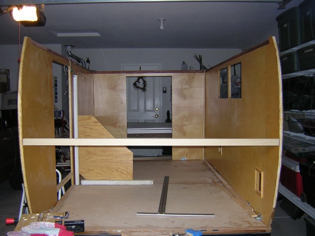

Prem wanted to see some progress. So, here ya go, Prem. :D My neighbor came over and helped me lift the side walls up on the deck. I did this last week:
The walls are presently held together by one screw on each side, front and back, and a couple cleats. I use the drywall square to ensure they are perpendicular to the floor. Anything else is just temporary support.

This must have been a proud moment when you took this picture. The plan is coming together! :thumbsup:

Congrats Sharon on the wall-raising!
It had to be a good feeling to see all your pre-assembly work coming together. Now you can visualize camping in your TTT.
