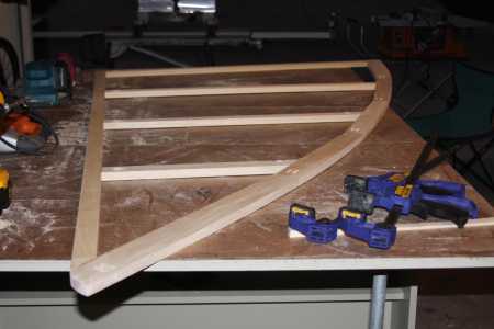

Postby wlivesey » Sun Jun 28, 2009 9:35 pm

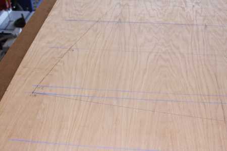

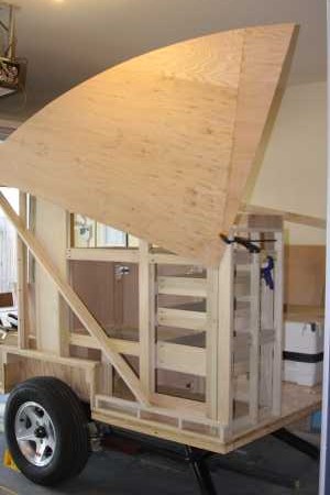

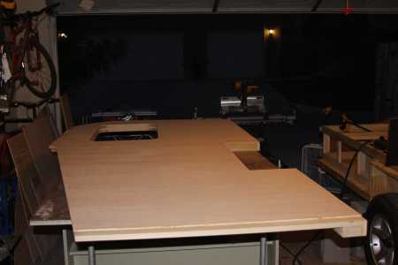

My wife and I didn't get much done this weekend. We really only got a template made for the hatch. We should start framing it up this week.
We made a 6 inch grid on a sheet of plywood. I also made a 6 inch grid in sketchup. I then copied the grid/hatch intersections, per sketchup, onto the plywood. After that I just played connect the dots, cut it out with a jig saw and smoothed it out with the belt sander.

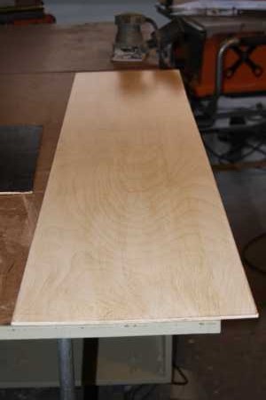

We did experiment with the interior finish. This is birch ply, with a coat of sanding sealer followed by two coats of pickling stain and two coats of satin polycrylic. I think it needs one more coat of polycrylic before it's done. I'm really impressed with how closely this matches the Airstream interior I posted previously. Thanks a bunch!! You guys really helped me get the look I was going for.

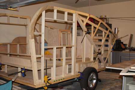

Postby wlivesey » Wed Jul 01, 2009 9:17 pm
We got the hatch sides framed out this evening. This turned out to be a pretty easy to do. We used the plywood template to layout the pieces and get all of our angles right. After both sides of the hatch were framed, we clamped them together and used the belt sander to get them to match perfectly.
It's starting to look like a trailer!

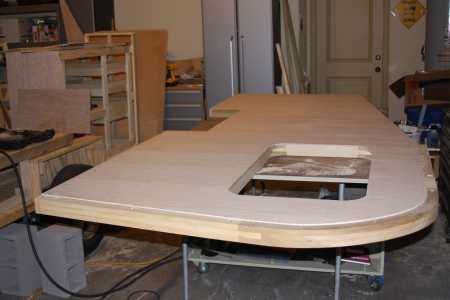

July 4th Progress

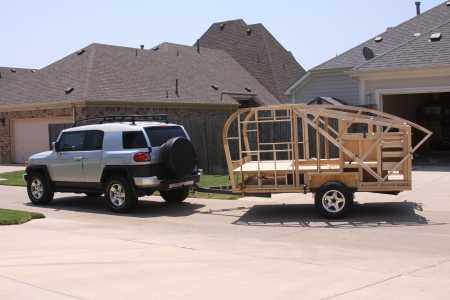

Postby wlivesey » Sat Jul 04, 2009 9:20 pm
I couldn't resist the opportunity to hook the Northwestern up behind my FJ. I think it looks pretty good.

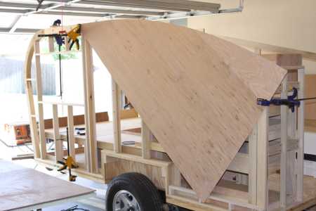

We got one interior wall skinned today. We seriously considered Birch or Ash but ultimately decided to go with Oak.

Postby wlivesey » Mon Jul 06, 2009 10:28 pm
Its been a long day... Thankfully, a "cold" front came through last night and made for really comfortable conditions in the garage.

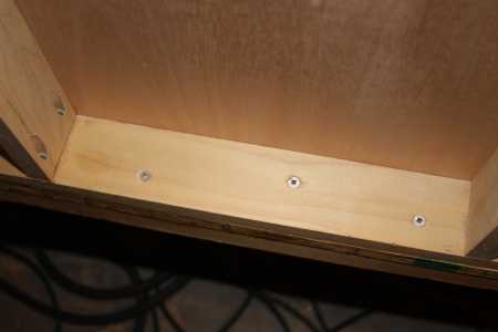

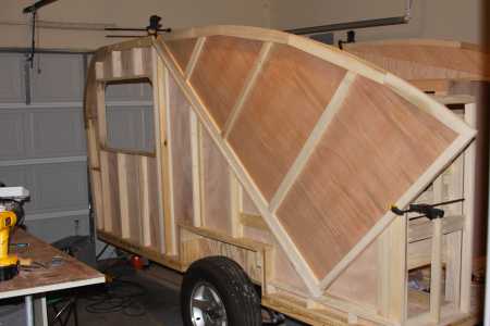

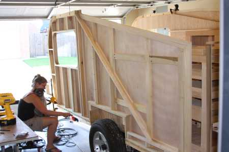

Both walls are now skinned and permanently attached to the floor. I cannot believe how strong this trailer is. I knew it would be strong, but once we attached the sides to the floor with [countless] stainless steel screws, the strength of the walls, and trailer in general, became much more apparent. I can't even begin to explain how strong it is!
2.25 inch Stainless Steel screws.
The interior hatch sides are skinned...

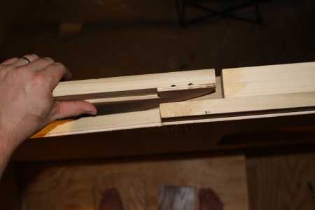

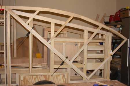

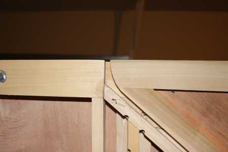

For those who are interested in a Winter Warrior style hatch, here is what I have done. This is a big topic of research for me before I started my build.
The front most end of the hatch side extends about 3 inches in front of the hinge point. I've made this end rounded, with about a 3 inch radius, so when the hatch opens, the leading edge just pivots in place without opening up any unnecessary gaps. This will give me more room for weather strips on the leading end of the hatch. The angular part, just in front of the hatch, will be made to match the radius soon.
Here is a top view of the hinge point. You can see that I've left a gap between the hatch on the side wall. I'll put a nice thick weather strip in here. The gap looks bigger than it will be. I've still got exterior skin that needs to go in there as well. There should be a .25 inch gap for a weather strip when I'm done.
