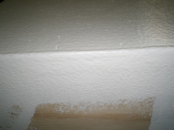

Anyway I just went down to the shop and checked out the drying progress. What I found was that the paint on the A C plywood was already dry however the paint on the luan was still a little tacky. Luan seems to suck up more paint. In hindsight I should have putdown a primer on this wood. I didn't because the company didn't think it was necessary. To aid in drying I have left the heat on low down in the shop overnight. Should keep it at least 50 F throughout the night.

Update on the RC 2000. Overnight, with heat in the shop, the first coat dried. I just finished applying the second coat and it covered really well. I have enough left in the can to put another coat on the flat part of the roof and all the edges. I am feeling a lot more positive about this stuff today. And boy was the price right, ($51.00/gal). BTW I was reading more of their propaganda and I found a positive reference for using it on plywood.

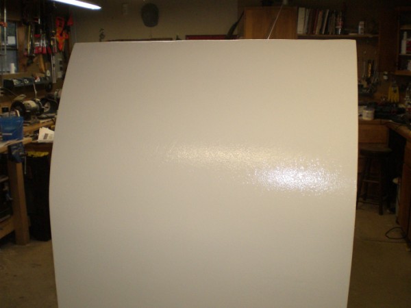

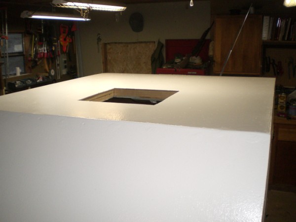

Postby fishfinder » Sat Jan 09, 2010 5:21 pm
Here is an update report. I applied two coats of the RC2000 to the front, top and galley hatch. And this morning I had enough to put a little more on top. Didn't want to waste a drop. ;) Today I went to the paint store to pick up some paint for the sides.
This is what I got.
They tried to match it to my car but I can say it is only close eventhough they made several adjustment to the color. It is essentially a light tan.
I have added a few more pictures to show my progress. I put on the first coat of the ArmorSeal but it so light it didn't show up well. I will take a picture after I put on the second coat.
2nd coat of RC 2000 on front and roof.
RC 2000 along the edge

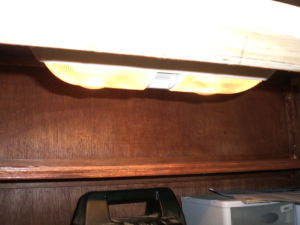

Cabin doors and lighting
Galley lighting

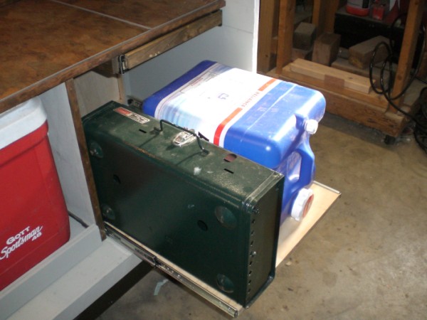

Roll out shelf in galley

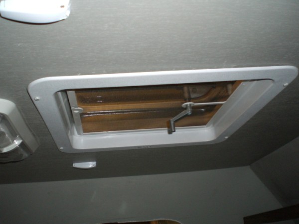

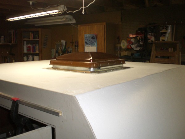

The roof vent is now installed.

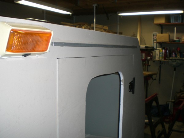

The cabin door is complete and hung (minus the window). I have a double lock system to guard against "easy" theft. I have the windows but have yet to figure out the inside molding.
Finally I figured out a usable drip channel. I went to ACE hardware and picked a piece of U channel, cut it to length and attached it to the wall with epoxy.

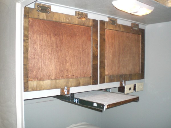

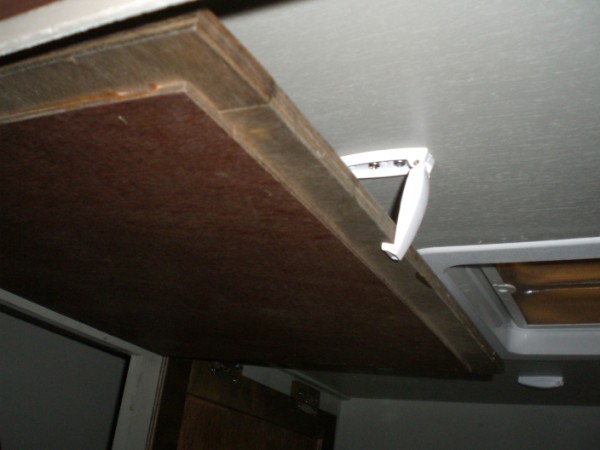

What are the two white things on either side of the vent are those flip down reading lights?

Burke. thanks for the kind coments. The two little white gizzmos in the ceiling are clips for holding the cabinet doors up. You pull down on the latch and it has a catch to hold the door open. I'll try and remember to take a picture of them in action. :)

Postby fishfinder » Thu Jan 14, 2010 7:45 pm
More progress today. Still have a few problems to work out.
This is for Burke. Here is the gizzmo in use.

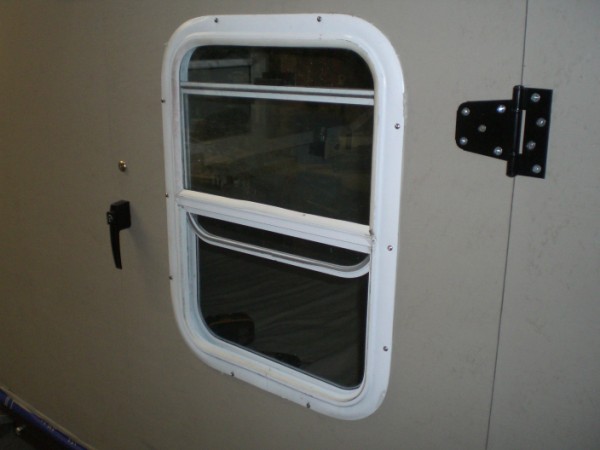

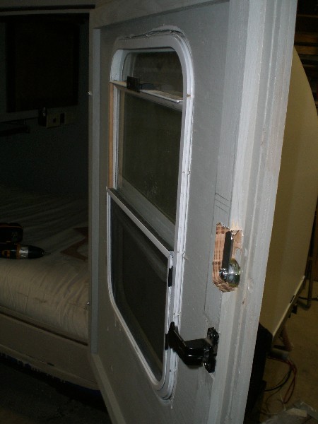

I installed the windows today. I am stuck on the inside trim. Maybe someone on this site can offer some solutions.

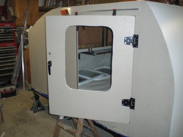

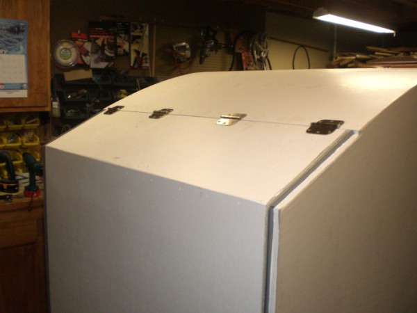

Started to install the hatch today. First picture is with the hinges. They will be covered with rubber. More pictures to follow on how that is done.

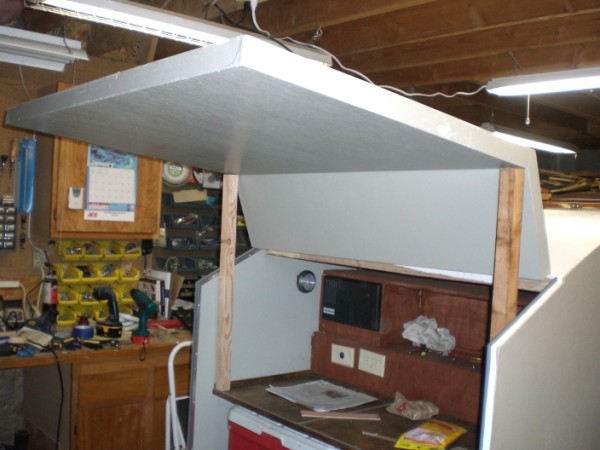

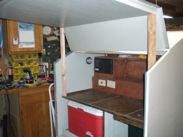

Wow it opens. I got to do something about those supports. :D

Just a note on the windows. They came out of another RV and are actually supposed to be installed rotated 90 deg. I drilled drain holes along the bottom edges. Also you will notice the little brown rod that I use to keep the window raised.
Good luck on your build.

Postby Miriam C. » Fri Jan 15, 2010 10:47 am
:o Mike you might be able to extend the trim by cutting it and putting in an extra piece in. Second solution is to get a wide trim to replace it.
Third solution is to make a wood frame for the opening and then put the trim on.
Postby fishfinder » Fri Jan 15, 2010 9:35 pm

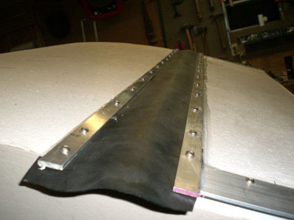

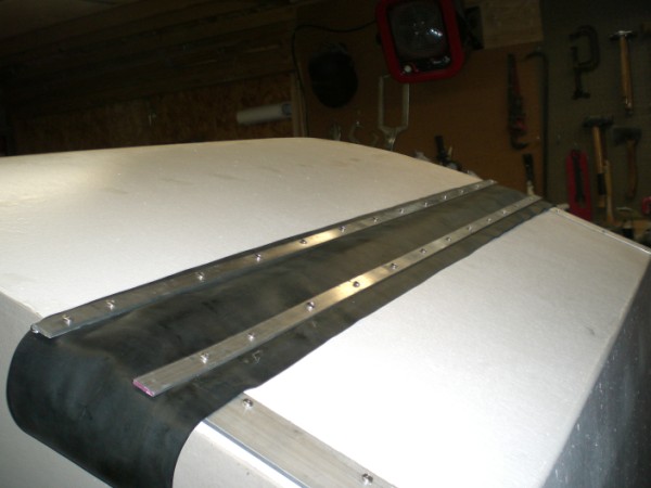

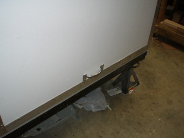

Thanks Mariam. If only this window had square corners all would be easy. I have tried a couple times to cut a curved corner but it failed miserably. My pattern maker neighbor has been laid up but when he gets over his cold I'm hoping he will come and give me a hand. Meanwhile I plugged away at finishing the hatch today. Following are some pictures of my progress.

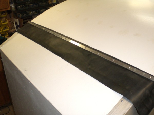

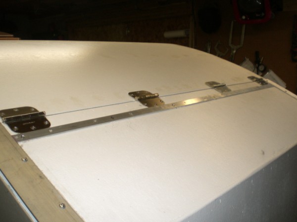

I began by fastening a 3/4 inch strip of auminum below the hinges.
Rubber roofing strip is placed over the hinges and attached with a aluminum strip.
Another alluminum strip is attached over the rubber below the hinge. The screws go through bothe the upper and lower aluminum strips.
Rubber is trimed and silicone applied along the edges.
Finally a D handle is attached to help opening the hatch.

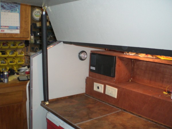

Finally I really need to find a solution for my hatch supports.
I can almost say "mission accomplished." Still have to finish those pesky details of the hatch supports and window trim. I'm finally ready to install the running gear, axle, wheels and tongue. I'm going to take a few days off to let my brain cool off. I'll report when she is finished, if ones TD is ever finished.

Is this site great or what. I went on a search for some ideas on solving my strut problem. Thanks to Tom Swenson I found exactly the right solution. I shameously followed his design and it is perfect for my build.
Thanks Tom I hope you don't mind.
New strut.
