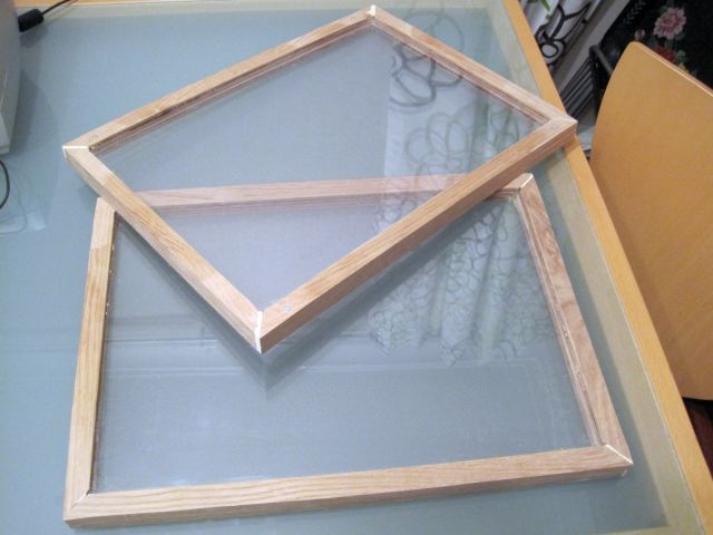

Ok since we last talked, I have built the double glazed windows from White Oak for the framing and Lexan for the glazing. The double glazed units come apart for cleaning and condensation removal. Think of single glazing with a screwed on storm window.
The miters are terrible, don't look too closely at all the wood filler...

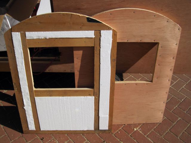

Yesterday I half built the doors and the door jams. The doors are a similar sandwich to the walls. i.e framing, foam and an outer ply on each face.
Those nasty screws will be covered by the interior lining, whatever it may be.
I needed so many screws because my framing is 20mm and my foam is 25mm. I thought it would be easy to compress the foam a little, but it needs lots of fastenings. :( Next time, if there is one, I will use framing that matches the foam.

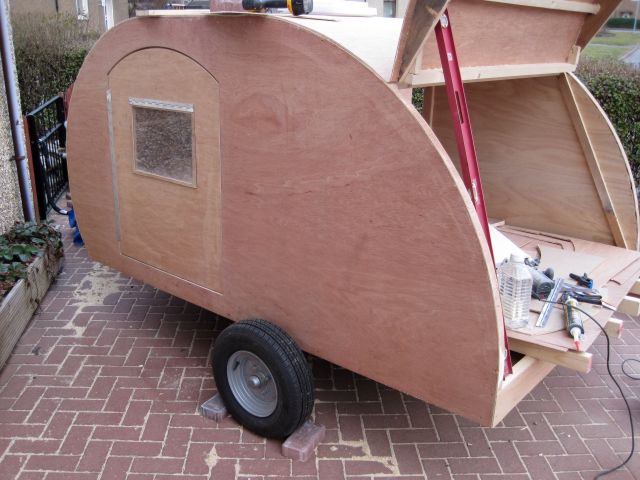

Finally the doors are on and the windows fitted. The Lexan really attracts a static charge, then sawdust sticks to it. Hmm! Was this a bad choice of materials?
I have no hardware for the doors or the windows yet. What a lot of work to make your own doors and windows. A full weekend of work in fact.
That is almost all the exterior woodworking complete. I still need to build the battery box and then I will give all the woodwork something to protect it from the rain.
I have earned myself a single malt, methinks! Now should I have the 16 year old Auchentoshan or the 10 year old Talisker?

On the door / insulation situation, Would it be worth running a hot wire flush with your framing to reduce the tickness of the insulation, and stop the buldging ? It may bug you forever if the're not as good as the rest of the build.... If you think you can hide it ..fair enough.. but it would be a shame to spoil it when theres an easy fix ..... You know what i meen ?
Cheers Dave
jackdaw
Posts: 598
Images: 124
Joined: Fri Feb 22, 2008 2:31 pm
Location: Wltshire, UK
Postby BigAl » Mon Mar 15, 2010 3:01 am
Hi Dave, You are absolutely correct. It will bug me every time that I look at it. I'm going to unscrew that panel and if I can find the Ni-Chrome wire that I have somewhere I will trim it down with that or else I will put the belt sander on the foam. White eyebrows, here I come!
