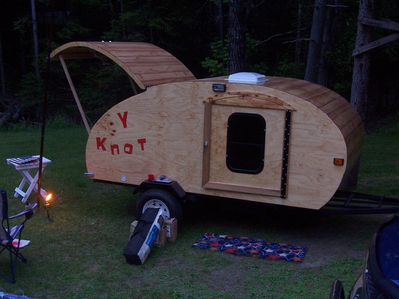

Put a name on the side!

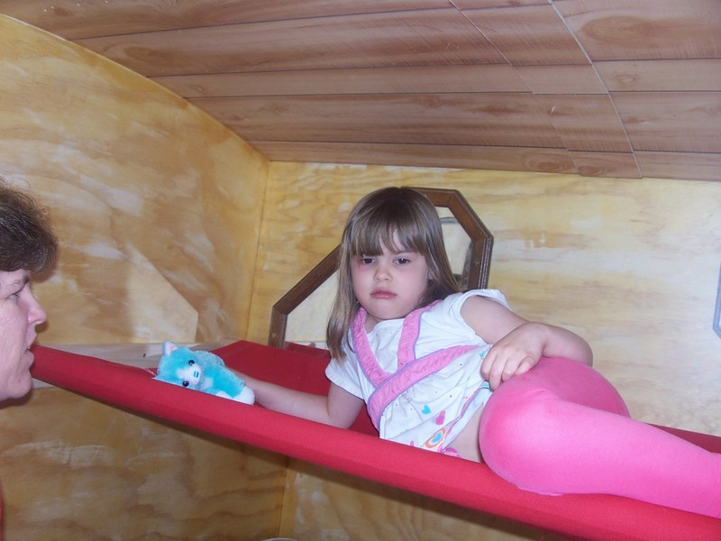

Finished the hammock and our daughter was trying it out!

Put the "Y Knot" up on ramps to check the frame / welds / bolts. All was well after dragging it around for a few days.
Built a small hanger that will hold a DVD player or my smaller laptop.
Built a shelf for my daughter.
Pulled my Ham radio out of the truck to hand carry with us this weekend over to the teardrop get together in NY.
Very close to being ready for the trip this weekend!

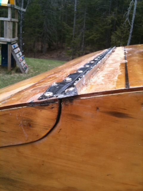

While the decision to use the flexible plastic hinge for the galley and doors remains a good choice, I did find that my galley had leaked a little. I suppose any hinge might have trouble in that situation where the hinge has to butt up against the roof. I used some liquid nails type stuff in there and it did not do the trick. I pulled the galley lid, cleaned it, and used silicone and after driving through some really hard rain, it has proven to be holding water tight.

I agree and during this last trip, our 7 year old said she did not fit in the hammock any more (I think she was tired of hitting her head), so she moved down to the queen bed...........Now I am really glad I went with the queen bed.
So now I can start designing a cabinet to do into that space. I'll likely leave the hammock poles there and build a "slide in" cabinet held in with just a few screws. Makes it removable if I ever need to do that or removable to make changes easy..........

I went hoping to assist other builds or mods and rain Friday night left me with a drip on my foot! Good weather and friends allowed me to pull the old hinge and work in a repair that I am confident will not leak again. The haze look is new resin put down over the old silicon removal "damage".

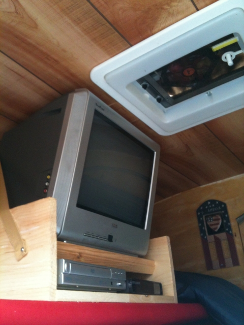

I also had been thinking about mounting a TV, shelf, cabinet in the hammock area. I started small and I feel that I will leave it that way. The more I close it in, the less space is left in the interior. Right now the interior space has an open and large feeling. Cabinet doors would cut down that open feeling. I'll likely put in a shelf on each side and leave it like that.

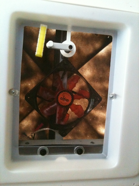

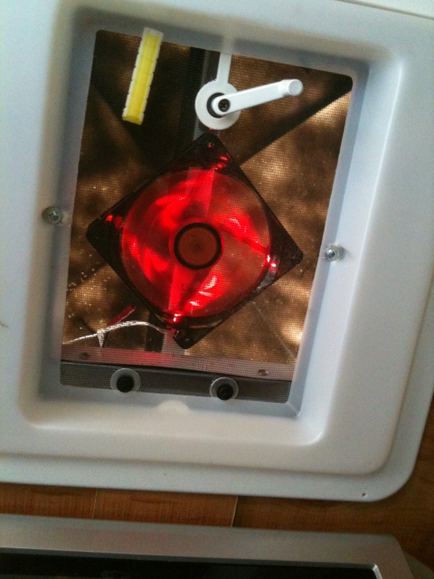

Finally I pulled the noisy fan and replace it with a quiet PC case fan.
