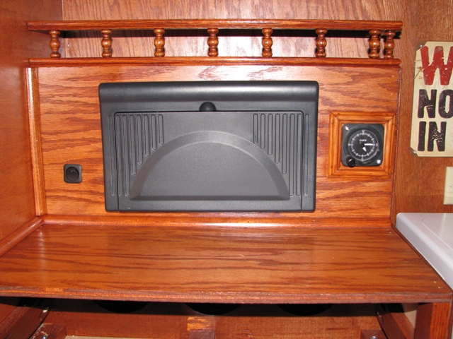

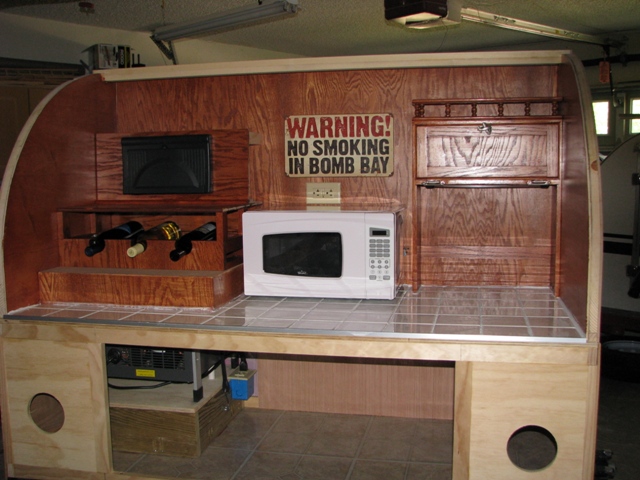

LDK wrote:Hey Earl
I like the way you're doing your pet cool. Is the ply above it going to be part of your counter top? On the bungalette the pet cool was on the outside wasn't it? Question,questions,questions! :lol: BTW excellent work.
Thanks Larry. I appreciate the words.
Yes, the raised section will be part of the counter top, plan to have a small cabinet there, my power distribution center (WFCO) and maybe a storage feature for something special! 8)
The Bungalette did have the Pet Cool on the outside with ductwork to bring in the cool air. That is one thing I wanted to avoid this time, wanted it built in to the trailer. I am pretty happy with the way the Pet Cool install turned out.
Earl & Kerry
"Loader"

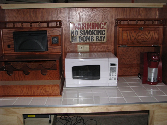

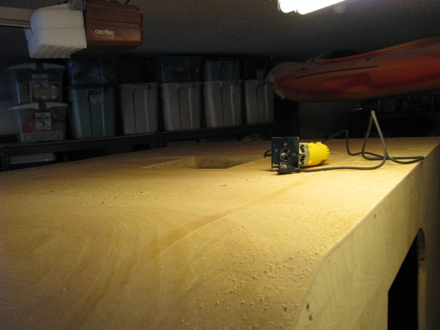

Postby Loader » Fri Jun 24, 2011 6:53 am

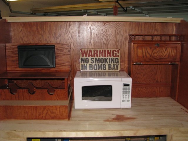

Been a while since I posted any photos, and to be honest, only have the one to share right now.
I have been working on the galley. Next step is to close in the top and side by the power center, then start to put the tile counter top in and install trim.

Postby starleen2 » Fri Jun 24, 2011 7:21 am
Absolutely love it - nice wine rack too :thumbsup:

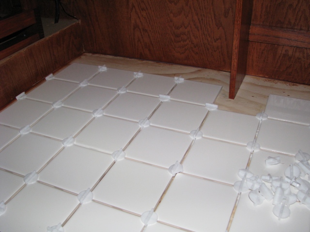

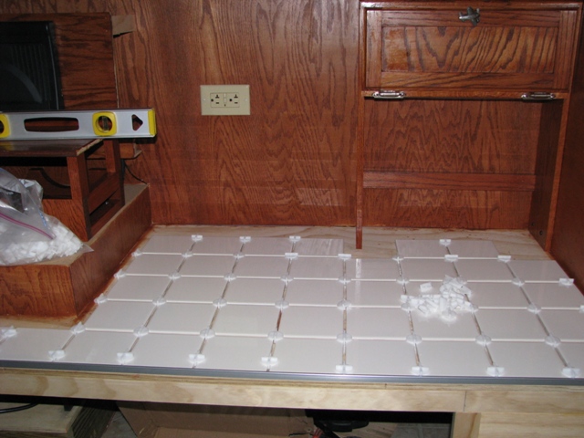

Postby Loader » Sun Jun 26, 2011 5:39 pm

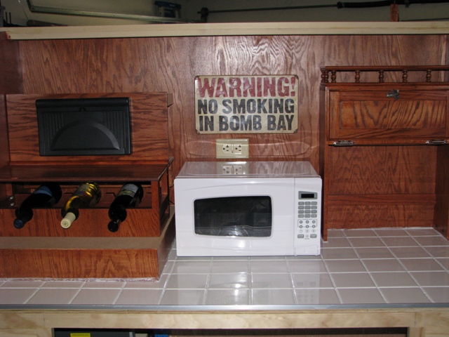

Despite the crazy heat, I completed the tile install and mounted a sign in the galley. Next step, trim out the galley and finish power center cabinet.
A few pics

Could you say what type of thin set or mastic you used to set the tiles, please? Also, did you use epoxy or "regular"'grout?

Postby Loader » Mon Jun 27, 2011 11:03 am
I appreciate all the kind words guys!
Larry, it would be nice if the petcool chilled the wine! Although, it may heat up more than cool down! I still need to find a nice vent cover for teh side of the trailer.
Tom, I used a heavy duty construction adhesive (PL) which stated it was good for stone and wood. Guess I'll find out how well it does after traveling down the road some. A far as the "grout" I used sanded caulk . Was hoping for the grout type look, but with some flexability.

Postby aggie79 » Mon Jun 27, 2011 11:17 am
Loader wrote:Tom, I used a heavy duty construction adhesive (PL) which stated it was good for stone and wood. Guess I'll find out how well it does after traveling down the road some. A far as the "grout" I used sanded caulk . Was hoping for the grout type look, but with some flexability.
Thank you Earl. I am tiling my countertop too and was curious how you did it. I believe Mark (Planovet) did the same.

Postby Loader » Sun Jul 17, 2011 5:38 pm
Despite the crazy heat here in Texas, I did accomplish a little this weekend.

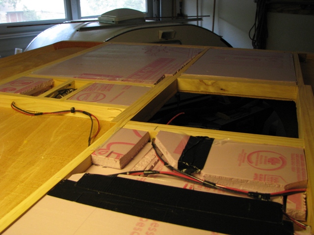

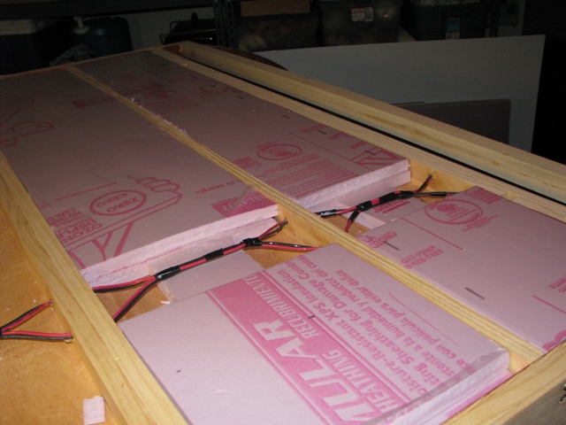

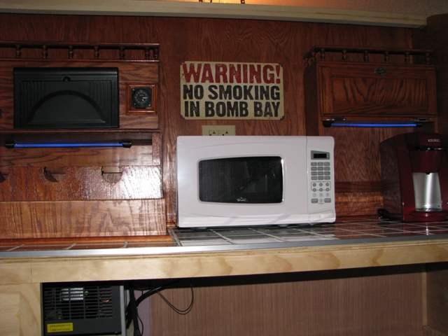

Finished up the galley, the power center, wiring and started installing the insulation.

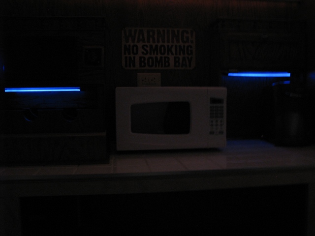

Completed Galley
Power Center

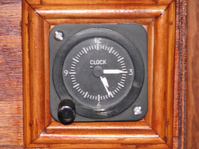

Aircraft Clock
Galley Night Lights
Galley Night Lights
Wiring Installed (taped and caulked in holes) Insulation Started

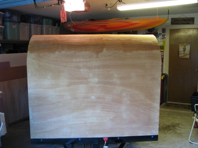

Postby Loader » Sat Aug 06, 2011 7:59 pm
Not too much to report, although the roof is completely installed.
All insulation is in and I used the spray foam where needed (sorry no picture of that). Put a little caulking where the wires ran through the spars.
I installed the outer wood skin, filled the holes, fiber glassed the seam, then sanded and applied the sealant.
Getting closer to installing the aluminum skin!
Before filling and sanding
Sealant applied (fiber glassed seam in the front)
