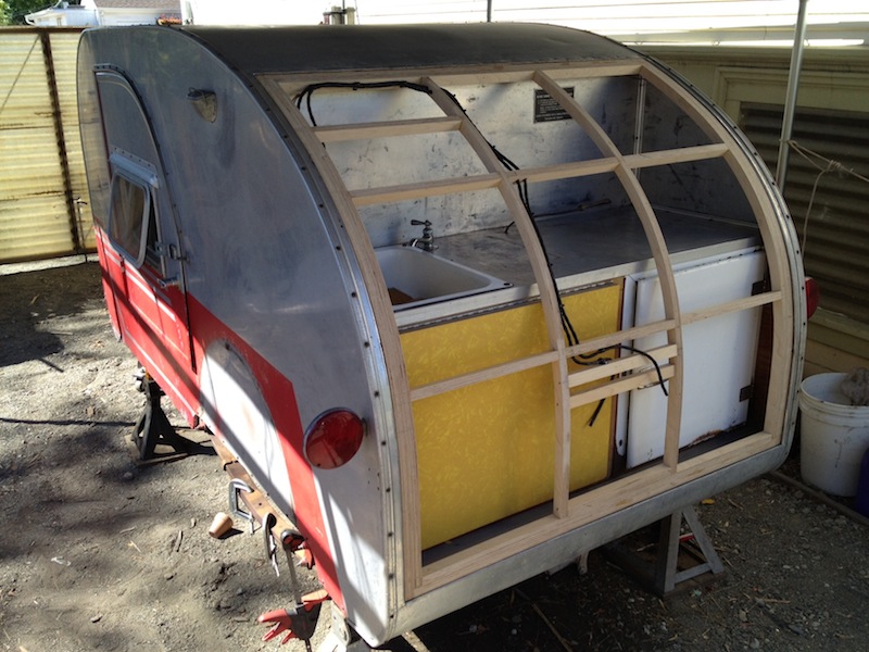

Postby stevegsmith » Tue Sep 04, 2012 11:17 am
Ted,
Got the hatch framing done and the outer layer skin on last night.
Hope all had a nice weekend.
Here's a pre-skin pic.
Steve

Postby TRP » Tue Sep 04, 2012 11:34 am
Hey Steve,
That looks great. Nice progress. The hatch looks fantastic. What did you ever decide to do with the spindle/hub issues you were having. Did you order up a new axle and such?
Ted
