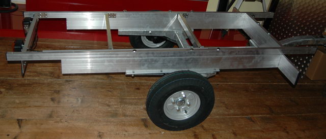

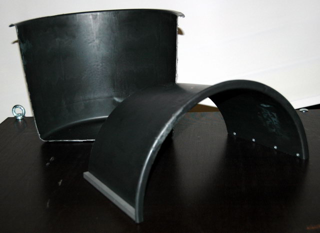

ST1100 wrote:Okay - working week is over - time to go on.
Made only a KISS fender today - total cost for two 1.79 Euro (cement bucket) only to get the prototype through the technical inspection.
Tomorrow the second one will follow and I will see how to fix them without drilling into my frame.

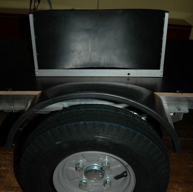

Next step - finished "fenders" and found a way to fix them simple with only one screw per fender.

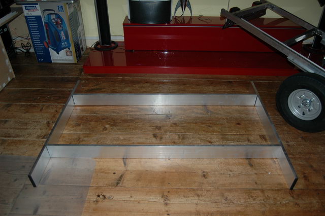

So I begin bringing the deck 4 inches higher.
Got two aluminum profiles 3/4 x 4 inches and 8 ft long to build a box and locate it between frame and deck.
So later a new 24 inches wide and 48 inches long deck could cover the wheels.
(UPDATE 22nd Feb.: I think I made a mistake in the conversion from cm to inches - my deck will have 100 x 200 cm - so it will be 39 x 78 inches.)
Remember - 100 cm is our width limit for trailers behind bikes.

I will use the weekend to lift the deck of my basic utility trailer over the wheels.
I cut the alu bars which will fill the space between my axle and deck frame.
Two 140 cm long, this is the width of my planned slideout and the length of my unbent side walls.
Two 99 cm long to meet the 100 cm width limit including the 4 mm nylon caps.
I will joint them with alu angles and rivets.

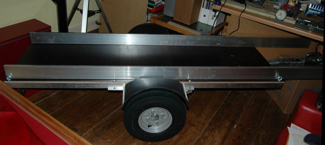

But I set my first deck support bar one inch nearer to the front and drilled three of my bars to lift my frame up.

Okay - after coming back from skiing with my daughter today I fixed all and bolted deck, frame and axle together again.
On Friday I got a date with the officials - need only a weight certificate in advance.
The deck is 2 ft wide and 6 1/2 ft long. The complete trailer is 8 ft 5 in long.
