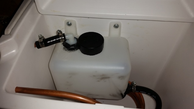

Did someone say "Home-Made Swamp Cooler"? :twisted: I've been pondering this for a while. Looking forward to seeing it in action especially during this summer down in the Keys! The pump and the fan take up less than 3 amps with the fan at full speed and less than 1 amp at slow speed. I've been keeping everything 12volts and only using shore power when available to charge the batteries. I'm also looking for a solar charging system for some true boondocking.

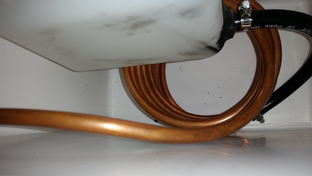

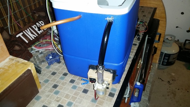

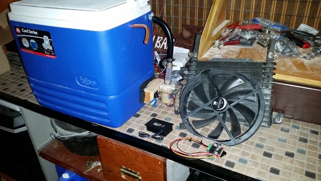

Postby noseoil » Thu Apr 23, 2015 8:18 am
Wondering how much ice you will need for over night? It should work pretty well, but you will be eating up the ice pretty fast with the heat exchange.

Postby spbiknut » Thu Apr 23, 2015 9:47 pm
low-n-slow wrote:Troy,
I am liking your build and have a lot of the same ideas for my build that you have put into yours. I really like the idea of the cooler. My only thought would be how the humidity in FL will affect the effectiveness of your swamp cooler. :thinking:
On the other hand, here is a link to a solar panel that I know works really well for vehicle batteries:
http://www.amazon.com/Battery-Tender-02 ... olar+panel
I am the vehicle control guy where I work and have several of these for our work vehicles. They all work really well, just a little too big to leave on the dash though. I am thinking of getting one and somehow "frenching" them into the back hatch.
Looks great though, and should make for a great beach camper. :beer:
Jason
Jason, thanks for the link to the solar battery maintainer. Looks good! I've been pondering the humidity issue. I'm thinking if I keep it vented it should be much of problem, but we'll see...I'll report back after the first trip down to the Keys. :D
-Troy
rebapuck wrote:Put the bottle opener outside, next to the galley.
Yup...I think you're on to something there...it sounds like a good spot for it!
-Troy
noseoil wrote:Wondering how much ice you will need for over night? It should work pretty well, but you will be eating up the ice pretty fast with the heat exchange.
Yeah...you've got a good point there. I've tested this cooler and it holds 10lbs of ice for two days with nothing running through the system and the water stayed "cool" for five days...that's with the cooler sitting in a hot garage. I'm going to use anti-freeze as the fluid in the system so the heat exchange through the cooler shouldn't affect it as much as plain water. I'll post the results.

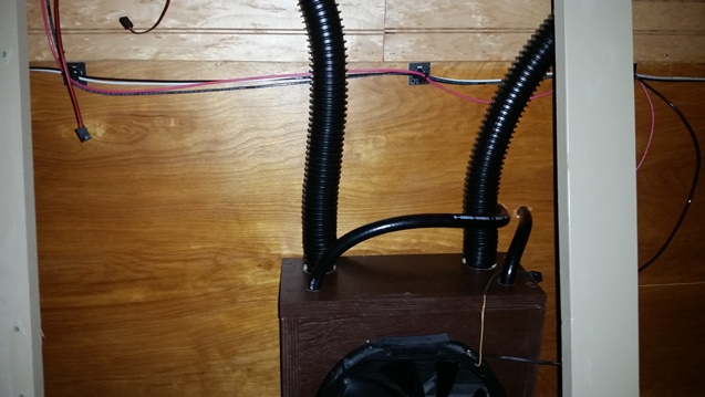

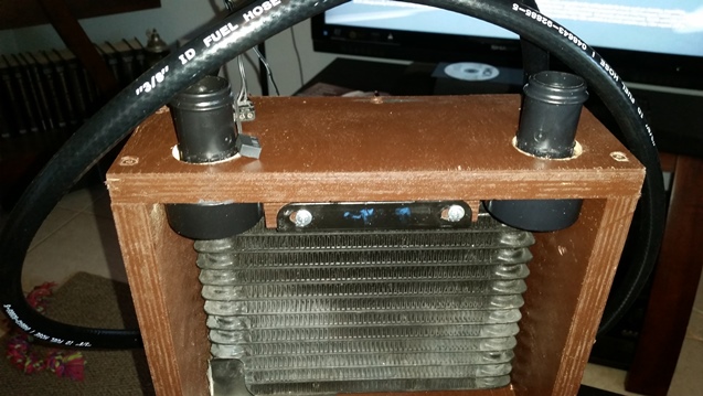

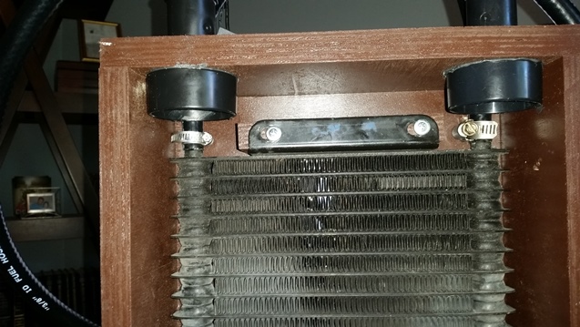

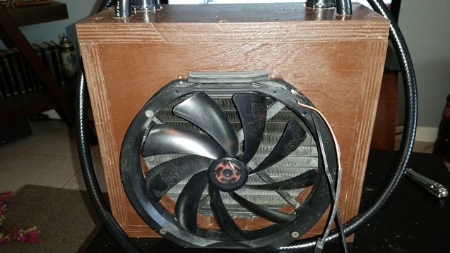

Postby spbiknut » Sat May 16, 2015 2:59 pm

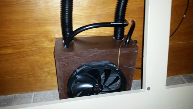

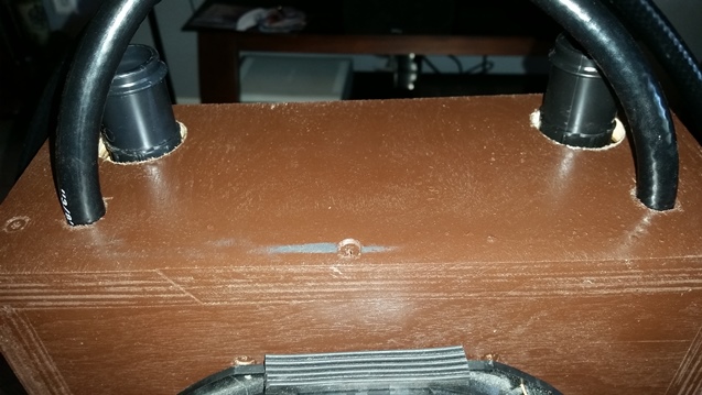

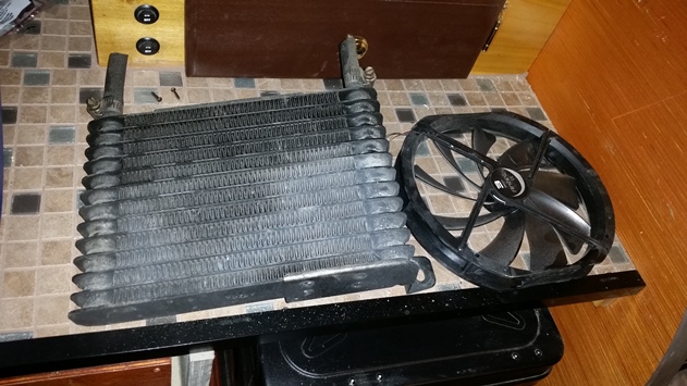

So here is my "cold box" with my repurposed trans cooler, large 12v fan and shop vac fittings for the air ducts. Installing it today and going to test the system tomorrow. I'll let you guys know how it turns out. I'm thinking that I'll need a condensation drain, but that's easy enough to add later.
"Tryin' to reason with hurricane season"
http://www.tnttt.com/viewtopic.php?f=50&t=54668
spbiknut
Posts: 75
Images: 140
Joined: Thu Feb 21, 2013 4:13 pm
Location: St. Petersburg, FL.

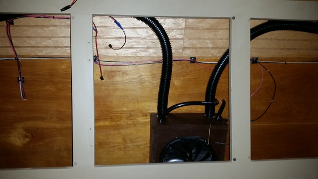

Re: Troy's Tiki Hut
Postby spbiknut » Sat May 16, 2015 6:14 pm

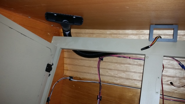

Here it is installed.
spbiknut
Posts: 75
Images: 140
Re: Troy's Tiki Hut
Postby low-n-slow » Mon May 18, 2015 1:49 pm
That cooler looks really neat. I'm curious to see how it works, I might have to try and use that idea since most of my camping will be in the desert. Just curious though as to the air flow from the fan in such a confined space.
