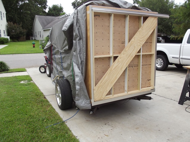

Wow, 8 weeks have slipped by and the tear has been sitting under a tarp in the back yard. Well, this week, against my own better judgement and the weatherman's too, I pulled it out to try to make some progress on completing it. Great thing is, the interior and kitchen galley are done (except for the painting). I managed to get the new rear hatch built and fit into the opening. I also got my TV mount built in the cabin, I opted for the Coby 16" TV combo. The outer plywood skin is on, the metal has all been cut and this weekend, I'm going to start installing the metal and trim. The doors were all test fit last night and they fit great.
Here's the hatch, with the aluminum sides in place and the hurricane hinge layed in place to make sure my clearances were good. PERFECT fit!

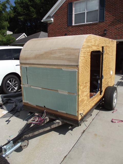

THe last of the insulation in place and the final piece of skin ready to go on. Note the wires coming through the skin, those are my running lights, back hatch lights, and battery feed and ground from the converter in the galley. A battery box is being preped for paint now (Harbor Freight tools, the heavy one) I wet sanded it and it's getting painted Kobalt blue to match the fenders.
The last of the plywood is on. i didnt glue the top skin, I just used a lot of 1 1/4" staples to apply. In the event I ever need to peel the skin off to work an electrical issue (Lord, I pray that doesnt happen), I wont be fighting glue too. Skins age ready to go on... I'm keeping it a mil finished aluminum and shooting clear laquer over it to prevent discoloration and oxidation. I'll try to keep posting as the weekend goes on...

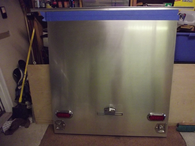

Thanks Carl, I took a trip yesterday afternoon to a friends vintage car and motorcycle restoration shop to see what he uses. WHen I told him what I was doing, he made a funny face and said "you mean, like one of those Airstreams?" Of course... He showed me what he uses to clear coat gas laterns and CNC'd & polished Harley parts... It's called POR 15 Glisten PC clearcoat. It's expensive, it runs about $65 a quart but he asures me it's the best product on the market for clearing over naked metal. So, I ordered some last night off Amazon, along with the recommended cleaner/prep (total was about $85) I'll keep everyone updated on how it turns out. :worship:
On a lighter note, with all the rain yesterday and last night, I was forced to work inthe garage and I finished my rear hatch, metal is cut, wiring is in, and it's done except for some final touch up... pictures coing this weekend.

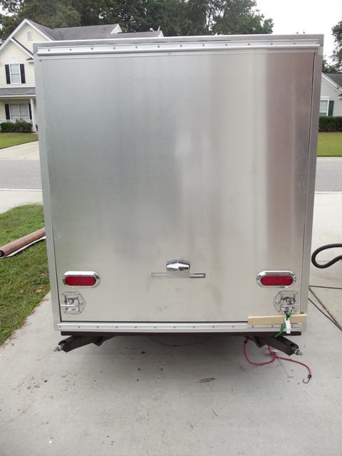

Postby 91kuhndog » Sat Sep 14, 2013 5:28 am
Your right Rebapuck, this rain is driving me nuts. Last night, I came home early to get the aluminum skin perm. attached to the roof and it rained all evening. So I took the liberties of finishing the rear hatch door. All the wiring for the speakers, interior lighting and rear lights tested good good so now I can push on with the installation of the rear door and roof skin today

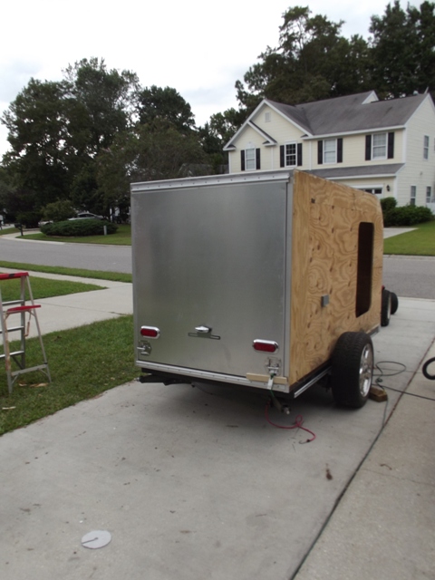

Postby 91kuhndog » Sat Sep 14, 2013 2:48 pm
I used the same latches you use, I think. I picked these up from etrailer's site. I routed out the faces and sides to ensure a good fit and they turned out pretty good. I'm on the computer this afternoon because after about 2 hours of work today, the rains came. For anyone in the southeast this year, you know what that means.. we've had the wetest summer on record, something like 19" over our average rainfall.
today, I was able to get the lower trays installed to rest the side skins in. Now I can finish cutting the side silloette's cut. I have lost a ton of time with the weather... you'd think I'd learn a lesson and clean the garage out. :?

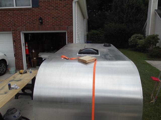

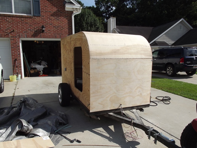

Postby 91kuhndog » Sun Sep 29, 2013 9:07 am

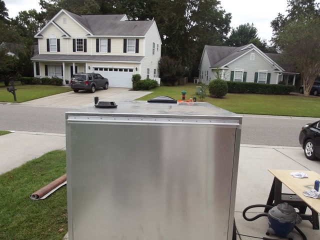

FInally! A nice day, without 100* temps and 90% humidity. I took full advantage on Saturday of the weather and a rare day off. Working 12 days on/2 days off is not condusive to finishing any of my projects, let alone this one. I managed to get the roof panel all trimmed out and installed, coupled with all the roof vents and fans. The rear hatch was hung and fit like a glove! I still have to install all the t-moldings on the hatch and install the door seals!
Now... to get the side walls on, doors installed and interior trimmed out. I'm smellin camp fire smoke! :twisted:
