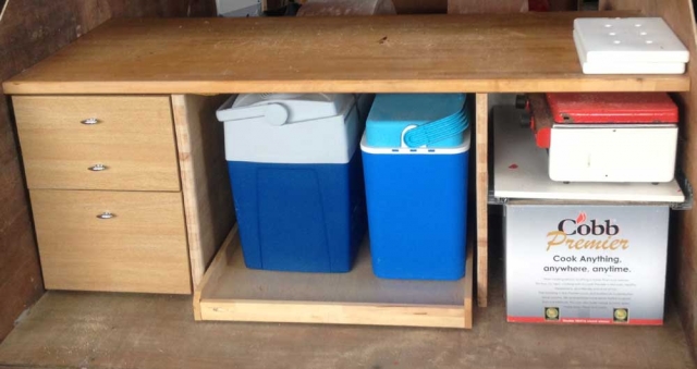

These drawers are originally from an office under desk set of drawers. They were destined for the skip (dumpster) and all I wanted was the drawer runners.
On the right hand side of the galley I have a camp stove, with randomly determined by the board it sits on. The center of the galley has the cooler box drawer, again sized by the cooler boxes. The drawers fitted in the remaining gap and needed a 1/4" packer. Just luck.
The drawers and the metal runners were too long so I risked cutting them down. It worked. In the video I did not raise the blade so cut into the drawer bottom. I did it correctly for the first two drawers and messed it up when I did the video.
The first two drawers I glued and clamped with a ratchet strap and only thought about pinning it when I did the video.
The video does not show how lining up the drawer runners (sliders) can be incredibly frustrating. A tiny difference in height makes the drawers look awful with the gap between the drawers highlighting the problem. Making those gaps even is a challenge.
http://youtu.be/xctTpP-6Xr0
