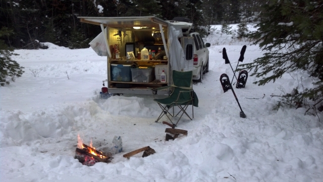

Did pretty good last weekend with the new insulation. The piece I cut at the last minute to go under me while sleeping was a good move. That foil facing felt like I was sleeping on a heating pad!! And I love my monster Gander Mountain, canvas outer, flannel lined, thick as can be, -20 rated sleeping bag. Need to figure out a new heat source. My buddy heater puts out too much heat.

Glad she's starting to perform in cold, foam under mattress is always a winner
Does buddy heater have a high low setting or just run?

Yes it has a variable low to high. It is just a gas valve. You fire it up on high and after the ceramic plate glows red you turn it down. On the lowest setting it sputters and makes some noise, makes me feel like it is not burning as cleanly as it should(probably fine). Even on low it puts out more heat than I need. I have to turn it on and off meanwhile my temp goes up and down. I want to figure out something else so it just stays an even comfortable temp.
