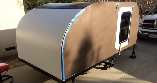

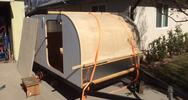

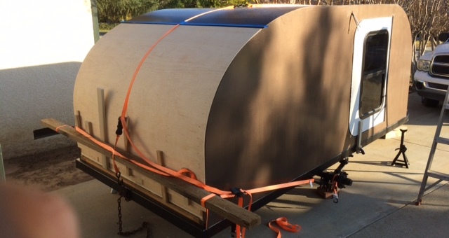

I was able to work on the td this long weekend. I it really looks like I am getting closer. I am trying to get it to a point of being water proof.
Here is the start of installing the roof (1/4" ply).
Front radius and rear radius at hatch done.
Roof done and staple holes filled with putty.
This was done on Thursday and Friday.

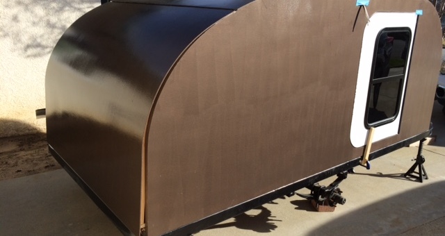

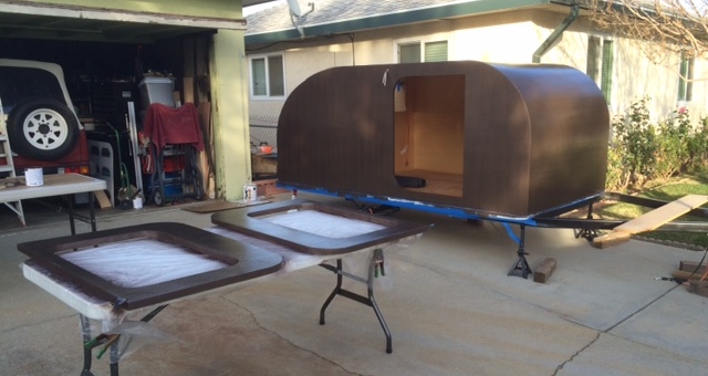

Saturday I primed and painted. I used Rustoleum Hammered Brown. It hides all the imperfections.

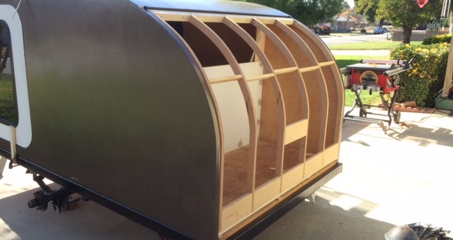

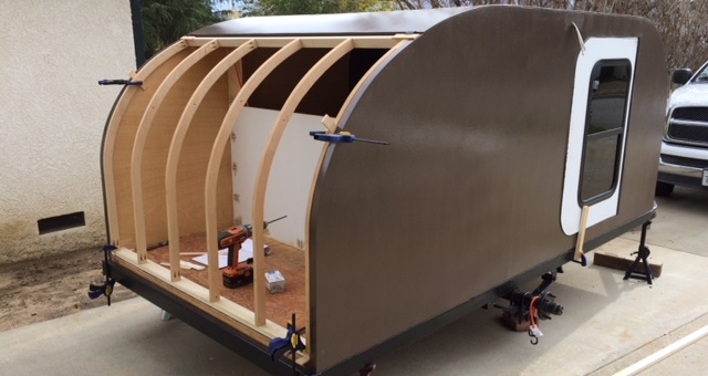

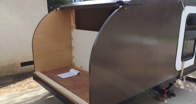

I got to work on the Hatch last weekend. Here are pictures of what was accomplished.
The beginning of the hatch build.
Hatch frame glued and screwed together.
Row of cross bracing done.
Benroy Style 5x10 Build - http://www.tnttt.com/viewtopic.php?f=50&t=57462

Postby jimun » Sat Dec 13, 2014 11:38 am

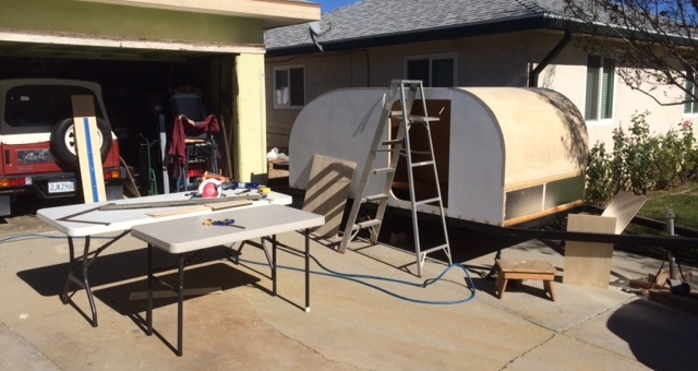

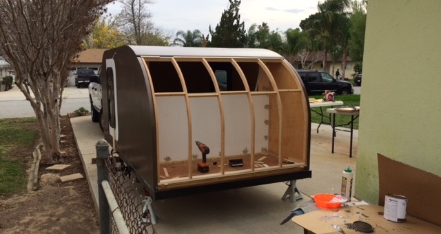

Hatch build continued.
Hatch hinge cut to fit.
Some bracing added to bottom of hatch frame. Also backing for license plate light and bracket.
1/4" Skin Glued and stapled

Postby jimun » Sat Dec 13, 2014 12:03 pm

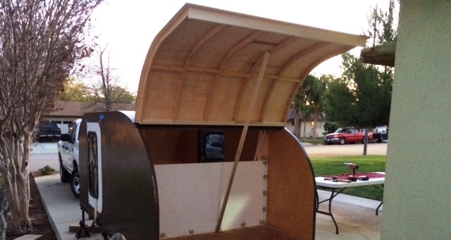

Continued
Hatch sanded and primed.
Hatch painted
Hatch open
Ok, got that all done last weekend before the rain storm that hit yesterday. Now I want to get the vent on and I need to get the aluminum trim and weather stripping for the hatch, doors and roof edge. I also need to get the door and hatch latches and then it should be weather proof for the winter and I can start on the inside. But I wont be able to do any more till after the 1st of the year. I have a lot going on for the holidays. Merry Christmas everybody.

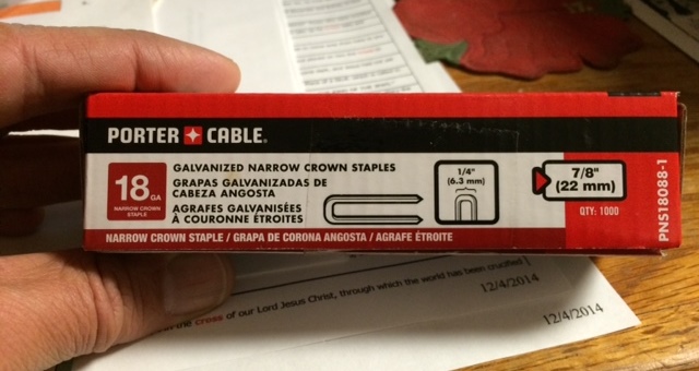

Can you post a pic of the staples and gun you used please.
Any reason a pass ode style fixing gun with brads wouldn't work?
Cheers dale
dales133
Posts: 4605
Re: Benroy style build 5x10
Postby backstrap bandit » Sun Dec 14, 2014 7:34 am
Dales you can try it but I'm thinking that brads have such a small head they will pull thru when you bend the ply around the radius there is a lot of tension or spring back to it. I really wouldn't suggest it
Postby dales133 » Sun Dec 14, 2014 7:58 am
backstrap bandit wrote:Dales you can try it but I'm thinking that brads have such a small head they will pull thru when you bend the ply around the radius there is a lot of tension or spring back to it. I really wouldn't suggest it
Hmm mm ok.
I do have some pretty heafty ones for putting weatherboards on I think might be the ticket.
dales133
Posts: 4605
Postby jimun » Sun Dec 14, 2014 8:26 pm
Hi Daless133, I agree with backstrap bandit. I have a set of pneumatic tools and I choose staples because of what I read on this site. I had a little trouble even with the staples blowing through the plywood sometimes. My air regulator was giving me problems. Also the difference in the resistance of shooting into softwood and hardwood struts would change the depth of the staples.

Like backstrap bandit said if you are bending 1/4" plywood like I did it really wants to spring back. I had to readjust my straps several times because of this spring back and it even pull the staples through the plywood a couple of times.
Here is the staples I used.
