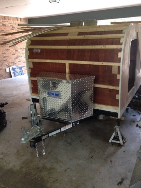

Tommy2tone_1999 wrote:I decided to just replace the boards since I was still at a beginning stage. I bought 2 4x8 sheets of cabinet grade plywood and had them cut at the store to 5'. Here I am applying 3 coats of CPES to seal them.
Tommy2tone_1999 wrote:3/4" Plywood is VERY stable, more so than a framed wall with a plywood skin. The disadvantage of solids walls is not the stability, but the weight. Solid walls weigh more than the framed sandwich walls, also they are less insulated than a framed wall with foam insulation. The plywood walls I am using are bolted to the trailer frame with carriage bolts, so the stability is rock solid. Thanks for the observation.
