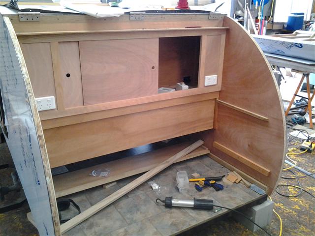

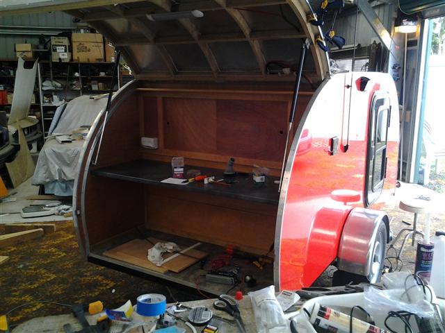

Day 70: 26 Sept 2012. 14 days left to finish it. :shock:
Getting there on the galley. The pantry is mostly completed, with the 230v electric in that area sorted. The bench is ready to go in, we ended up using a ready made formica piece from Bunnings (one of the main hardware chains). I still have not worked what I am doing under the bench, as I have been trying to fit in the portable gas bbq, complete with its folding stand, but that is stuffing up where everything else is supposed to go. I have also done a lot of weight saving on the bottom side of the bench top with the skill saw.

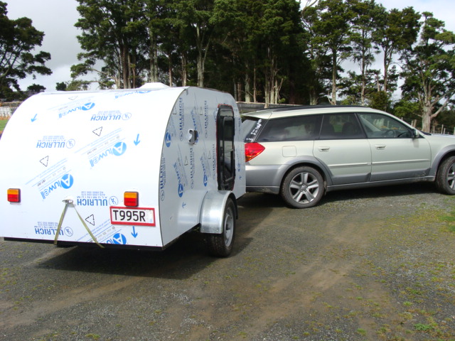

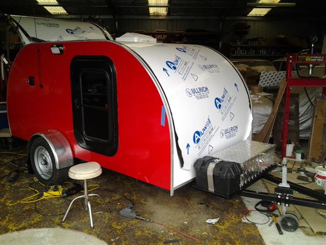

Day 73: 29 Sept. 2012.
11 Days before we leave. :frightened:
We pulled it out of the shed today for the first time. :P

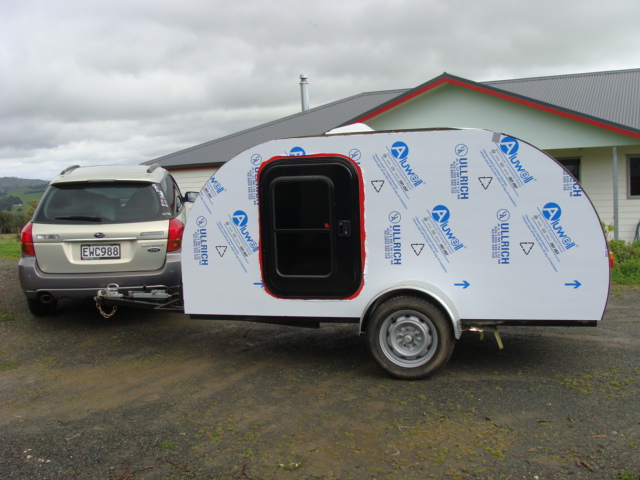

It had already been registered, and the number plate fitted. Today was also the first time on the road, as we took it in for a Warrant Of Fitness. Behind the Outback, we hardly knew it was there and It went through its WOF inspection with no problems. Now that it is road legal we can book it in for an Electrical WOF.

Sheddie wrote:Day 73: 29 Sept. 11 Days before we leave.
We pulled it out of the shed today for the first time. It had already been registered, and the number plate fitted. Today was also the first time on the road, as we took it in for a Warrant Of Fitness. Behind the Outback, we hardly knew it was there and It went through its WOF inspection with no problems. Now that it is road legal we can book it in for an Electrical WOF.
There are time I wish we had such things here in the States. Trailer inspections vary by state, with many states requiring no inspection whatsoever. At most, you'll get a cursory inspection of lights. You could build a camper out of matchsticks and saliva, and as long as the lights work, you'll get a "pass".
As for electrical inspection, there's simply no such thing.
I cringe at some of the things I see rolling down the road.

We were quite surprised how easy the registration and compliance process was, considering how strict they are with getting motor vehicles on the road. Fortunately we have one set of rules for the whole country, but then we are about the size of Colorado with a population of about 4.5 million. I called in to Vehicle Testing NZ to see what was needed. Registration was just fill in the form, pay the money and we had a number plate. WOF can be done by any garage with WOF authority. They check the basic frame condition, suspension, tyres bearings etc. and make sure all the lights are in the correct place and working. After that you pay an annual registration fee and have a WOF inspection once a year. The electrical WOF is for the 230v system. We are required to have all the correct circuit breakers, RCBOs power cables etc. This is valid for 48 months, and you can not plug in at a camp ground without one.

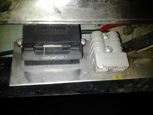

One drama we had was when we took the TD down to the local caravan/motorhome dealer, where they had arranged for it to have its electrical Warrant Of Fitness issued (for the 230v system). The inspector didn't like the power outlets we had in the galley, he considered it to be a wet area, and wanted them replaced with outdoor outlets. The big problem was that the inspector was going on holiday the next day and would be away two weeks. After a lot of begging he arranged for someone in his office to issue the Wof when the outlets were changed. Without the Wof we would not be able to plug in at the camp grounds.
I have fitted a C-tech battery charger for charging the battery when camped, and run wiring from the car for charging on the road. For the car I used 85amp 8gauge wire with an auto reset circuit breaker and a relay to shut off the supply when the engine is switched off and an Anderson connector at the hitch. The car now has an alternator instead of the old generator to up the charge rate.
The black connector on the left is a flat seven pin for the trailer lights. The grey one on the right is the Anderson connector for heavier power loads for the battery charging.
