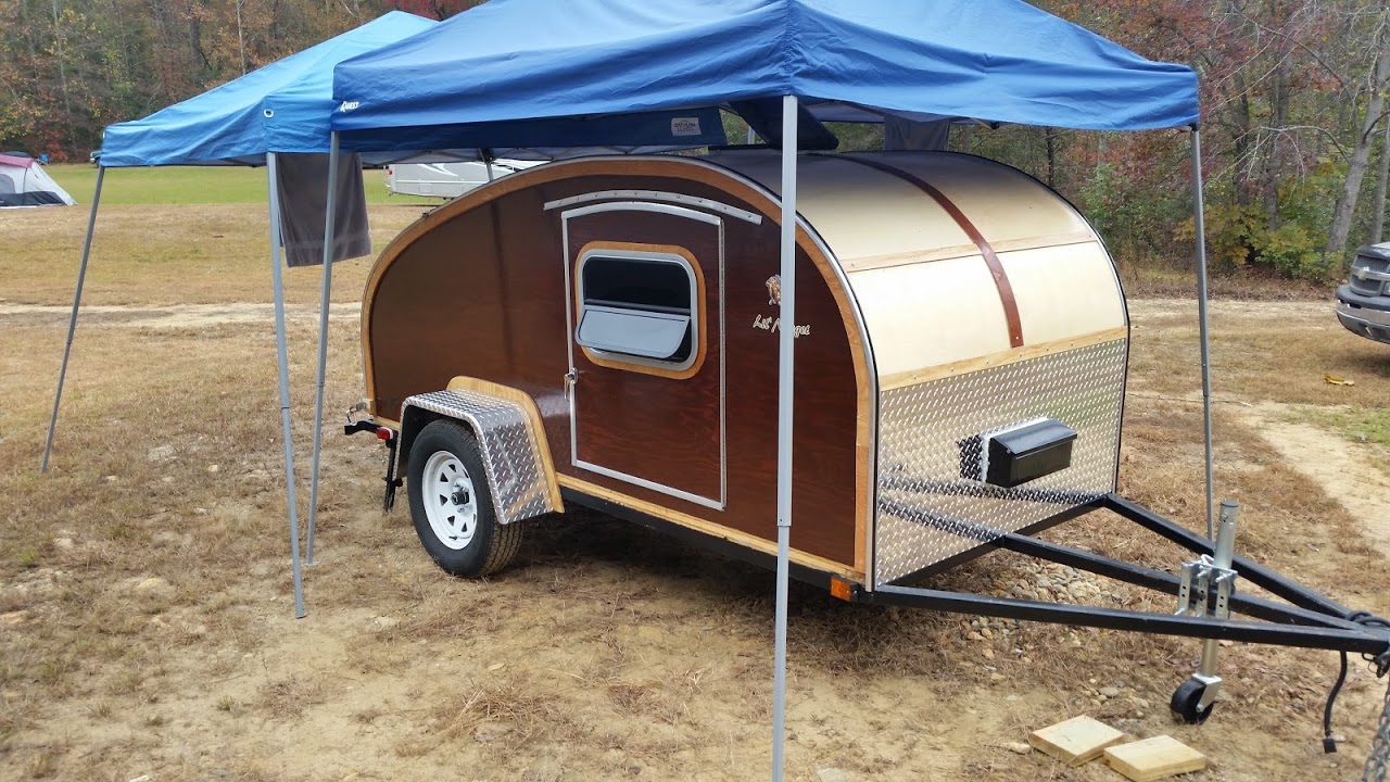

Is it driving through the piano hinge? How did you configure the seal in the current arrangement? I sympathize with your situation and understand your frustration, but with a bit more info and some detailed pics, I'm sure someone here will be able to help you find a solution!
If you have to, pull the bedding out to get it dried up (and keep it dry while you test for leaks), then get inside and have someone else hose the thing down. Figure out where the water is coming in. One trick they use for finding door seal leaks on a car is to close a dollar bill in the seal and drag it along; where it looses friction the seal is not being compressed enough.

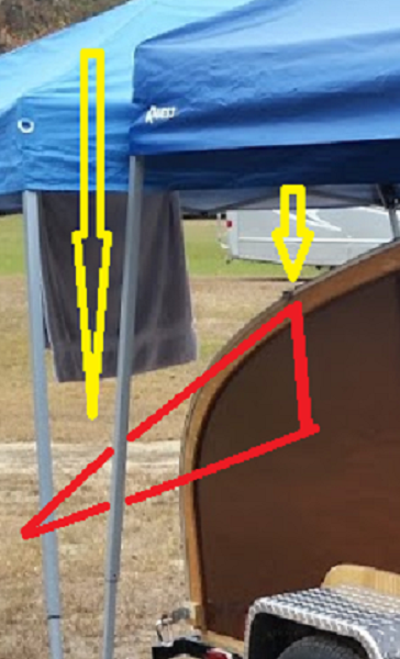

KCStudly wrote:Is it driving through the piano hinge?
  • It's probably not the leak you're concerned with, but the apparent(from the photo) placement of your two canopies is guaranteed to test the waterproofing of the piano seal over your hatch at some time or another. It appears that they meet just over your hatch seal, a definite dumping zone for water build-up from both canopies.
    canopy dumping area.png (484.49 KiB) Viewed 780 times
    canopies meeting just over hatch seal area? water dumping zone?
  • Believe me, I know how much water a canopy can dump on an incompletely sealed door, or hatch, seal. Just a minute crack in the armor can lose the battle against leakage. Perhaps your leaking seal problem can be resolved by just making sure all doors and hatches are firmly shut, not slightly ajar or loose, and by applying more force with stouter latches, as well. That's just an observation, from my own experiences with seals. Good luck.
