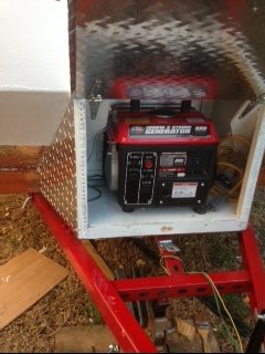

Postby Gold5one » Mon Feb 16, 2015 10:52 am
I got some work done on my generator storage compartment this weekend. Removing the 45 lb refrigerator gave me weight allowance for the generator without increasing my hitch weight. I designed the storage platform to be cantilever mounted off the front 2 cross members by using bolted supports underneath. The weight doesn't bear on the a-frame hitch channels. I did this so as not to change the load design/dynamics of the front a-frame.
I am thinking about an end goucho now, there is plenty of room for one- and some storage underneath- would that be desirable? I measured 33" from the front inside wall to the edge of the door frame :thinking:
- my 80 yr old neighbor does boat & RV cushion work and wants to sew me up some nice cushions- he has lots of leftover material- I'll give this some thought.
I removed almost 15lbs of wood when I demo'd the front- I had used 2x4's and 1/2" plywood- (overbuilt)- I think the new front end will be no heavier, even though it is bigger.
I am going to investigate getting some white 16" embossed aluminum for the sides- they use it for kick panels in screen rooms here- and aluminum tread plate for the front hinged fold down door.
I still need to fiberglass all the corners of the plywood where I boxed in for the generator.

Postby Gold5one » Mon Feb 16, 2015 10:56 am
The generator will be pulled out of the storage compartment to run- that is the only safe way to operate one.

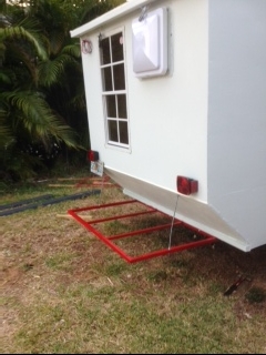

Postby Gold5one » Tue Feb 17, 2015 7:47 pm

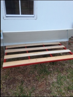

I decided to add a gear carry platform on the back. I re-purposed a 10lb welded steel frame from our daughter's old futon. It's been in the back of my garage for a couple years- I was saving it for some future use- well the day has come.
It's bolted to the rear frame channel and the front is supported by two 5/16" all thread. The platform is 47" wide and 30" deep- sticks out 14" past the back of the camper, so I will need a couple reflectors. I now have no problem taking gear with me- as long as I keep the weight down to no more than 40lbs. I tested it by standing on the back-- there was no problem supporting my weight. The back is raised 3" above level to avoid grounding out on dips and rutted roads.

Postby Gold5one » Thu Feb 19, 2015 3:24 pm
It is so windy today- I hope this cold front blows through in 24hrs. I finished my cargo platform- or maybe it's a back porch. I can see me using it in a lot of ways. That's my constant companion of over 10 years, Sparky, who is a playful Silky Terrier.

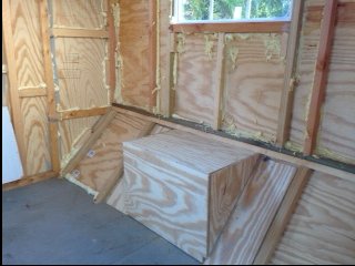

Postby Gold5one » Wed Mar 11, 2015 8:29 pm

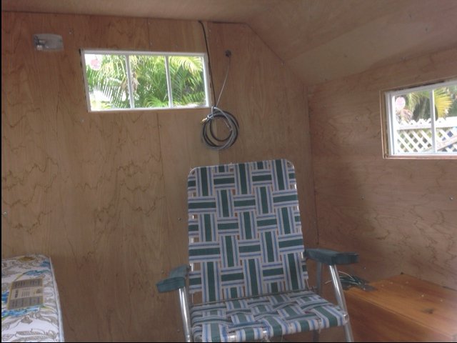

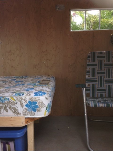

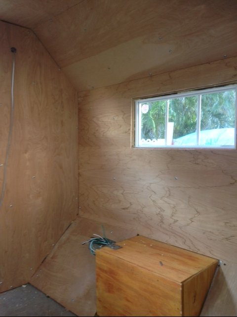

Wall paneling is done! :) I set up the bed and gauged the ergonomics of the inside space. I may have to downsize my counter size, if I want to have room for a relaxing camp chair inside- which is a higher priority.
The bed is a couple inches too high, so I will fix that tomorrow. I'm going to use outdoor carpet made from recycled water bottles, instead of vinyl tile ( too heavy)- Costco had a roll of the carpet , 6' x9', on sale for $13.99. It has a surprisingly soft feel. I will only need to trim 6" off of two sides to fit. I'm building a small 2 door cabinet above the curb side wheel well. I will have one of my 12v jacks on the top- to recharge cellular devices.
The 12v battery and A/C inverter will be in the bottom of the cabinet-- that will help balance out the bed's weight on the other side. I have three 12vDc lights- one ceiling in the back and two wall lights, and a 12vdc outside entry night-light below the awning window. I found out that Rural King has good prices on that stuff- Under $6 for lights.
Next winter, I will look into building a fold down couch/bed for even more room.

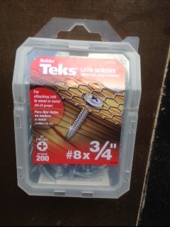

I wanted to mention the screws I have used for my wall and ceiling paneling- Lath screws. ( we do a lot of stucco in Florida) They have a more finished look than regular flat head screws and the heads are wider. I read a comment by one builder last year that his 12v lights had stopped working after a few years-- and I assume they stayed broken, because he had permanently attached his interior paneling, so there was no way to find the break.
I decided to use screws (no glue) so I can later remove the paneling for alterations and repairs, if needed.
The 1" ones are 170 per box, 3/4" --200/box, for a little over $5/box at the big box stores.

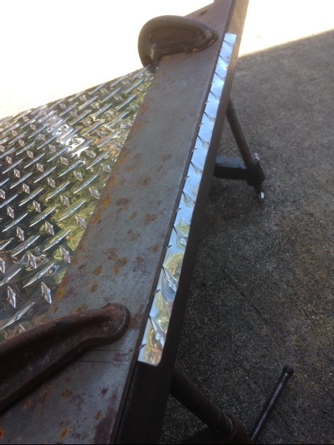

Postby Gold5one » Sun Mar 15, 2015 12:00 pm

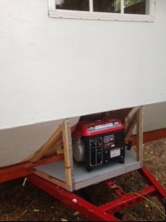

I finished the .063" aluminum that encloses the generator compartment- 5 separate pieces in all.
The front door was made 1" oversize in width. I had to figure out how to bend a flange without a bending brake-- my jerry rig worked, I just gently hammered it over with a 2lb hammer.

Postby Gold5one » Sun Mar 15, 2015 8:42 pm
I finished the generator compartment today. It's only for storage, not to run the generator in. Now I can concentrate on the inside again.
