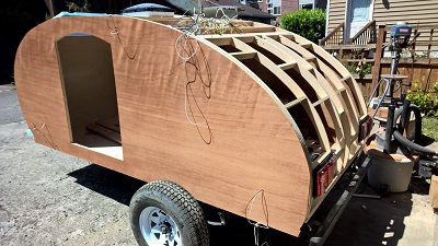

I got all of the spars in with openings for the Skylight and Fan. I remembered to drill wiring holes through the spars before I got the bendy board installed. I have run the wiring for the brakes and trailer lights and there isn't much room for the cabin and galley electrical wiring so I'll probably have to make more holes. Hopefully, I' bee able to get the drill in between the spacers.
The spars fitted for skylight and fan

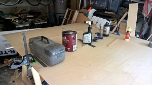

I was expecting the bendy board to be difficult to work with and it has. In my little space and my small table saw, I was challenged to get a straight rip to get the boards down from 60 inches to 58 1/4. Especially with the sheets not quite the same length.

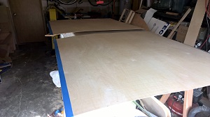

Getting ready to glue up the ceiling panels
I tried edge glueing the sheets together after they were cut to size in the hopes that there wouldn't be a seam. But it boards are just to thin to get a good seam. it worked here and there but I'll have to try something else.
Weighing down the seam

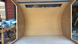

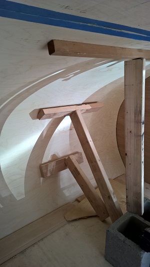

After a bit of a struggle, I finally got the ceiling in. It didn't cut exactly straight so I had to try to install it, mark where it was too wide, pull it out, trim it and repeat until I got the whole ceiling in. All while trying to keep the seam from separating. Plus avoiding scratching the already skinned inside walls. I finally got it in but noticed that some of the bottom coating as smeared on it somewhere during the process. I was worried that I wouldn't be able to clear varnish it. But some light sanding took it off.
supporting the glue up. Used construction adhesive.
The next problem is corner bead to cover the gaps where I had to trim the ceiling width to get it installed. I bought a few pieces of 1/2 x 1/4 hemlock trim. Hopefully, I can get it to bend the curve with out cutting.
view showing the gaps that need to be covered

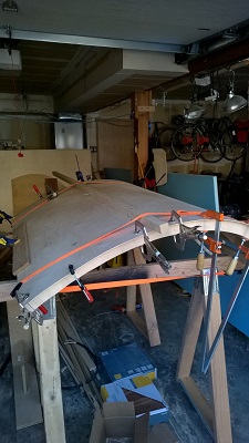

It has been a while but not do to lack of trying. I have been busy building but not fast enough for my tastes. The weather here in Seattle has been Unseasonably warm and sunny the past couple of weeks so that at least has helped me to move the trailer into the drive to have more elbow room to work.
I got the Hatch build last weekend. Still not attached though. I need to get through the electrical work before I can finish the insulation and put the top on. I also need to work on the galley build so that I know where to pull the electrical into the trailer.
But the hatch is built out now so I am happy about that.
The spars getting fitted
The glue up
A quick fitting to the galley opening

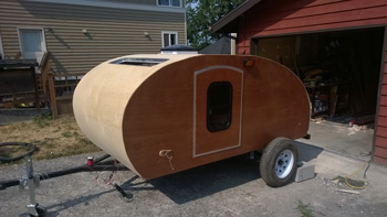

Just a quick check in. I have a more detailed write up on my hard drive some where but just wanted to let folks know I am still full speed ahead. Today was a big day with my finally getting a door mounted. It sticks a little bit and I still need to put in the weather stripping and door handle but so far I am happy with how it came out.

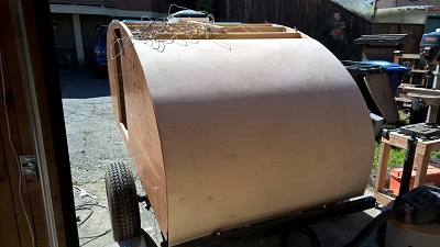

I finally got the cabin lighting worked out and am now able to attach the aluminum skin to the roof. In my effort to trouble shoot the lighting issues, I had to cut through the roof plywood wood to find the connections and make sure nothing came loose. In the end it was a loose common wire that got lost in the jumble of cables I have. I am kind of disappointed that I had to cut up the roof but I bade sure that I cut it on the spars so there was a secure place to re-attach the patches. I wood puttied the new seams and sanded them down.
I got the Aluminum from a South Seattle metal shop. They were only able to go as wide as 60" and my trailer has ended up at 60.25 inches. I am hoping it is ok with the width of the trim to cover the gap.
