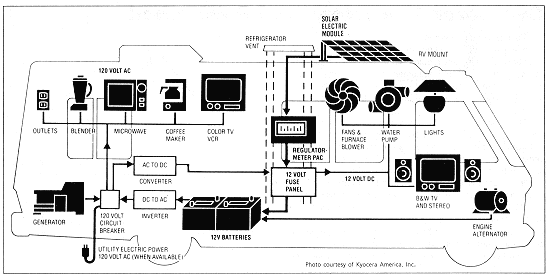

Postby jadedave » Tue Apr 21, 2015 10:10 pm
I love your electrical schematic ,, well thought out and looks like it is correctly arranged . Heres a RV schematic from another website Image

Postby lfhoward » Wed Apr 22, 2015 10:34 am
@jadedave, thanks for the electrical schematic. Glad to know I am on the right track!

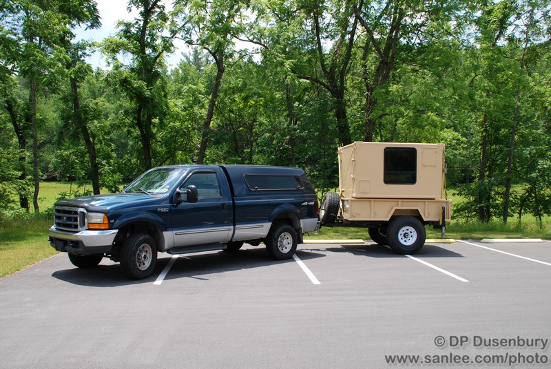

Yesterday while browsing SteelSoldiers.com (the forum for civilian-owned military vehicles), I discovered that the military makes communication shelters that can fit on trailers or the backs of humvees. These communication shelters are made of aluminum sandwich with foam insulation between, so they come already waterproof and weatherproof. Because of the aluminum construction, they can be as light as 600 lbs! With some simple modifications, I could attach one to my trailer and have a ready-made camper. Here are the details:
There are two models of shelters, the S-250 communications shelter which is designed for an 8 foot truck or trailer bed, and the S-788 lightweight multipurpose shelter (LMS) that is designed for the back of a Humvee. These are made by a company called Wenzlau Engineering. I found one of each for sale at a surplus yard not too far from me, for $1500 and $1300, respectively.
S-250: http://www.wenzlau.com/S-250.htm
S-788: http://www.wenzlau.com/S-788.htm
The S-250 communications shelter has been made into a camper before, but using an M101 trailer with sides on it. Here is the website for the build. It is quite cool!
http://www.sanlee.com/jeep/S250camper/default.htm
Here is one of the author's photos:
Either one could potentially fit on my flatbed trailer, but some modifications would be required.
