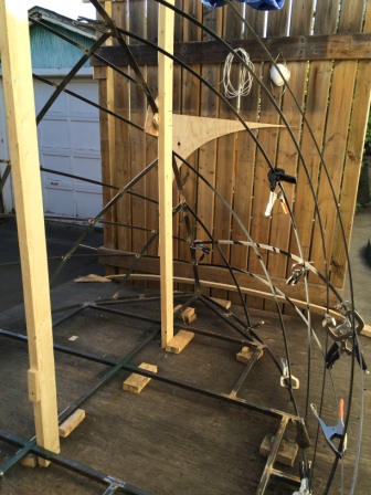

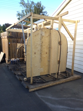

to attach the ply i figure on drilling and tapping a hole at each intersection, and using a machine screw with a nice big tapered head on it.
to tell the truth--- i lost some sleep worrying about this step. thinking that the gem-points would transfer through the ply wood ! nope---smooth as you please. maybe some shimming.
getting a woody.JPG (84.88 KiB) Viewed 2372 times
to attach the inside paneling i think a 'C' channel drilled, tapped and zapped to the intersections is the way to go.

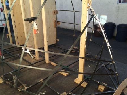

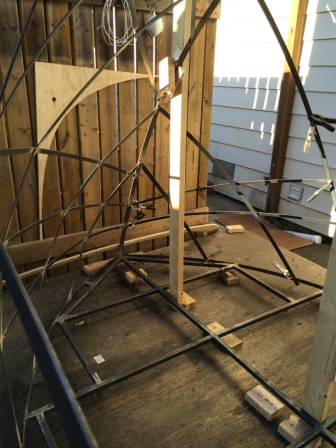

not a great angle. thinking i could use more clamps at this moment.
flip side track 1.JPG (74.63 KiB) Viewed 2287 times
flip side track 2.JPG (85.84 KiB) Viewed 2287 times

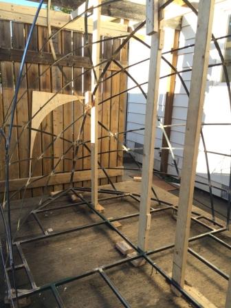

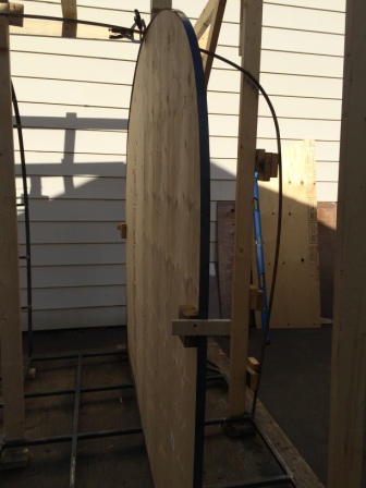

things are going well -----but for those who follow----spend some time and make sure the top spine is securely AND directly over the base spine.
while dialing in my (driver's side) cage bars i did find the top spine to have wandered to the passenger side about an inch !! (at the four foot high mark). probably did not help that i removed all those vertical 2x4's towards the back as i was putting together the other side. kinda had to for some of them, as they where in the way of some of the ribs.... as seen in the photos i did manage to haul it over with some jiggery. and as i had not welded my rib bottomS, on the morrow i can easily get this cage kosher..........
flip side track 3.JPG (82.06 KiB) Viewed 2287 times
thanks for looking and thanks for the inspiration :beer:

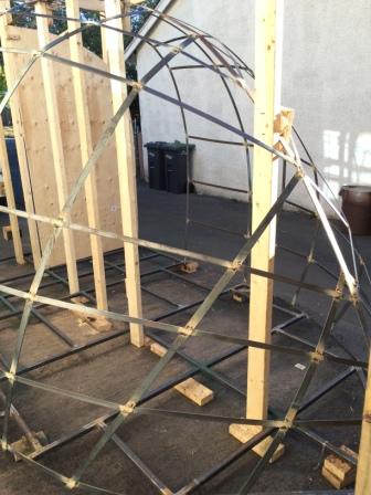

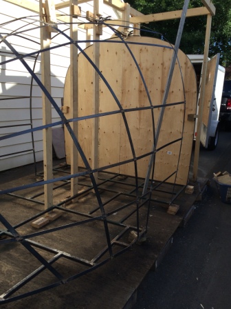

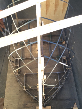

well i did it !! got the back section mirrored with a mostly straight spine and two halves that resemble one another close enough to be twins. intersections are level with their counter parts (within 1/4" at the worst, anyways) : angles are good : plenty of head room inside ( even though this is the bed end of the ship, i can still stand with lots of clearance ( 5'6" is a handy height to be ))
rear cage top view.JPG (72.71 KiB) Viewed 2171 times
rear end cage near done 2.JPG (32.34 KiB) Viewed 2171 times
started my day with a bomb on the motorbike to grab 6 more vice grip C clamps. up to 16 now and i still feel like a few more would be nice. :thinking:

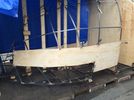

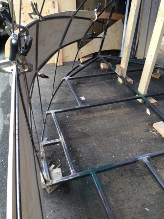

set up the profile on the forward side of the doors---re-purposed the ply wood from the last section. the walls up to about three feet are pretty much parallel, but from there up the curve changes just a bit. i jig-sawed off a long skinny elephant tusk of plywood---the difference between the two areas being just an inch or so along he top.
front end start 1.JPG (76.2 KiB) Viewed 2091 times
the trick now will be to get the front curve to transform gracefully into the curve coming off the doors. as i sat with beer in hand pondering the logistics of such a thing----i thought that perhaps if i treat it just as i did the back end----clamp the H-E-double hockey stick out of the straps at the spine and then clamp the same amount on the other end of said straps where they meet the base, all the while keeping a keen eye on the strap-horizon and how they round the corner-----effectively mirroring the rear end, but this time with a snubbed nose----things should go allright. if they don't i will know right quick......
front end start 2.JPG (52.7 KiB) Viewed 2091 times
