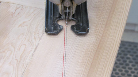

It's been a few days again but I've been making progress on my wall cores. I have them all glued up and now have then rough-cut to my pattern.

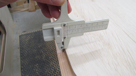

I like to remove as much material as I can before I fire up the router. So first I mark around my pattern onto the core a line approximately 1/8" from the edge using a compass.
Then I draw a line right next to the pattern with a red pen. This gives me a "cut line", the black one, and a "keep out" line, the red one. This works really well for these old eyes.

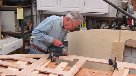

Here I am in my "tiny space" space building my "tiny trailer" :)

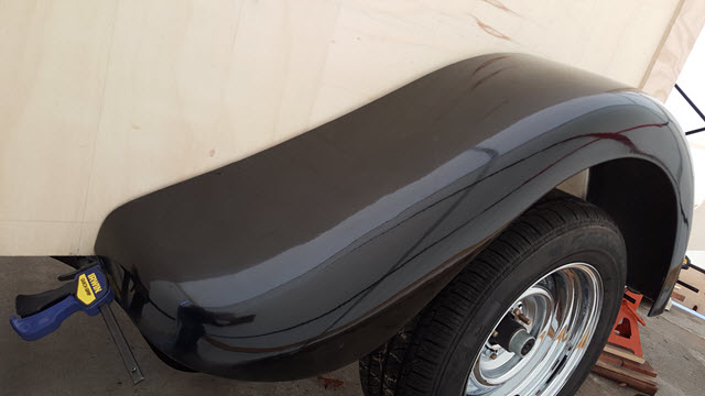

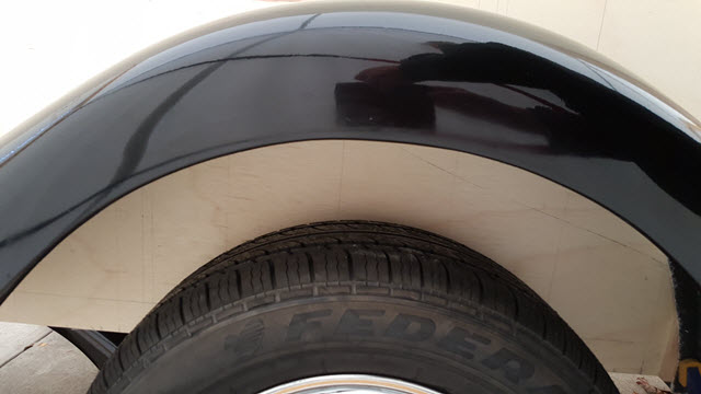

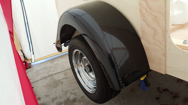

I've made some more progress on my walls but the big news is that my fenders arrived. :D
The bad news is that I'm worried that they maybe too darn big! :frightened:
Unfortunately I'm building my TD in a very tiny portable garage so I can't get far enough away from it to see what they really will look like.
I've taken some pictures and thought maybe I could get some guidance from you all.
As you can see there is a huge amount of space between the tire and the top of the fender. The trailer is not on the ground and of course there's no weight that would compress the torsion axle. I know that would narrow the space some but will it be enough, I'm just not sure.
It you all think it's just fine then my second question would be, where do I mount it so the fender will be centered on the wheel since the torsion axle will move back some as it gets loaded.
Thanks for you thoughts.

Postby KCStudly » Sun Dec 13, 2015 5:09 pm
I would wait and locate them once you are on the ground and at ride height. You may have to go to a bigger wheel and tire combo to fill them out.
What size tire and wheel does the Mfg recommend?
