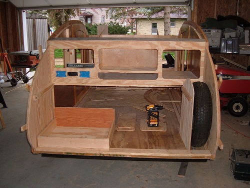

Time to take a break. So I thought I'd post a pic. Got the top part of the galley bulkhead rough cut out. Not looking forward to fitting all the doors and openings. Going to save that for a different session. Back out to the shop in a bit. Time to start on the lower half of the bulkhead, counter top, and bottom cabinets and shelves.

You must have done quiet a bit of pencil scratching. Sounds like you have things pretty well thought out and yes I should have my own build journal,sorry for taking up space on yours. I do enjoy comparing notes. Today is a zero day in the garage , it feels like winter again. Doing stuff on computer. I need a lot of parts . Don't worry I won't list them here. :)

Have not had much time for the tear the past week. Couple hours here and there. Been trudging my way through fitting the doors to their openings for the galley cabinets. Alos looks like this fir plywood wants to curl up pretty bad. Most likely I will have to add stiffeners to the backs of the doors to keep them straight. So more fussy little stiffner sticks to cut, glue, and clamp up to slow me down a bit.
Still not settled on under counter storage and shelves. I think I might not use the slide out drawer I built for the cooler/camp stove. Storing those 2 items the narrow way instead of the wide way gains me 6" more in storage width in the galley. I have a good amount of gear I want to leave stocked in the camper. So those few inches actually matter to me. Plan is to be able to hookup and go, with minimal loading, when I wish to travel.
I should be able to finish fitting the last galley door today. Then it's time to nail down the layout of this under counter storage and get it built.

I was always concerned about that situation , I mean ply taking on a bend and having to straighten out after ward. My exterior walls and inner core piece's were cut and i didn't wast a lot of time gluing and screwing together . I moved right along always trying to keep every thing square and straight. Are you using 3/4 single ply for doors? I did a lot of mock up work last Thursday and Friday. I put in some rough stands and braces to hold up some 1/4" ply piece's to simulate shelving and counter top. I'm getting height and depth. This last weekend I had to put out the pier for My dad . He's at that age that he can't handle it any more. So nothing done on the weekend. I found out it rained most of the time down here anyway.150142

The doors with the warp are my galley bulkhead cabinet doors. The galley bulkhead is 3/8" thick fir. I'm using the opening cut outs as the cabinet doors. That's whats curling a bit. It will be fine with the stiffeners added. I'm just whining about the little extra work is all. I really hoped to make some great progress this season and don't want to add any extra work.
Good news is I have finalized the under counter galley storage cabinet shelf layout. So I've been building the cabinet partitions and shelf supports. I'm real happy with the amount of gear I'll be able to stow back there. A place for everything, and everything in it's place.

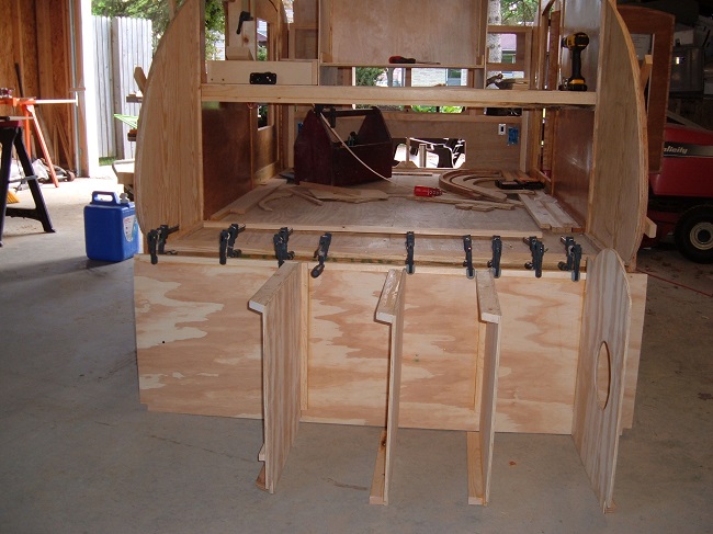

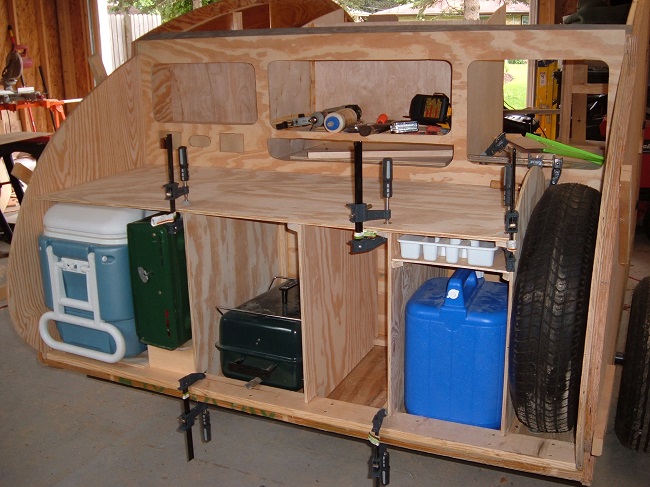

Postby Mr. Lahey » Tue May 22, 2018 5:12 pm
Got a few more hours in on the tear and have a good start on the removable lower rear bulkhead galley cabinet. Still need to cut and install multiple shelf supports and shelves in the cabinet. After quite a bit of stacking and shifting of items I was able to fit the following camp gear in the cabinet space real nice.
From left to right the partition spaces will hold:
Space 1: Ice chest, Coleman camp stove and 2 1lb propane bottles
Space 2: Portable gas grill and dish washing tub
Space 3: A stack of 3 plastic mesh storage baskets
Space 4: Coleman lantern, 1 gal Coleman fuel, 5gal water jug, silverware storage divider
Space 5: Spare tire
I have to work the next few days but will still chip away at it a few hours each day after work.

Postby Mr. Lahey » Wed May 23, 2018 7:37 pm
Yep the round hole is access to the J bolt and wing nut to tie down the spare to the wall. Thanks for the tip on stiffening the doors. I may take a look at that. I've had the cabinet doors under a heavy tool box on the floor of the tear for a couple days now. You can see the tool box in the last photo. The doors are getting pretty flat. Had a look at them today.
You're right on the 3/8" ply in galley trying to keep things lighter. The cabinet structural parts and counter top are 3/8". The shelves in the cabinet will be 1/4".
Got a couple hours on it today after work. Made my spice/condiment cabinet box. It goes behind the left upper galley cabinet door. Also got some more bracing and sanding done to the galley bulkhead cabinet. It really fits in place nice and it goes in and out easily. Just what I wanted.

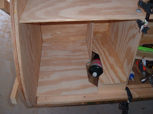

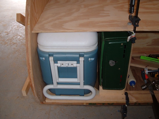

Postby Mr. Lahey » Sun Jun 03, 2018 4:51 pm
Been making some progress on the lower galley cabinet. I've been chipping away at it a couple hours here and there after work. Got some time in on it today as well.
Finished the cooler, stove, and propane storage cube today. It all fits by fractions of an inch. It will clear all my hatch ribs and lower weather strip rail etc. I can tuck two 1lb spare propane bottles under the camp stove floor. Most of the water jug, silverware cube is finished too. Got the countertop cut and fit. Next up is the cube that holds the propane grill and dish washing tub.
Saturday I stopped at a teardrop event held at nearby campground. Had a real nice time meeting folks and viewing their teardrops. It really put a charge in my enthusiasm to get going on mine. The event was at a real nice campground. I would love to have been there in my camper. Still a long way to go before I can go camping in mine.
Couple progress pics:

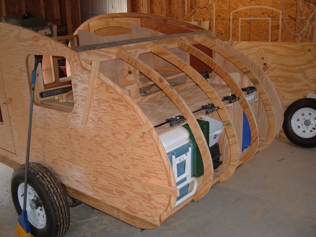

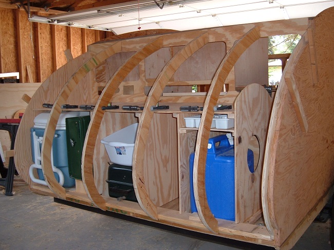

Postby Mr. Lahey » Tue Jun 05, 2018 12:25 pm
Got started right after breakfast today. I had ribs for lunch!!
That is I have my hatch ribs cut out and belt sanded just in time to break for lunch. So I mocked them up in there approximate locations so I could have a look.
I still have more work to do to the lower galley cabinet. I was just getting tired of it, so decided to switch to the hatch parts. Do something different for a while. Since I was feeling lazy I let random luck decide if the hatch would have vertical or horizontal ribs. I wanted to do vertical ribs, but was not in the mood to go wrestle a 4x8 sheet of 3/4" plywood home from the lumber yard by myself. So I left it to fate. I knew I had some plywood stashed in my storage shed but did not know what thickness it was. So I said if it's 3/4" vertical ribs it will be. If not than horizontal would be the way it would go. As luck would have it there was a sheet of 3/4" there.
