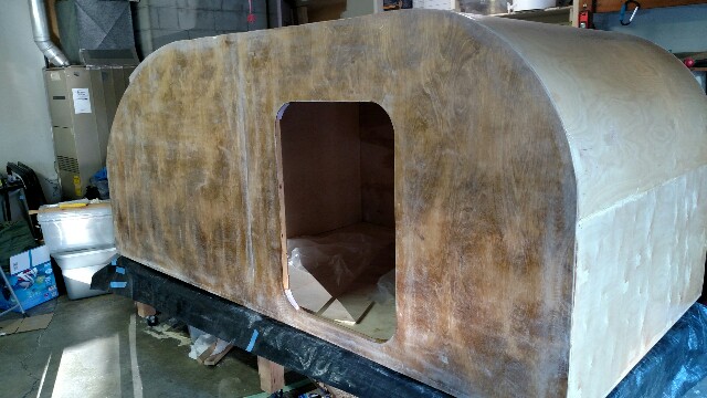

I've made some more progress. the epoxy skin has made me really appreciate epoxy in general. I mean that in more ways than one. it is a GREAT product for specific things. skinning gets a much thicker/stronger coat than urethane, laminating panels together with glass is an amazing way to get a water tight seal. and laminating/ glueing two products together with epoxy allows for joining on a less than perfect plane, something that wood glue does not allow.
I also respect Epoxy as far as its working time and breakdown of materials go. my foam roller would last me right at 30 minutes. if I tired to go longer than that I ended up with specks of foam in my finish... something that required me to take a razer to the shave off, then sand smooth. it also has a viscosity that gives it a life of its own. it will stick to ANYTHING and then find a way to dribble off. all in all, I am glad I spent the money on it. I have 2 coats on the entire trailer (including the bottom), with a third on each side and I still have about a quarter of my 1.5 gallons remaining. If I ever do something likes this again, I will use Epoxy to bond foam to wood rather than the 3M Fastbond. the cost is the same and epoxy gives a better product.
to the pictures!

after 1 coat of Epoxy. I used Raka UV inhibited slow cure. it has a pot life of 30 min at 77* and was very forgiving to me as a novice. the wet out was quite good on the fiberglass taped seams and it dried crystal clear and colorless.
144267
I cut my own tape from a 1 yrd square of 2oz cloth. I wish I would have paid the extra $15 for a roll from raka. it would have been easier than cutting my own. and the same price as I had to buy 2x 1 yard squares to get everything covered. having said all that, I learned a lot about fiberglass. cut on the bias, a 45* angle, causing the weave to make an XXXXX pattern. that way there is no loose threads at the ends of the piece that fall out of the weave and end up as globs of thread in your project. also I imagin it is stronger because at a 45* angle, you have twice as many threads crossing your joint opposed to only weft of the weave crossing while the other directing in parallel to the joint. and XXX is stronger than an HHH when joining.
144268
two coats of epoxy,
144269
oh no! I ruined my trailer!!! joking...
oh wow that really stops the heart the first time to sand to get to the finish you want. I first washed the amine off, RAKA UV is supposed to be a no blush, and I did it under warm and dry conditions, but I washed anyways out of an abundance of caution. then I sanded with 150 grit. the real goal was to knock down the drips, runs, and tape seams, and then fast pass over the whole surface to provide a good mechanical bond. I oversanded in two spots and had to reapply some stain, left it on for 10 min and wiped off the little bit that hadn't dried. after a coat of epoxy I couldn't tell where I oversanded.
I plan on one more coat of epoxy on the sides and seams and leaving it at that. the roof will be covered in aluminum, and as of now, the sides will be left bare. the wood looks better when wetted out with the epoxy and I don't want to add another 100lbs of aluminum. I may paint at some point in the future, but the epoxy is good enough to get me out the door before camping season ends.
as far as the finish. I just don't have the patience to do a proper job. the tape at the edges is noticeable up close, but it passes the 10ft test after the single pass with the 150. plus half of it will be hidden by the trim. the field looks good and I think I will be happy enough with it. I hope to be campable for labor day so I will go naked epoxy through then. after that I will either paint or put on several coats of spar urethane.

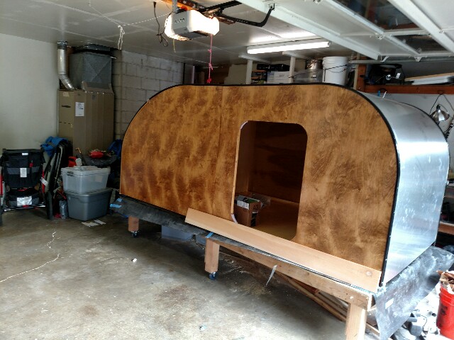

Postby yrock87 » Thu Sep 22, 2016 5:47 pm
Got some work done on the hatch! I finished sealing with epoxy and got the trim painted up. I then fit the aluminum onto the hatch and starting with the hinge, began installing the edging around to hold the aluminum in place
144894
I screwed from the "underside" of the hinge on the hatch to avoid screws on the top where water could penetrate. after installing with 2.5 inch kreg scews (through oak into pine) I doubled up by adding short and wide 1 inch machine type screws that would give me full bite into the closer oak as well. (the kregs have a long neck, so no thread in the oak, only pine)
144895
then I started at the top and added the side trim to each side.
I was left with the bottom piece that I had cut to short to go edge to edge on the bottom, and my sides were to short to reach the bottom. . I will be fitting a new straight bottom piece to go edge to edge, with enough on either side to partially wrap around the corner to the side edging.
144896
144897
Lots of pre-drilled holes for the hinge!
144898
not a flattering angle, but the hatch is skinned and on! it was a PITA to slide the hatch onto the pre-mounted cabin side of the hinge. my hinge isn't perfectly straight, there are some slight bows where I added some bracing under the aluminum due to my cabin having a concave slop at the hatch. I property braced the center of the roof to have a convex shape when I glued everything up, but for the 12 inches of roof in the galley I forgot, so I had to deal with some inward sloping. I thought that adding some blocking would be the best approach. and while it leveled out my roof, it created binding points on the hinge. the hinge operates smoothly still, but I will NOT be taking the hatch off without unscrewing the hinge. it took two of us about 30 min with a block and a deadblow hammer to get the hatch all the way slid on. in hindsight I should have added some lubrication, but I doubt it would have been a problem if I would have ensured I had a perfectly flat bed for my hinge to mount to.
Have I mentioned that I have learned a lot in this build?
144899144900
I also installed gas struts. my struts are slightly undersized. I got a little ahead of myself and picked these up a few months ago, so returning is not an option. but at least you can see how it would work. These two 45 lb with 8 in throw struts are about 7 lbs short of being able to hold the hatch up on their own. the * inch throw is also a little short as the rear of the hatch is about 6'2" above ground and I am 6'1". not a lot of room, especially I the ground is uneven. adding about 2-4 inches of throw and 10-15 lbs per strut should give me what I need. on a side note, the hatch weighs in at about 30 lbs. however the aluminum on the hatch weighs and additional 12 lbs. these struts would probably work if I didn't add aluminum... also, the aluminum sheet as a whole ads 48lbs to my build. that isn't trivial as the cabin weighs in at around 300.
144901
A shot from above to the open hinge. the screws on the hatch side are under the hinge and the screws for the cabin side were screwed through a bead of RV roofing sealant. all trim edges will be clear silicone calked before going outside.
my cabin trim still needs to be installed, it is just setting there in this photo.
