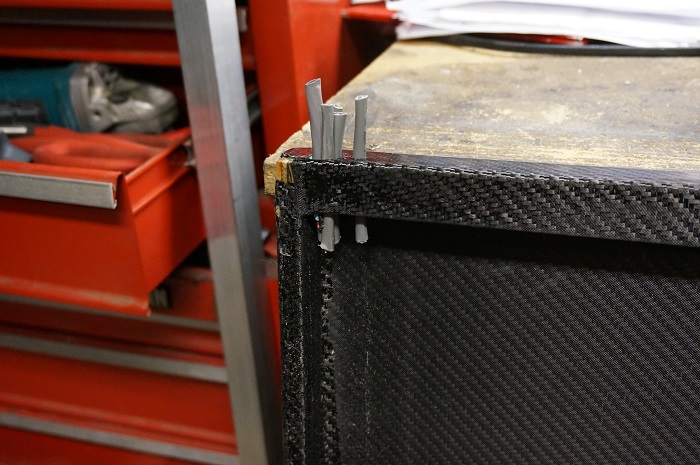

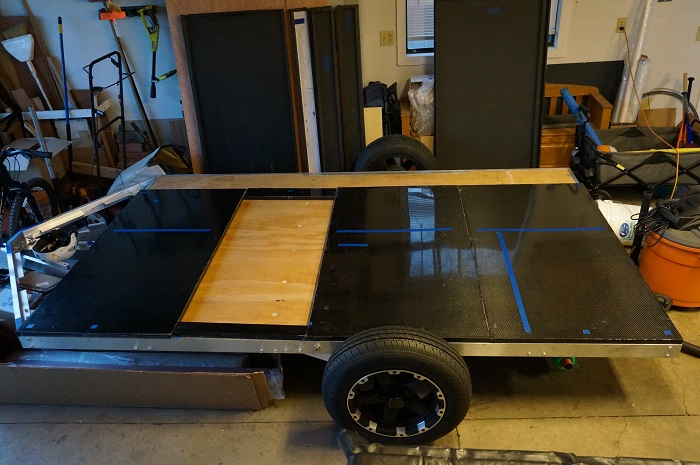

For my first build, I plan on simply creating wood frames that I'll epoxy in place on the inside of the panel, then cut out the opening in the skin with a router and flush cutting bit.
Doors
Doors could be done just like windows if using commercially built units. My doors will be custom panels (because I'm crazy) with 180° hinges and square windows. One door on each side.
Wall-to-frame attachment
My plan is VHB tape between the bottom of the wall and top of the frame. I'll also use 1/4-20 bolts up through the frame into the bottom of the wall panels using special T-nuts made for fiberglass/composites. Each wall panel will have one bolt.

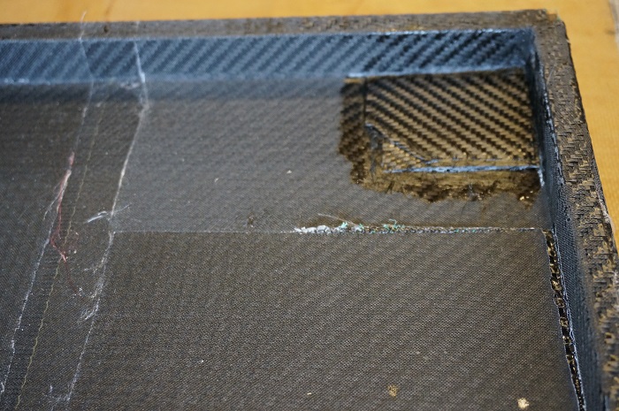

This will be redundant if you're following my construction technique journal, but for those that aren't, here's a quick note.
I made the first full-size carbon fiber panel last weekend. The panel, which is 60" x 30.5" x 1" weighs 7lbs 3oz., or 0.57lbs/sq.ft..
My trailer will have ~231 sq.ft. of skin surface, so the weight of the panels will be around 130 pounds - keeping in mind that smaller panels will be heavier per sq.ft. and larger ones will be lighter psf. This also does not account for the foam or the inner skin. My rolling trailer frame (frame, axle, brakes, floor, hardware, coupler, jacks, wheels, tires, chains, etc...) is around 230lbs (if I remember correctly), which should get me under my dry weight goal of 1,000 lbs. with room to spare.

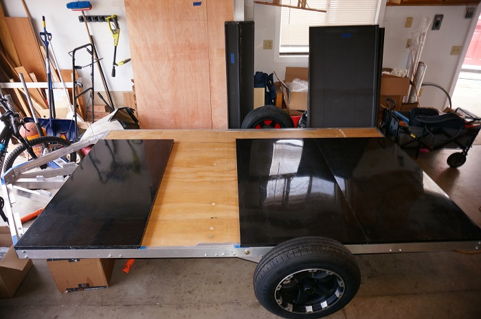

Exactly one month since my last post. Sorry, folks. Fortunately, a lack of posting does not correlate to a lack of progress. In that time, I've made 16 carbon fiber panels, which doesn't seem like much, but it is a lot of work. On average, I've been able to knock as many as 1 1/2 per day on the weekends, and 1/2 per weekday. It takes about 4 hours for the epoxy to cure and about 3 hours for the clear coat to cure, so a lot of that time is spent waiting - or sleeping because I try to time it so that I finish spraying or infusing before bedtime, which has lead to some late nights.

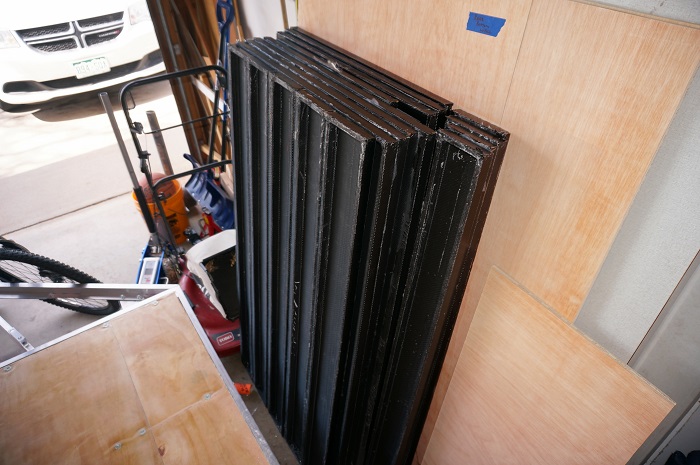

Here's a picture of the 16 panels. This is most of the 60" high panels, including all of the 60" wall pieces for the cabin and the v-nose, as well as 2 pieces for the roof "ridge", which also happen to be 60". What's still left? The other half, which includes all 5 doors, the small pieces that go above and below 4 of those doors, the cabin roof, and the v-nose roof.
With the 60" wall panels done, I moved on to those smaller above/below the door pieces today. The first part of that process was laying the larger panels on the trailer floor to get a very accurate measurement of how long they need to be. Here's a look at the wall panels laying on the floor. The door openings are ~25" wide.
I'm going to try infusing both the above and below the door panels at the same time tomorrow. The one below the door is 3" tall, the one above is 5" tall.

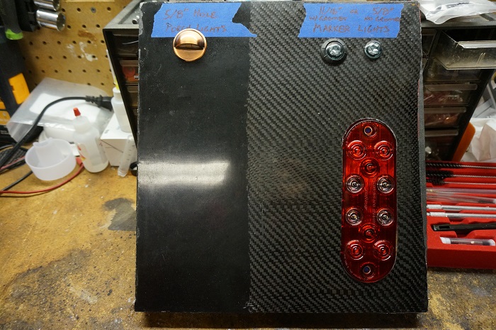

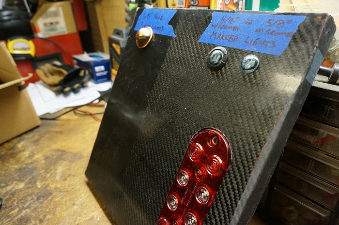

I took some time to cut holes in one of the test panels to mock-up the lights.
I didn't really like the tail lights sitting proud on the surface of the skin, so I cut a pill-shaped hole in the panel to see what it would look like mounted from behind. It doesn't show well in the picture, but the small detail really looks nice. Luckily, the diameter of the ends of the tail lights is 2-1/8", which just happens to be the same as a hole for installing a deadbolt or knob on an exterior house door, so hole saws that size are everywhere.
I'm using 1" dia 12VDC LED landscape lights for porch lights. I've used these guys on a yard project and they're really low profile and give off a nice amount of accent lighting. Oh, and Amazon sells black ones. They sit nice and flush and I'll probably epoxy them in place. Yeah, I know it'll be a pain to replace if they ever burn out.
Marker lights will be smoked lens 3/4" diameter. I tried with the grommet and without just to see how they look. I decided that I will use the grommet for looks and to be able to change the lights in the future if necessary. A burnt out marker light is different than a burnt out porch light.

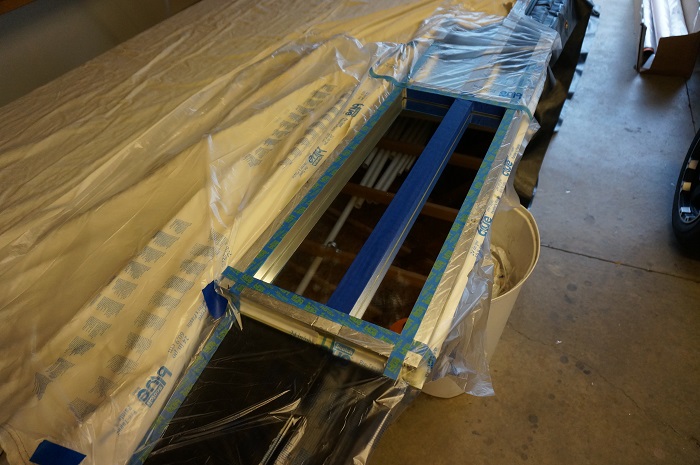

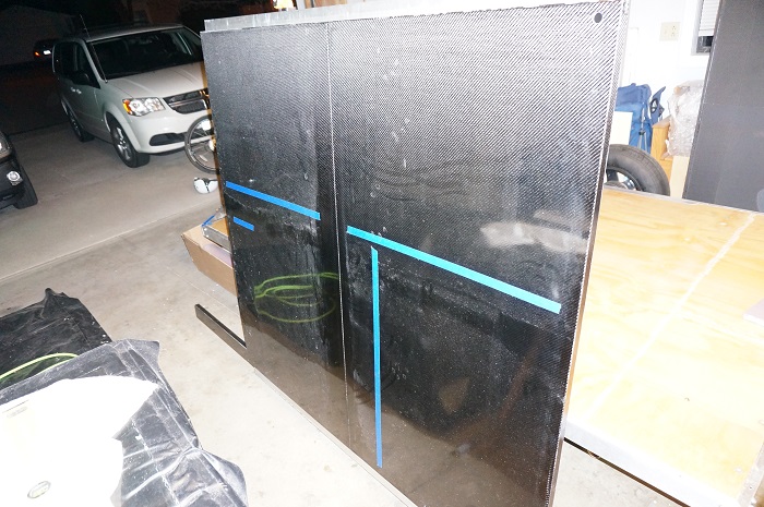

Here's a picture of the driver's side wall panels laying loosely on the trailer floor. The tape represents the lights, switches, rear storage, bunks, etc... At this point, I'm just trying to plan everything out and make sure I don't forget anything.
This weekend, I hope to join the panels, drill holes for lights, run wires and maybe even start on the passenger side. The individual panels will be "glued" together with thickened epoxy and wood biscuits. The biscuits will add strength and more importantly ensure proper alignment. I also drilled holes (see picture below) in the top/bottom of all panels for wiring. Basically, there will be a group of wires running the length of each wall along the floor and another group along the ceiling. Here's the picture, but keep in mind that the panel is laying on its side, which is why the wire are vertical.
Things should move along much quicker now, so stay tuned for more updates.

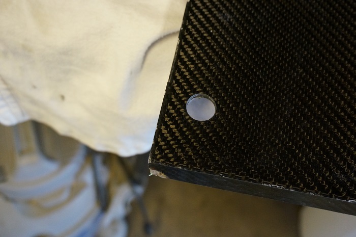

This morning, I added some "bolster patches" to the areas that will be receiving marker or porch lights. Simply put, they just add thickness.
Drilling holes in a perfectly good panel is a little nerve racking, but they all turned out fine - and I'm pretty sure most of them are in the correct place.

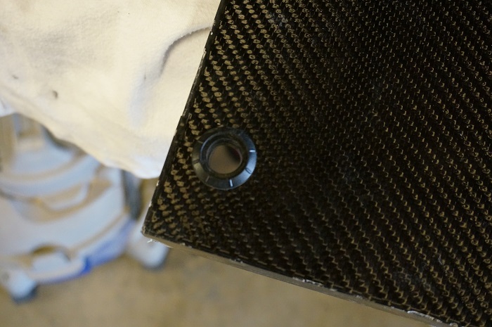

Here's one of them with a marker light grommet installed. The light fits nice and tight, so hopefully now leaky-leaky.

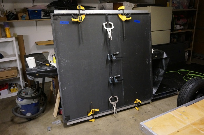

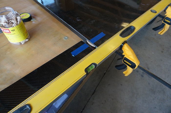

So wall assembly goes something like this... Align the panels and mark them for the biscuit cutter. Glue(epoxy), clamp and let cure.
Here's a shot of the driver's side door "footer" with the biscuit cut in for a test fit. Ready for epoxy!
I didn't get any pictures of prepping the big panels, but its the same as above. Here's a shot of two big panels epoxied and clamped up. A little vinegar took care of the oooze.
And here's a shot from the back with the panels clamped.
It was my first time working with thickened epoxy and I have to say it's strangely satisfying.
Steve

Driver’s side wall, passenger side wall and rear wall (not including doors) are now glued/epoxied together. Probably start pulling some wires and continue on with the assembly tomorrow or the day after.
