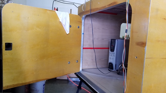

Postby twisted lines » Sat Feb 22, 2020 1:09 pm
Today the back looks like this, and its going to be 60* next week :shock:

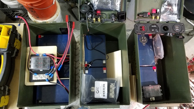

Well now that I have spent my stimulus check through amazon :shock: Figured I would try the Music and blow the dust out;
Started on my wiring Diagram, After a first attempt at the old 36 V battery's I may need to change this one in the future, but the other two are to be Minkota / portable / Drop Power. Solar charged as well 84 AH total.

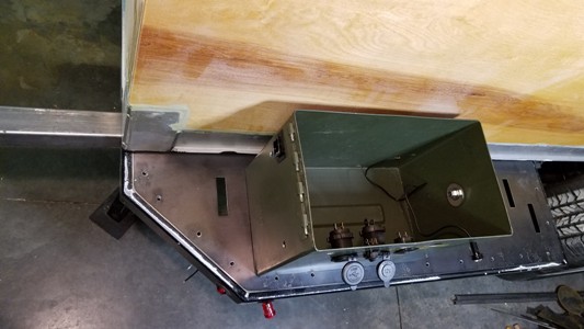

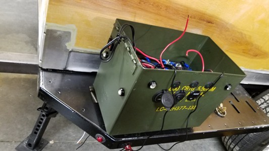

Spent all day drilling holes in this box that is not done, At camp it will live under the table close to here,
hope the table doesn't leak :beer:

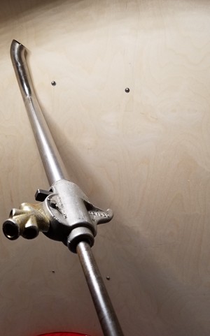

Found the worst project ever and at a bad time, Shoulder level or higher with the arms! Took me a while to find an answer to part of my problem.
The monkey on a stick and a scrap of stainless from a plumbing job in a brewery held the front radius alone. Many, Many :beer: s
May this piece please stay in place forever :worship:

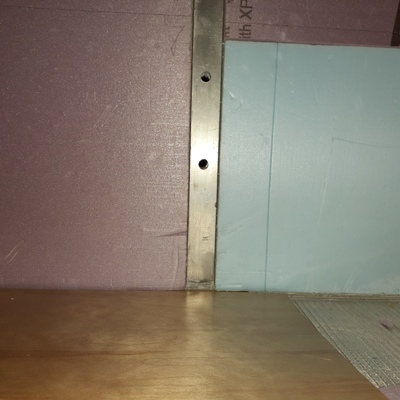

One piece is still hanging in place no can pull
Matching headliners his and her's 61-3/8" at the widest point On a 4 X10 I think I know what one goes over my head :thinking:
Some fine handy Caulk work (Hers again) then a few runs with Clear poly :thumbsup: how long until till dry :lol: Well the caulk was just touchable with latex gloves at three day's and that's when the poly wen't on.
60 plus Headliner.jpg (52.25 KiB) Viewed 3987 times
Front Section.jpg (39.35 KiB) Viewed 3987 times

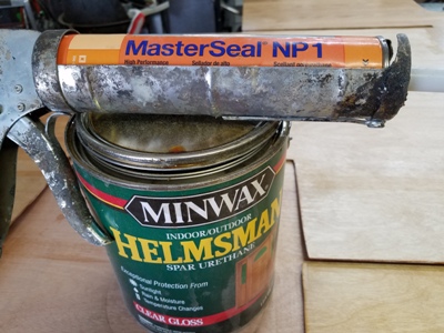

One of my personal boats I replaced all of the wooden interior and used the boat occasionally for two summers :D it sure was pretty got lots of complements
Yep refinished it three times Polished Aluminum, Wood and all, Sold it less then five minutes after parking it with a sign on it at work The third time.
No exposed wood If I can help it.
Items used before final top coat
Caulk then Clear Gloss.jpg (71.13 KiB) Viewed 3959 times

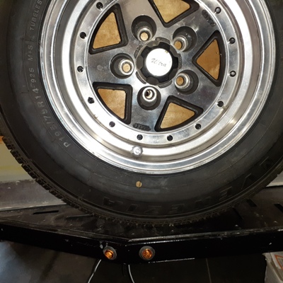

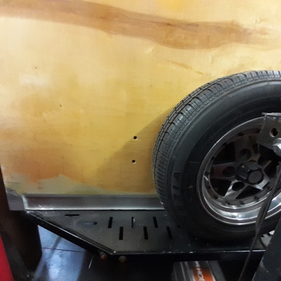

Postby twisted lines » Fri Nov 13, 2020 1:36 pm
I did a lot of searching for a chuck box, and am just starting to gather the things I want to put in it.
I have not seen anything done that's removable in any flatbacks or cargo trailers; If you have done it,
have any good ideas or suggestions please chime in.
While I clean up a (lot) in prep to get started again.
Spare tire plan its resting on the bumper bolting through 1.5" tubing with 2" of foam give room for a 1/2" of something then through the inside wall some time in the future after paint :NC

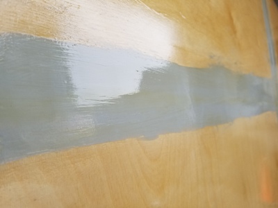

Re: HandiCramper

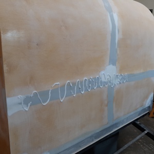

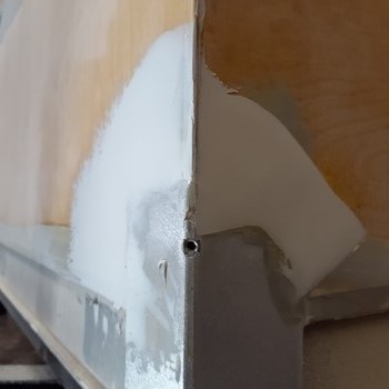

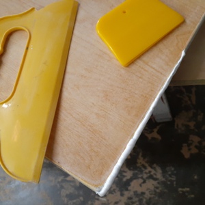

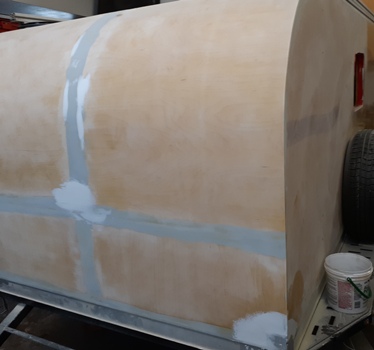

Postby twisted lines » Wed Mar 03, 2021 5:16 pm

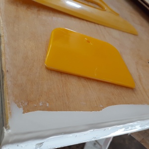

Skim coat of Caulk, because it doesn't stink & I don't have to mix it,
I read 180 grit; I like 80, that's for the poly / paint! First time :shocked:
(Caulking) Never found a great place that made picking one eazy.
So far I like this one but I sure thought that more then ten times :worship:

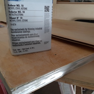

Postby twisted lines » Fri Mar 19, 2021 10:47 am
Yesterday was a good day to open the MEK Nice and windy :?

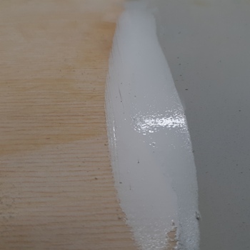

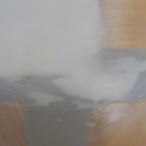

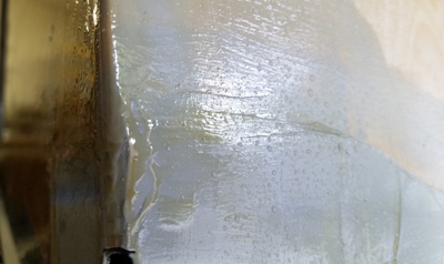

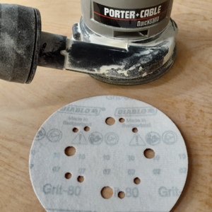

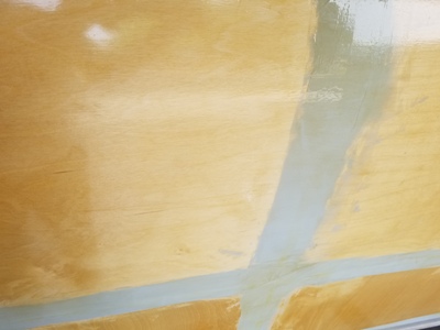

Re: HandiCramper
Postby twisted lines » Fri Mar 19, 2021 11:13 am
220 dry just didn't cut into it but didn't hurt it so next was 80 again, dosent make dust nor stink :thumbsup:

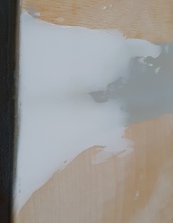

Re: HandiCramper
Postby OP827 » Fri Mar 19, 2021 12:37 pm
Are you using caulking as a fairing compound, what kind of caulking is that?
Or I missed something...
OP827
Posts: 1595
Images: 414
Re: HandiCramper
Postby twisted lines » Sun Mar 21, 2021 3:25 pm
OP827 wrote:Are you using caulking as a fairing compound, what kind of caulking is that?
Poly urethane :EXP
