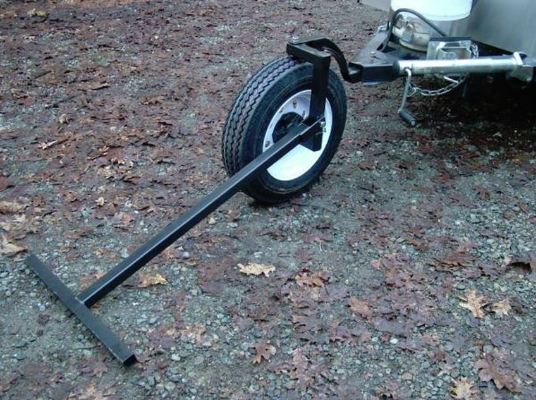

Postby twisted lines » Thu May 23, 2019 4:22 pm
tony.latham wrote:
The removable coupler is more or less done.
Found something I wish I had set mine up like your's so I could do this.
Tear Tote (2).JPG (70.06 KiB) Viewed 8889 times
Racking up; And Rapin foam
twisted lines
Posts: 1243
Location: Jefferson
Re: #4
Postby tony.latham » Thu May 23, 2019 7:02 pm
I like it. :thumbsup:
