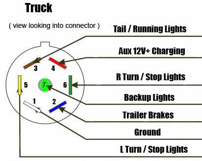

NevadaBlue wrote:How did you get the rock lights to come on when reversing? I just bought a third brake light with ‘cargo’ light. I would like that white light to come on when I back up.
I have a round 7 pin trailer plug on my van. I believe it was the center pin that gets energized when the tow vehicle is put into reverse. So awesome with all those lights when backing up at night.

Postby NevadaBlue » Sun Dec 22, 2019 10:32 pm
Thank you! I’ll check that out. :)
And a quick search confirms that. Of course the diagram I had called it ‘auxiliary’. LOL, what’s that. :shock:

Postby ricky herbold » Mon Dec 23, 2019 7:02 am
NevadaBlue wrote:Thank you! I’ll check that out. :)
I believe the auxiliary wire can charge the trailers battery from the tow vehicle while driving. I don’t currently plan on using that.

Postby Louisd75 » Mon Dec 23, 2019 11:46 am
Ken,
Be careful going off of generic diagrams off the internet, there are apparently a few different "standards" out there. I wired my trailer based off of a diagram and then found that few things worked properly...turns out that the 7 pin diagram I used was not the same as the 7 pin on my truck. I wound up having to test each pin to figure out what turned the voltage onto it for peace of mind. :?
Ricky, I really like the rock light idea. I might have to figure out a way to add that to my trailer :) I have a box of "things to add to the trailer" that doesn't seem to be getting any smaller.

Postby ricky herbold » Mon Dec 23, 2019 2:06 pm
Ken,
I 100% agree with not trusting g the wiring diagrams. Too many different orientations out there. I tested them all and marked up my own diagram.

Postby NevadaBlue » Mon Dec 23, 2019 5:11 pm
Thanks again. I’ll be testing my connector before wiring anything.
I found this third brakelight (meant to be a truck bed cargo light and brake light) after reading about the ‘rock lights’. I think this will be handy as a backup light as well as rear light when needed.
