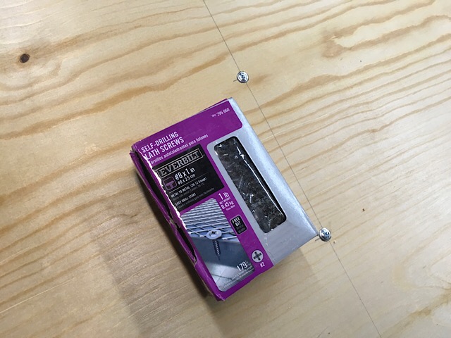

I couldn’t tolerate sitting... so I went out and skinned the front wall. I used glue and screws. The screws are called self drilling lath screws. I always thought of them as ‘finish screws’. Anyway, they are pretty neat. Nice wide, good looking head that holds well.

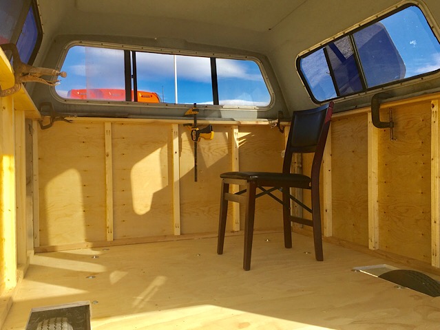

Postby NevadaBlue » Tue Oct 22, 2019 5:46 pm

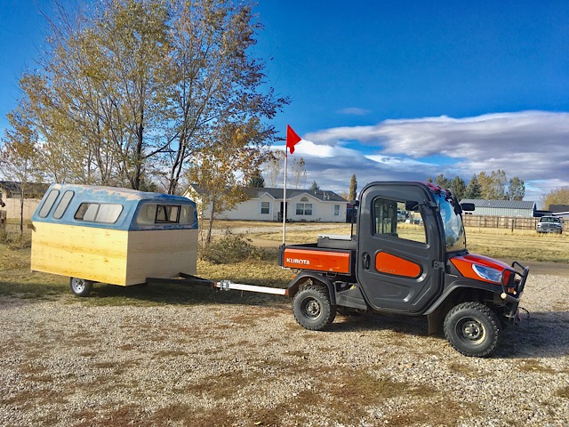

The Lazy T is alive! I got all three walls installed and then conjured up the Egyptians to help me get the HEAVY fiberglass topper onto the walls. It is perfect!
And, yes of course the tongue will be shortened a lot.
:D
I put a chair in there, one that is about as high as my bed will be. Lots of headroom. This thing is almost a stander. The bed will be a super twin mattress 39” x 80”.
Now the fun begins. Designing and building the galley and rear doors.
Also, the door and frame need to be built as well as some windows are getting replaced.
GOOD day!

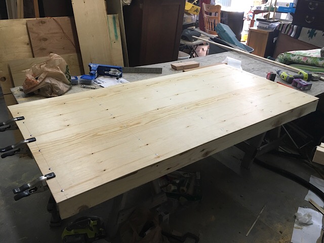

Postby NevadaBlue » Thu Oct 24, 2019 6:24 pm
I’m doing my best to get this ready for winter. The topper is bolted down at the four corners so it can’t blow away. The main structural cross member (strength for the rear of the box) is in place as is the front support for the bed. The hollow core door (the BED) was tested (16” to top of board) and I love it. No cabinets yet of course, but right now I have a 20” x 80” open floor space to wander around in, beside the bed. Love that MORE!

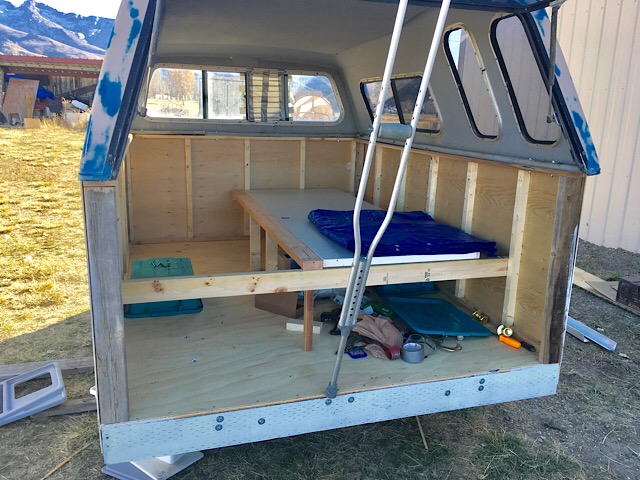

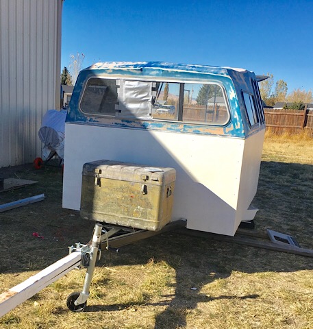

Postby NevadaBlue » Fri Oct 25, 2019 4:52 pm
I’m trying to get the Lazy T ready for bad weather. I put 3 coats of ‘primer’ (actually just 100% acrylic house paint) on the skin and taped up the missing window hole. I think I will end up cutting a piece of plywood to go across the back of the box, possibly hinging it in the middle so I can get in to work. (No main door yet). Here’s the beast with the box on the tongue in approximately the position where it will ride. Plenty of room for the battery in front of that too.
I can’t work much on the galley area since that is my only way IN right now. :? But, here is a view of my luxurious 39x80 bed.
Note the crutch holding up the hatch. It will be replaced with legs from an old EZup top, as suggested by another member. Then the crutch will become a table support somewhere.

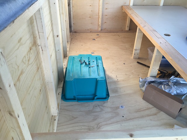

AND, another brilliant idea from a member comes to this build. Plastic boxes for wheel wells. They are there now to keep mice out, but will probably be cut down in width and used as permanent wheel wells later. Once I get the back wall closed in temporarily, the thing will be mouse and weather proof.
