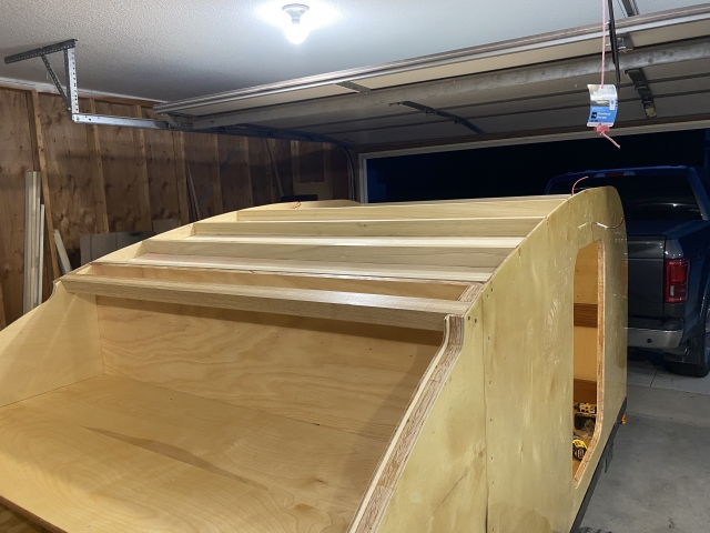

Spent the late afternoon and evening working on getting roof spars glued and screwed. I started with the rear-most spar first so that it would be a somewhat out of sight practice run with stapling the interior headliner to the spars. Both of my first two staples missed the spar and I quickly threw the stapler aside. I had a good LED light setting on the outside to help identify the spar from the inside, but I think it was too sunny of a day for it to work well.
Before I had bought the stapler, I planned on using some 3/4" long painted finish screws that I had leftover from a previous project. I reverted back to this option. In order to hit each of the spars, I used a chalk line to layout where all of the spars would sit on my headliner. I then measured out equal spacing for five screws per spar and drilled tiny pilot holes from exterior to interior. Once each spar was installed, I could drive the screw in through the pilot hole from the inside of the cabin. It well and I'm happy with the looks of it.
As a follow up to the concerns I posed earlier today about the 2-1/4" vs 2-1/8", I think it'll all work out just fine now that I've got the majority of the spars mounted. At least half of the headliner was set about 1/16" proud above the wall shelf due to the PL premium expanding, so much of my roof is pretty close to a 2" void as it is. I will likely use a combination of small 1/8" shims and thick beads of PL Premium under the roof blocking as needed in order to get a flush edge with the exterior wall sheeting.

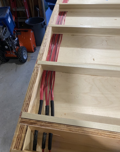

Checking off odds and ends while I wait for my 12 AWG zip cord to arrive so that I can begin wiring. I had ordered the wire well in advance, but when I finally got around to opening the box the other day, I found that I was sent 16AWG rather than the 12AWG that I had ordered.

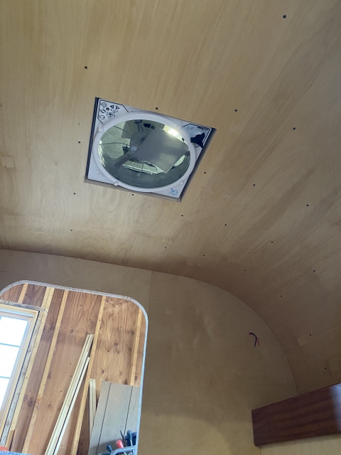

As for the roof work, I got the roof blocking glued and screwed over the weekend and was pleasantly surprised that the blocking eliminated any remaining waviness in my 1/4" lip. Once the blocking was complete, I cut the hole in the headliner for our roof vent fan and test fitted it.
I was glad that I took the time to test fit it because it made me realize I needed to add two more pieces of poplar along either side of the framing in order for the mounting screws in the flange of the fan to have something to bite into. Finding this out at the very end of the project when permanently mounting the fan would've been a major bummer.

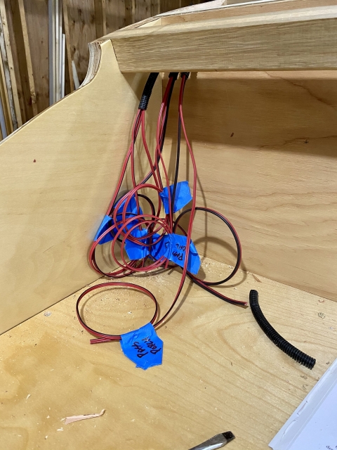

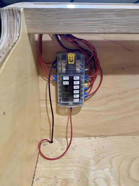

Got all of the cabin wiring ran tonight. I ended up using 16AWG for all of the lighting and 12AWG for the roof vent fan and the power outlet bank that I'm mounting to the headboard shelf.
I made a last minute decision to place my fuse box in the galley rather than at the headboard in the cabin. Part of my reasoning was that I felt that putting it here was more of a central location and would result in fewer lineal feet of wire throughout the roof. The other part of my reasoning was that I would like the option to wire in additional LED light strips and a fridge in the galley in the future without needing to run the wires now. I will likely enclose the fuse box in the same location that Tony placed his solar controller, however it won't be on display. I plan to cover it up with a small hinged or sliding access door.
As for a solar controller, we will likely purchase suitcase solar panels with the controllers integrated in them. We camp in fairly wooded areas and will need flexibility when it comes to solar panel placement.

All tied-in to the fuse box. I won't be quitting my day job to become an electrician anytime soon, however it was pretty satisfying to see my test light light up at the end of each run without any hiccups. I'll add an inline fuse between the battery and fuse box, a multimeter, tow vehicle cutoff switch and work on the galley electrical once I've framed the hatch.

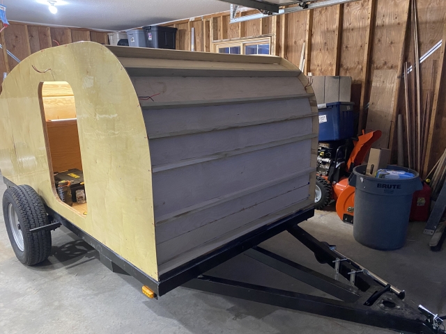

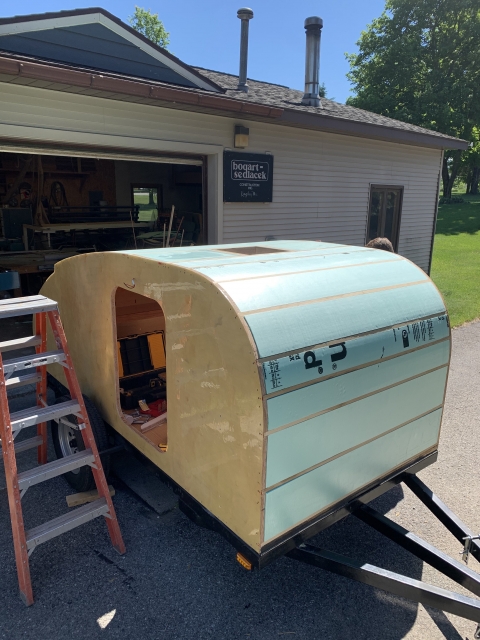

Checked some boxes today. We spent last night and this morning cutting and fitting 2" foam board for our roof insulation.
As we had to make a few angled cuts across our foam board to account for less than perfect spar spacing, it had me thinking, if I were ever to build another, I would cut the foam board to size during spar installation and use it as a guide for spar spacing.
After all of the foam was installed, my wife sanded a few high spots that we had and we were ready for the exterior roof sheathing.
We installed the exterior sheathing by laying a bead of PL premium on the top of each spar and the roof blocking. Then, we set the birch down and stapled it in place. For a little extra insurance, we added five 1" screws spaced evenly across each spar. We didn't have any major surprises during the installation process, but it definitely got a little wild at a few different moments along the way. I lost a couple years off of my life when I thought I shot a staple into our roof wiring at one point. Luckily, it was a dry fire from the stapler and all of our wires still worked when I tested them at the end of the day.
In the end, we had a few small wavy spots from the glue expanding. All things considered though, we're chalking the day up as a success.

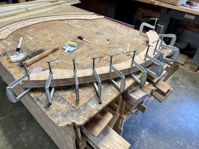

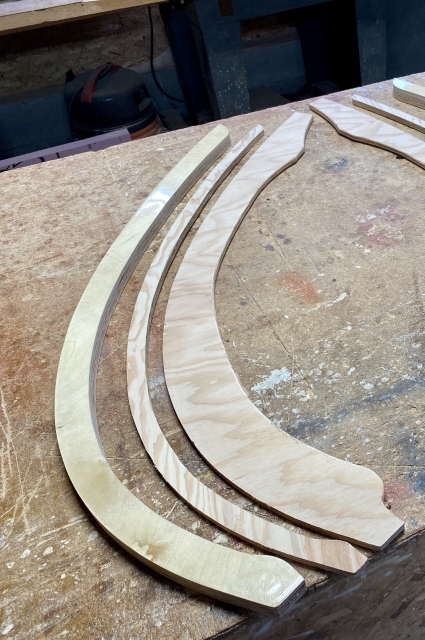

Once the templates were complete, I got the 1/2" spacers, 1/2" gussets, and the 1/2" roof blocking cut out using marine grade ply. My countertop is a little bit deeper than the plans called for, so the gusset had to be cut slightly shallower than plan. I settled with a 2-3/4" depth in the area that needs to clear the counter. Hopefully I don't regret these choices later.
My impatience persuaded me to glue up all three pieces of the hatch sides at the same time rather than gluing on one piece at a time. As long as I don't discover any hiccups when I pull the clamps off tomorrow, it all still went pretty smoothly.

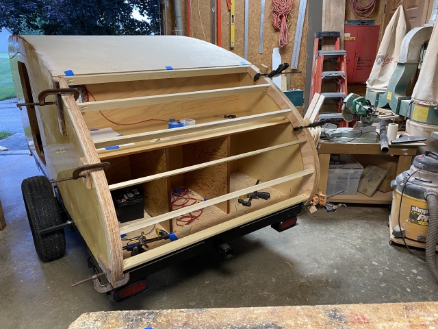

Postby GarthB » Sun Jun 27, 2021 7:38 pm
Started the day out by sanding and touching up the completed hatch sides. Thankfully, there were no surprises and they fit on both sides of the galley according to plan.
The forecast predicted morning rain followed by afternoon clouds. Instead, it rained all day long. I was close to giving up hope that I could get the 'drop down the road to the wood shop and was scratching my head as to whether I could squeeze it inside. Determined to make progress, I shifted a few things around and when there was a brief break in the weather, I got it crammed into the shop. The exhilaration that was felt racing to get it inside before it started raining again was even greater than the nerves I felt just before cutting the hatch sides off of the walls. Luckily, no rain drops landed on the teardrop.

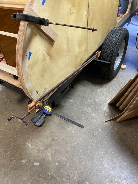

Once inside, I got the blocking for the lower strut attachment point cut out and began ripping down poplar to 2" wide. From there, I worked from top to bottom and got the hatch framed out. I took my time on this, making sure that both sides were spaced evenly. "Measure twice, cut once," was blaring in my head today after discovering that the cooler slide out tray that I rushed to get together last night was too wide for the bay.
All said and done, the framing went well. I still need to build the final spar that seals the hatch to the edge of the floor. I decided to hold off on it for today in order to do a little bit of brainstorming.
The clamping configurations that are made in order to get a perfect fit always humor me. Today, the fender bracket and a long bar clamp came in handy in order to ensure that the hatch side was just right.
