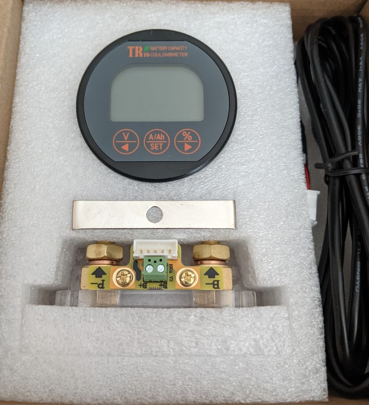

First, I did make the switch and bought the AiLi meter.
Thanks for the advice!

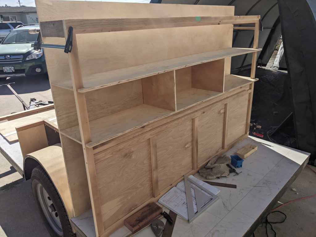

we made a major in-flight change to the back wall of the galley. We had originally planned to have that space being a storage area between the main sleeping compartment and the galley. It was big enough to house my guitar, which of course, is a comping essential. However, we realized that we were making a mistake an leaving ourselves with very little space for galley storage. So we redesigned it in Sketchup and I went to work making the modifications. We are so please at how it came out.
Galley change in progress.
Galley Change.jpg (233.93 KiB) Viewed 2594 times
New Galley design.
New Galley.jpg (155.91 KiB) Viewed 2594 times

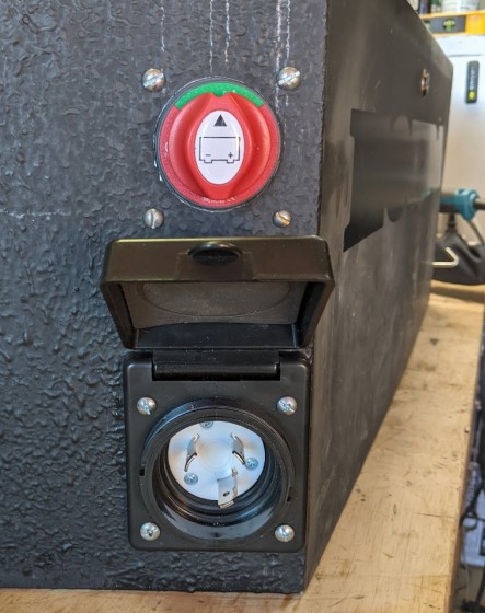

Also made a little progress on the tongue box. Added the shore power connector and emergency battery cutoff switch.
Shore and cutoff.jpg (66.36 KiB) Viewed 2594 times
I know the bolts do not match, I need to get to the hardware store and get the proper nuts and bolts. It was what I had in my misc hardware supply.

That’s not a battery cutoff switch. It turns the charging line from the tow vehicle on and off. It’s only been on once and that was to test it. No sense charging my AGM at the wrong voltage unless it’s really needed.

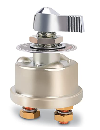

[/quote]That’s not a battery cutoff switch. It turns the charging line from the tow vehicle on and off. It’s only been on once and that was to test it. No sense charging my AGM at the wrong voltage unless it’s really needed.[/quote]

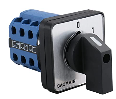

Have I made an error? :( My intention was to use that as a switch to isolate the battery from the main bus and cut off the power from the entire trailer.
I already have a charge selector switch. This one:
Changeover swithc.png (120.9 KiB) Viewed 2575 times
This was the first disconnect switch that I purchased (and still have).
Battery Cutoff.png (102.12 KiB) Viewed 2575 times
What is the difference? I could use the first one purchase (in picture) but it would require some sheet metal work to cover the 2" hole I cut in my tongue box. :frightened:

Postby tony.latham » Sat Jan 28, 2023 4:20 pm
Mine turns off the charging juice from the tow vehicle. A main battery cutoff is a good idea. I've got one near my battery.
Re: The Tiny Tillson Teardrop Trailer (T4)
Postby BLTillson » Sat Jan 28, 2023 6:23 pm
Mine turns off the charging juice from the tow vehicle. A main battery cutoff is a good idea. I've got one near my battery. Tony
I wanted to have a way to make sure that no power was being used to keep the battery from slowly draining. Also for safety. 8)

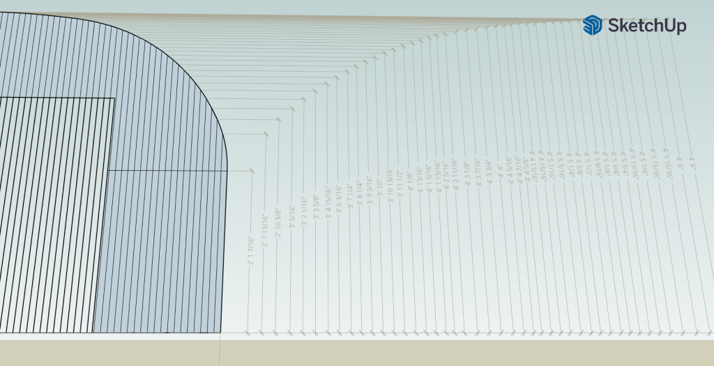

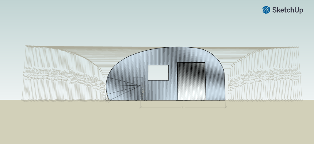

Working on the walls finally. Have you ever done one of those things where you asked yourself, "Are you Shure there is not an easier way to do this?" Well, it will work but it's a lot of work.
Please spare me any clever ways to do it faster and easier since I have already sunk hors into it. 8)
T4 - Wall Template.png (141.74 KiB) Viewed 2527 times
T4 - Wall Template close.png (208.63 KiB) Viewed 2527 times

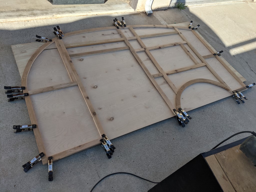

Postby BLTillson » Wed Feb 08, 2023 8:39 pm
Super excited to have the first wall almost ready for assembly. Praying that all my calculations are wise ones. :worship:
The first wall.jpg (185.28 KiB) Viewed 2485 times

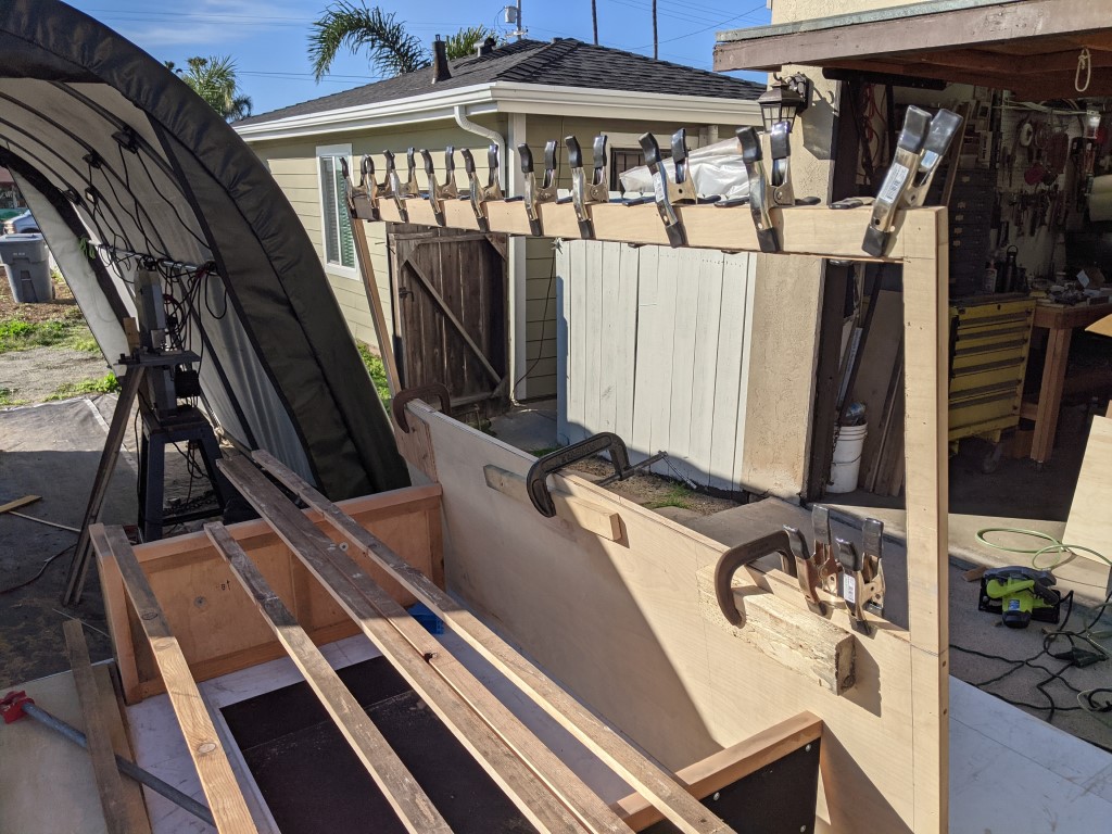

Postby BLTillson » Fri Feb 10, 2023 12:54 pm

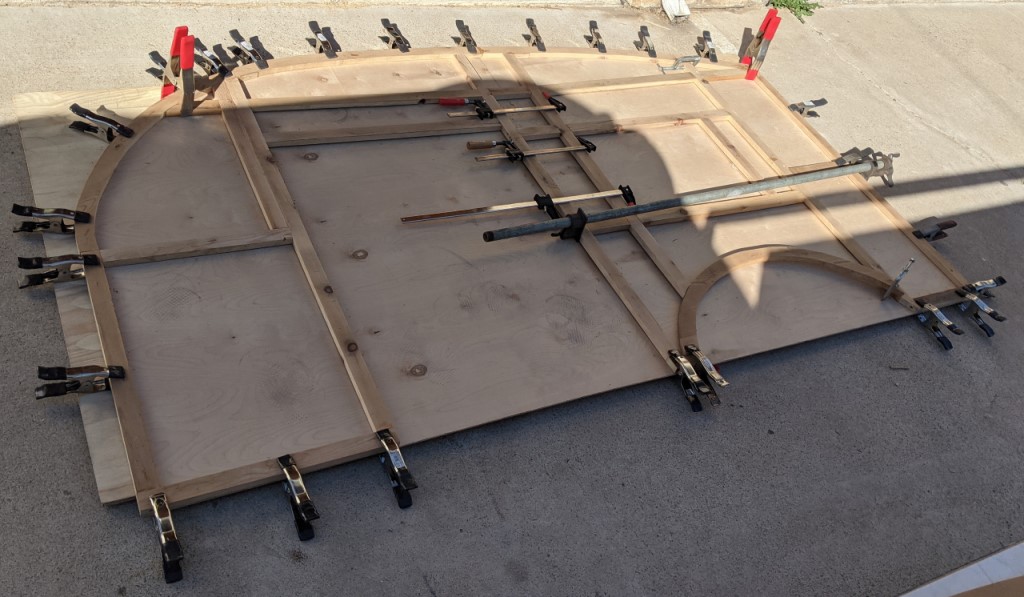

The first wall frame has been glued and screwed. It was way more work that I expected. The wood I am using for framing was donated by my step-father. It was in his garage for 30 years. Its cut from 1 x 12 x 16 boards. It is very dry but not too dry. So I did have a few screwing accidents that caused splitting. I then had to replace those pieces.
So anyway. Here is the glued up wall. Next will be checking the fit and then putting the inside skin on it.
Wall frame glued.jpg (141.62 KiB) Viewed 2456 times
NOTE: To all future teardrop builders, buy lots of squeeze clamps! :thumbsup:

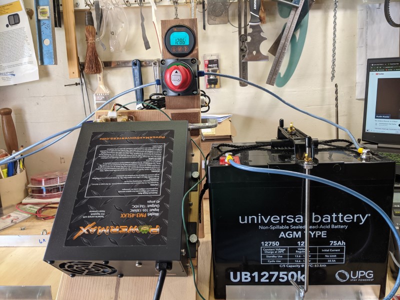

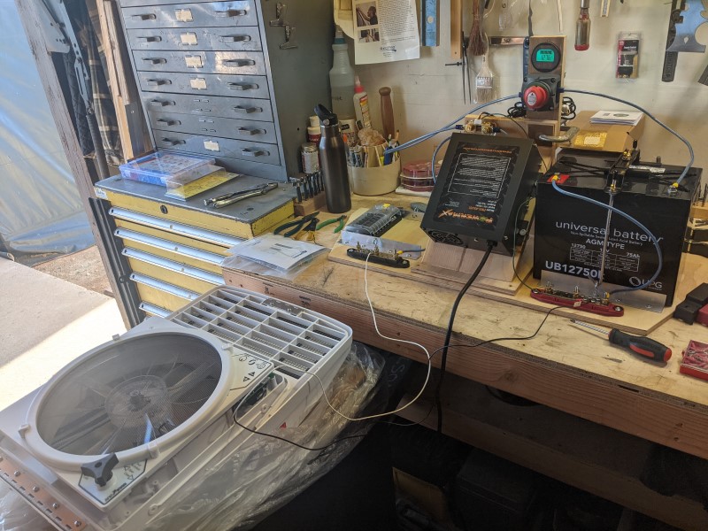

The electrical is coming together both in understanding and in construction. I mounted the battery and converter along with my meter and the cutoff switch for some bench testing.
Bench test electrical.jpg (149.43 KiB) Viewed 2395 times
Also tested the vent fan and made sure that it met the approval of my wife. (it passed with flying colors) :thumbsup:
Bench testing fan.jpg (144.73 KiB) Viewed 2395 times
