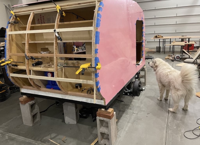

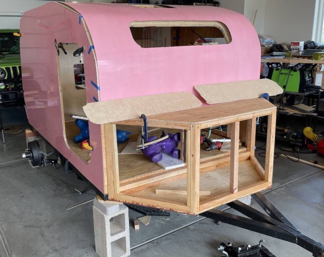

some small progress, started on exterior skins:
I bought a 1/16 aluminum diamond sheet. I intend to wrap around the bottom of the entire body with 12" diamond plate, since it's thin 1/16, it's for cosmetics only. I still haven't figured out the best method to attach the plate. I'm thinking of double sided high bond tape, so I can avoid drilling holes. Any suggestions?
Thanks a lot!

Postby Onajourney » Thu Mar 09, 2023 8:15 pm
PL3 and done.

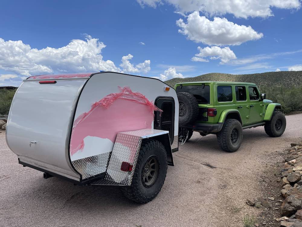

Getting close now :)
skin dry fit:
My Great Pyrenees doesn't know how she can fit in, i have no answer either. We didn't have her when I started the build :D My challenge is we already have a Irish Setter. We'll see ...

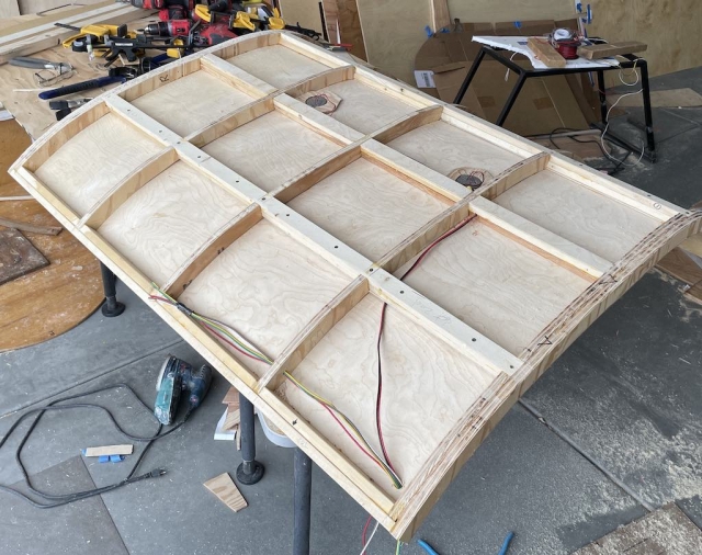

hatch build
I got a question about the trim, when screwing the bottom trim to the ply, do i also screw in the aluminum skin or should I cut ~1/2 inch off the bottom of the aluminum, so bottom edge will sit on the screws and the alum skin can float, instead of pinned to the ply? I suppose it makes more sense to screw the aluminum in, but I see people doing both ways. Any theories?
Thanks in advance!

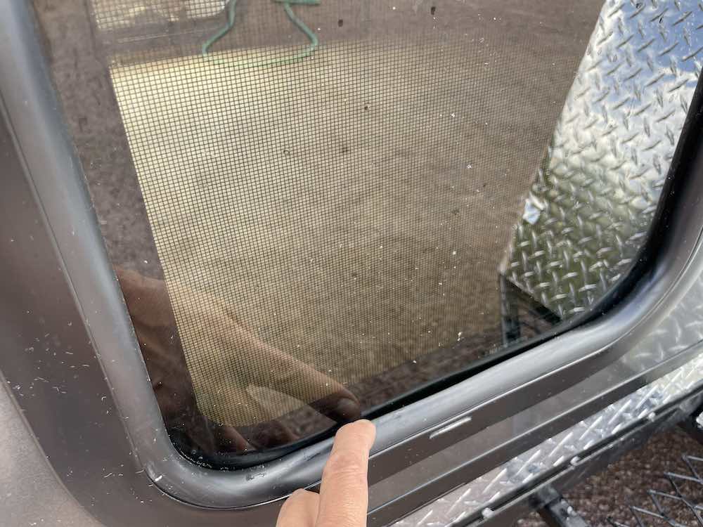

I pulled the teardrop out of the garage for the first time yesterday. There is leaks :(
My hatch door has leaks, i'm working on the seal now.
However, both doors from Vintage technology leak like crazy. I noticed the rubber seal has big gaps, the seal doesn't hug the glass, i can nearly stick my fingers into the gaps, The weeping hole doesn't help much, the gaps are so big, water just pours in,
looks like I'm not alone: viewtopic.php?f=21&t=75018&p=1294549&hilit=vintage+door+leak#p1294549
https://www.youtube.com/watch?v=42DEQB1ORzw
https://www.youtube.com/watch?v=RxKTDV4WLwQ
In the last video, he "fixed" it by adding a barrier inside the door. But I think that blocks the window screen. Any other suggestions? I'm so disappointed, two doors cost a grand, such poor quality.
Thanks!
