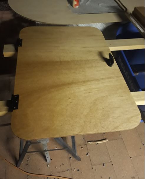

Postby MickinOz » Tue Nov 16, 2021 6:10 am
Today I put one door on its corresponding wall. Used this to work out the T-handle position.
Figured t out drilled an 11mm hole for the square rod to go through, fitted the handle.
Tried it out.
Beautiful.
Took it apart.
Drilled the other door.
Sanded.
Sealed with mix.
I'm biased, of course, but I do think the black door hardware looks OK on the clear finished hardwood.

Postby celadon » Tue Nov 16, 2021 12:17 pm
MickinOz wrote:I'm biased, of course, but I do think the black door hardware looks OK on the clear finished hardwood.
It's lovely!

Postby pchast » Tue Nov 16, 2021 10:56 pm
Nice contrast.

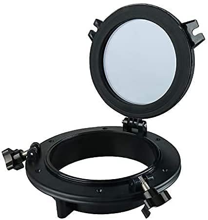

My windows arrived today.
I wanted small ones to fit in the doors. Not easy to find and hundreds of dollars each.
So I got these.
$112 for a pair. Of course they are now $95 a pair.
10 inch portholes.
The missus says they are cool.
I will mount them so the glass opens inward, as they have a drain in them that will the face out.
They are meant for about a 30mm wall thickness.
2 choices - trim 'em down to suit my 12mm door, or machine a collar.
I'll ponder that a while.

Postby swoody126 » Tue Nov 23, 2021 8:54 am
those are COOL !
once you have located and drilled your fastener holes AND dry fitted remove them and tape/hold a piece of fabric mosquito netting/screen over the opening and carefully replace the port in the hole for fying/crawing critter protection
if using some form of water seal use the tape kind so when you need to replace the screen the ports won't be glued in place
LINK PLEASE
sw

Postby MickinOz » Tue Nov 23, 2021 3:33 pm
Yeah mate, the plan is to do exactly that - once she's set up, lay some insect screen under the outside trim ring and screw it back down.
One thing I have discovered since I've been using Ol' #1 regularly - I cannot leave the door open for even seconds without insects zooming into the cabin. And that's in winter time! Summer will be fun.
The only complaint I have is that the drain channel is opposite the hinge, so to put the drain channel down the bottom, the hinge will have to be up the top. I'd rather it swung sideways rather than up, but I guess I can figure out a retaining mechanism.
I got 'em off amazon. There are lots of ads. Mine came from Yaemarine. They cost $57 Australian each, delivered.
You will be able to buy a pair for $49 US
https://www.amazon.com/Amarine-Made-Por ... OME_MIRROR
https://www.amazon.com.au/Amarine-Made- ... 77&sr=8-33

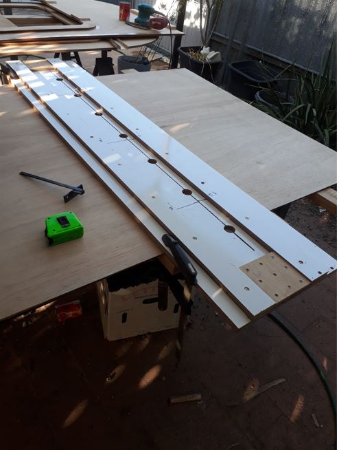

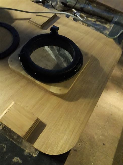

Postby MickinOz » Sun Nov 28, 2021 3:56 am
Rain has gone away for about 4 days according to the Met Office.
I haven't been totally in hibernation.
Got the portholes set up, ready to screw in once the doors are mounted.
Made a saw track. Nice straight cuts.
Inspiration came from here.
https://www.youtube.com/watch?v=H0BZLbW1lvQ

MickinOz
Posts: 1305
Re: Now the fun starts
Postby swoody126 » Sun Nov 28, 2021 9:31 am
MickinOz, thatsa GREAT LINK
just so simple it had plumb evaded me :thumbsup:
sw

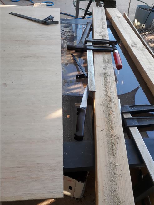

Postby MickinOz » Sun Nov 28, 2021 4:28 pm
HaHa. Plumb. Good one. :thumbsup:
Yeah I always wanted one of those fancy pants aluminium saw tracks, but when I found them for sale, they were model/brand specific, mostly for plunge saws, and quite spendy.
I was looking on Youtube for videos on how they actually work when I came across a multitude of DIY vids.
This guy's attracted me because aluminium extrusion options are not super diverse up here in the sticks, and aren't cheap.
At the same time I was looking at the videos, a bloke advertised some melamine coated 16mm MDF shelving on Facebook for $7 a piece. Delivered.
I will rework this a bit. I don't think I need those sight holes, for example. I have only done two cuts, but I found it was just as easy to work out how much to subtract from the desired measurement and just measure to the edge of the track.
Also, my stop blocks, the plywood bits at the end, could stand to be about one row of screws narrower. It's just a tiny bit fiddly getting a 1220mm/48 inch cut done.
OK for a metric sheet (1200mm)
Some glue sandpaper on the underside to give it grip, then cut without clamping it down. Dunno about that.
See the skinning knife on the table? Ran that down the side of the guide to score the plywood I was cutting. Practically eliminated splintering. Really only splinters at the sight holes anyway, presumably that is why he fits plexiglas inserts in a later video..
Planning to make one for the jigsaw, too.
