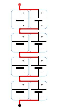

I have 8 cells in my 400A-Hr, 2P4S battery pile and I guesstimated the fault current at around 9,600A. The MRBF is rated for 10,000A so it should work for my battery. I can speak from multiple experiences that the MRBF will safely interrupt a fault from fat fingering a wrench while working on the battery hot. I would have gone with a class T, which is rated for 200,000A if I had a bigger battery.

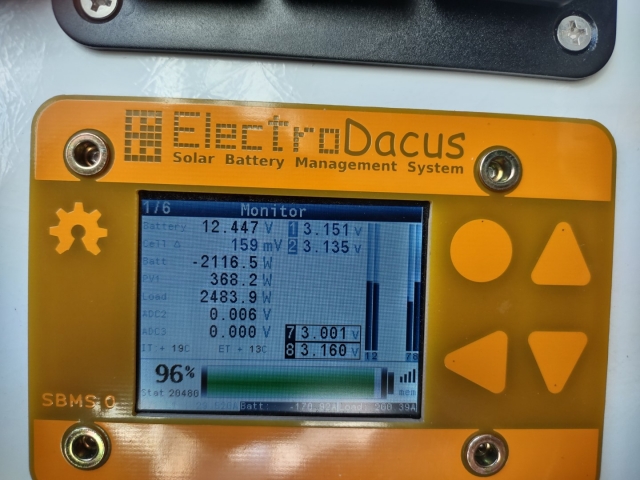

While I was doing my mega capacity test at 2500W I noticed my cell voltages were way out of balance:
159mV difference in voltage between the lowest and highest cell voltages at 96% battery State Of Charge (SOC) is way to much. I had read somewhere that 100mV difference at 20% SOC is fairly typical. The battery BMS was going to disconnect the battery too early when the lowest voltage cell hits the minimum recommended voltage way before the other cells. That limits the entire battery capacity to the lowest voltage cell capacity, islanding some of the battery capacity. I had carefully top balanced the cells so I wasn't sure what was going on or what to do. The BMS cell balancer wasn't doing much to balance them, the cells would be 10mV difference at 100% SOC and then immediately go wacky when I ran the inverter. I thought maybe a cell had gone bad, did I need a new one? The vendor said they matched the cell impedances when I bought them, did they really do that? Should I top balance the batteries again? Maybe the BMS voltage sensing was off? I'm running a 2P4S battery so there are two cells in parallel and four in series.

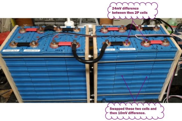

On a hunch, I swapped a couple of the cells between the lowest and the highest group. Cells 7 and 8 in the photo above. I had done this before when I did the initial top balance and noticed a couple of the cells way out of balance:

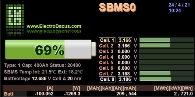

I ran a 25% capacity load test today at 0.25C (100A or 1,200W for an hour). It looks that this solved the problem as the cells were only 20mV apart at 69% SOC and under the 100A load:

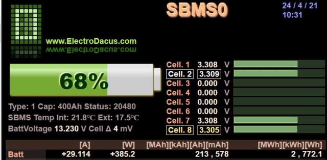

They bounced back to 4mV difference when I shut the load off and started the PV chargers. :thumbsup:
I don't know if I had connected the two worst impedance cells in parallel or if the pack was just out of top balance. I'll keep my eye on the cell voltages but it looks like the cell swap did the trick. I'll do a top balance next if I have more issues as now I don't think any of the cells are bad.
