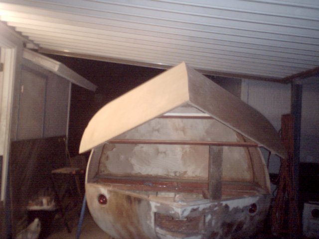

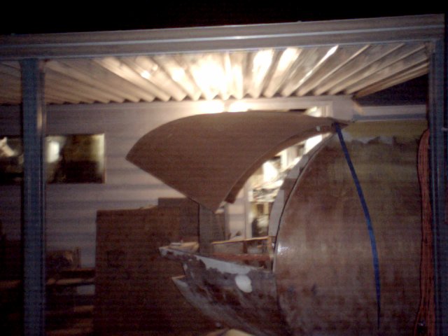

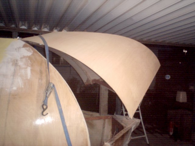

Postby del » Sat Oct 27, 2007 12:14 am
I studied this pic.
The hook at the end needs to hook the distance of the interior brace. The shape of the curve is determined by the distance between the pin and the edge of the body, This means it sticks in the same distance, as it is long. Here is my model.
I made it out of scrap wood, and the hook is not fully developed. The welding of the hinge will be another day, but I believe I have found the solution, thanks folks.
I cut the four ribs Holding the hatch closed.
It will open farther, but I was to lazy to find a longer prop. The blue strap is now removed, should have removed it for the pic.
del

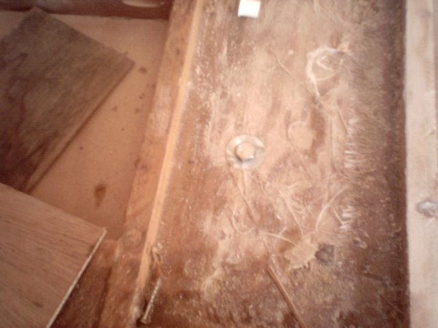

Postby del » Sun Oct 28, 2007 12:39 pm
I put sealer in the body mount bolts, and installed jam nuts. Later I realized how far the bolts sucked into the wood. Should I be concerned?
del
