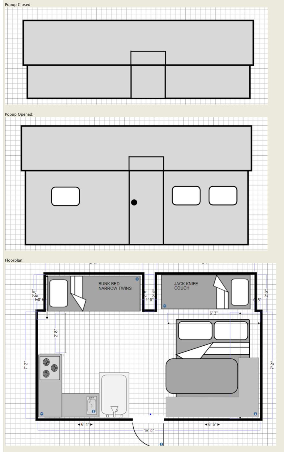

Postby iconicflux » Thu Feb 18, 2021 8:48 am
Thanks! I totally agree with not using your specific design. I'm more just wanting to understand the mechanics of it so I can evaluate what works for mine.
For example, I'm certain that I'll have far more roof weight than you both because I'll be suspending a heavy object from the ceiling and because my ceiling design goes over the bottom walls to significantly lower the overall height. I'd like to do the folding walls like you but when I began looking at how to construct them given my desire to have slideouts I'm not not sure it'd work well with folding walls and I'd kind of like the top to cover the windows when we're traveling. If it were up to me, I'd make the slide-outs into fold outs instead but my wife seems to be interested in using what has worked for other people and she doesn't want to have to move the bunkbeds around.
This is kind of what I'm thinking of:
Screen Shot 2021-02-18 at 7.59.59 AM copy 2.png (215.4 KiB) Viewed 2590 times
I'll probably redo the pulley system that's in place on mine and add some kind of hand crank like Andrew showed in his picture. I'd make it electric but the only safe way I can figure that might work is if I used stepper motors for driving the lead screw since they can sense when there's a problem and be programmed to stop. If you used an electric winch it would be far too easy to accidentally damage the lift system via someone not stopping it when they should and thus tear out pulleys, cables, or termination points for the cables. Barring a way to do that safely, I'll probably make it manual via lead/ball screw or cable winch.
On a different note, are the stringers between your foam pieces plywood or are they dimensional lumber? I seem to recall you saying in the threads they're plywood?
Thanks,
