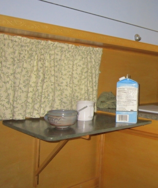

Among the first updates, was to make some of the bed platforms do dual duty. The smallest foot board becomes extra, removable counter space which also doubles as a nice breakfast table for one, while sitting on the edge of the stationary portion of the bed.
The center bed section was fitted with 3 screw-on legs so it can be used as a table. While narrow, the other center bed section, seen in the background, can be used as a side table, with or without the center table, for ones drinks or whatever.

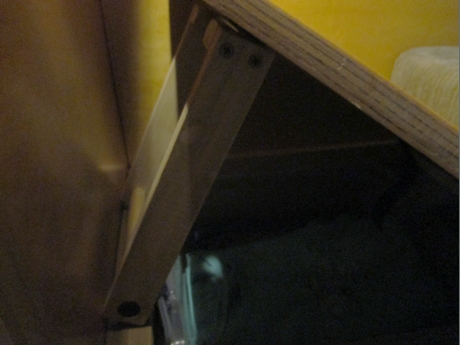

Reclining back support for reading comfort
The back portion of the stationary bed platform is hinged; so, I took advantage of that by making a simple prop to recline the head portion of the bed for reading.

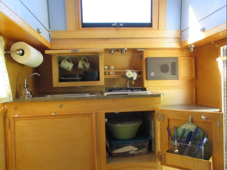

Most everyone has cabinet wall or door space available and some of the following pictures give ideas for using that.
In this galley picture, you can see that I not only added a paper towel holder but also a dish cupboard, small shelf, and a flatware holder, made from leftover wood scraps. The clear plastic flatware holder can be removed from the box on the cabinet door and transported to a picnic table.

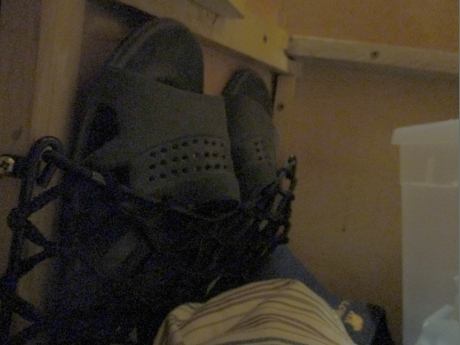

On the inside wall of each bed/bench platform, a purchased stretchy holder was added to hold shower sandals.

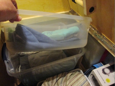

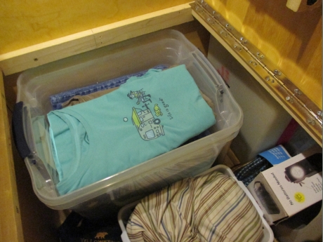

Tubs and sacks also make organizing easy.
Nesting Rubbermaid tubs hold jeans, shirts, etc. Storing the heavier and less used things in the bottom tub and the T-shirts in the top tub helps keep things from wrinkling and keeps the most often selected clothing on top.

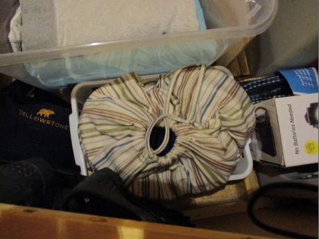

Underwear is stored in a draw-string bag, making it easy to pull out but hidden from view when someone wants to see the storage area.
