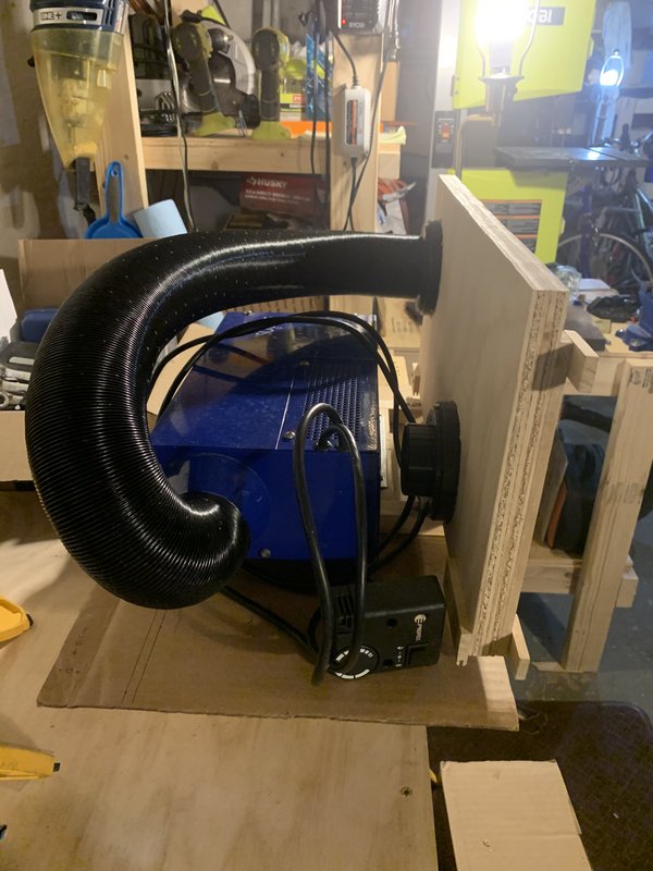

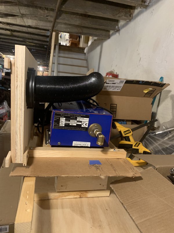

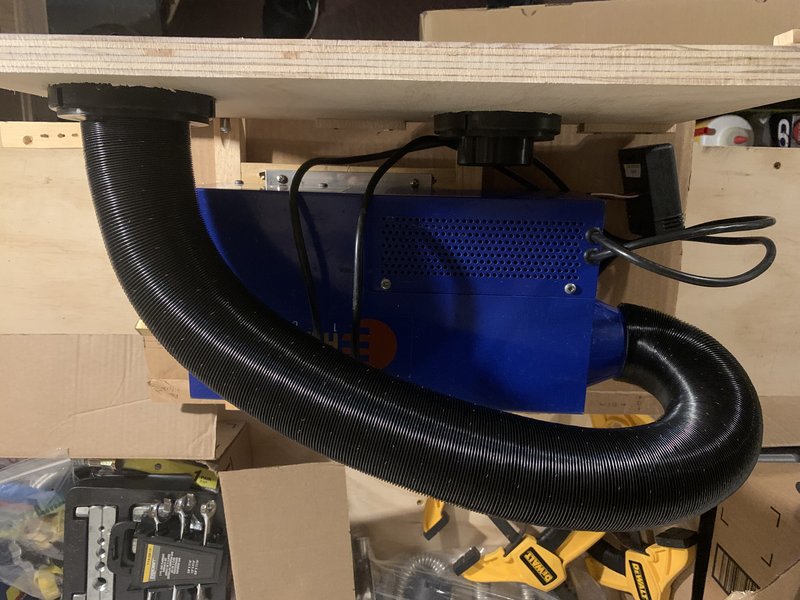

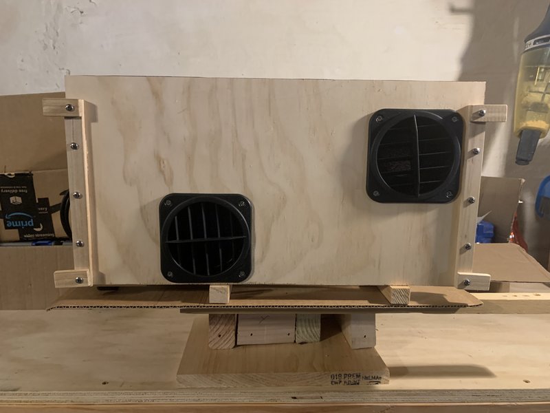

Made a little progress today on the heater project, along with painting the tank.
The Propex will be installed in the cubby on the right hand side in this picture.
Here is another view from an earlier time in the trailer’s life, but that shows the cubby very well. The thermostat will go on the closet wall above, near the light switches.
Today I made a cubby door with vents in it. The top and bottom of the door brace against the back of the cubby opening, and the tabs on the corners will clamp it in place. The lower left vent is the cold air intake, and the upper right vent is the hot air outlet. The cold air is collected from under the bed, and the hot air shoots out between the foot of the bed and the door.
Top view. Rear of trailer is to the left.
Rear view. The cardboard cutout is standing in for the cubby floor.
Front view. You can see the inlet vent feeds the heater’s intake (panel with holes in it on two sides).
