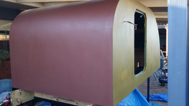

Re: Ok here we go...PMF!
Postby dales133 » Wed Oct 14, 2015 3:30 am
Your welcome bud.
Got the roof canvas finish painted ready for aluminium and 1 coat on the now finished passenger side.
Had a bit if a bubble issue and a hand print on the drivers side so i had to give it another coat to.
Tomorrow i hope to have the sides finish painted and get the roof aluminium and trim on.
Might be a bit ambitious but ill try.

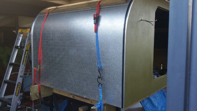

Postby dales133 » Thu Oct 15, 2015 2:07 am

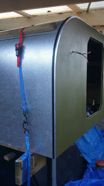

Postby noseoil » Thu Oct 15, 2015 7:00 am
Looking really good now. How thick (thin) is your aluminum? I like the pebble finish, should be easy to maintain. :)
137905
noseoil
Posts: 1822
Images: 670
Postby dales133 » Thu Oct 15, 2015 7:07 am
Its thick,1.2mm but i picked up 5 sheets of it for 80 bucks back when i started the build...verry cheap.
I dont overly like it but it suits the retro theme and was used widly on caravans here in the 50s and 60s so its got some nostelgia.
Wasnt that easy to bend around the front corner though.
Im happy with the edge trim though,introduces some black to tie the doors in
