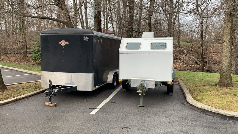

Postby lfhoward » Sat Jan 02, 2021 6:35 pm
Today was the day I mounted the VW propane tank.
When I got to the trailer, it had a buddy.
The Superstrut could only fit between the frame rails in 3 foot sections, so they had to be joined together once in place. They formed very sturdy brackets to attach the tank to, and were fastened to the frame rails with heavy duty beam clamps (similar to how the military flat bed is attached to the frame rails).
This older photo shows how the tank is fastened to the Superstrut.
The tank looks like it was made to fit right there. It’s solid and doesn’t move at all now that it’s installed.
It’s tucked under the front and side so that nothing sticks out or hangs down too low.
The regulator is capped off until I can install the heater and run the gas line. My gas sniffer verified no leaks at this point even with the valve set to open.
Between the valve and the regulator is a tee leading to a Coleman-1 lb bottle style connector, so it would be easy to hook up our camping stove via an extension hose. That connector also gives us the option of running our Propex heater from an auxiliary tank if we were to run out of gas in the main tank.
