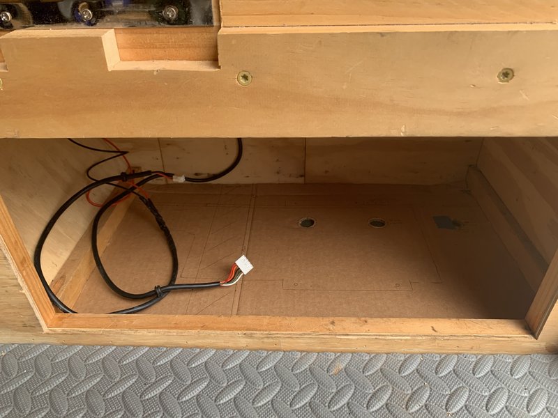

Today I ran the electrical lines for the Propex in preparation for installing the unit.
The thermostat is installed. The controls you see, from the top down are: Propex thermostat, Inverter on/off, solar charge controller/battery readout, and dome & porch light switches.

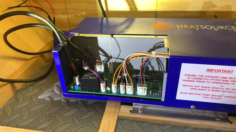

Below in the heater cubby, the thermostat and 12V power pigtails are ready to be connected to the heater. The cardboard template for the heater is inside on the floor.
I had to remove the plastic pigtail to run the wiring through tight spaces. I took this photo so I could put the five wires back into their correct locations.
And finally, I got the cubby door to fit and fasten in place. The left vent is for cold air intake (will be under the bed), and the right vent is for heat.
The hard part comes on Wednesday: drilling holes in my perfectly good floor to install the Propex!

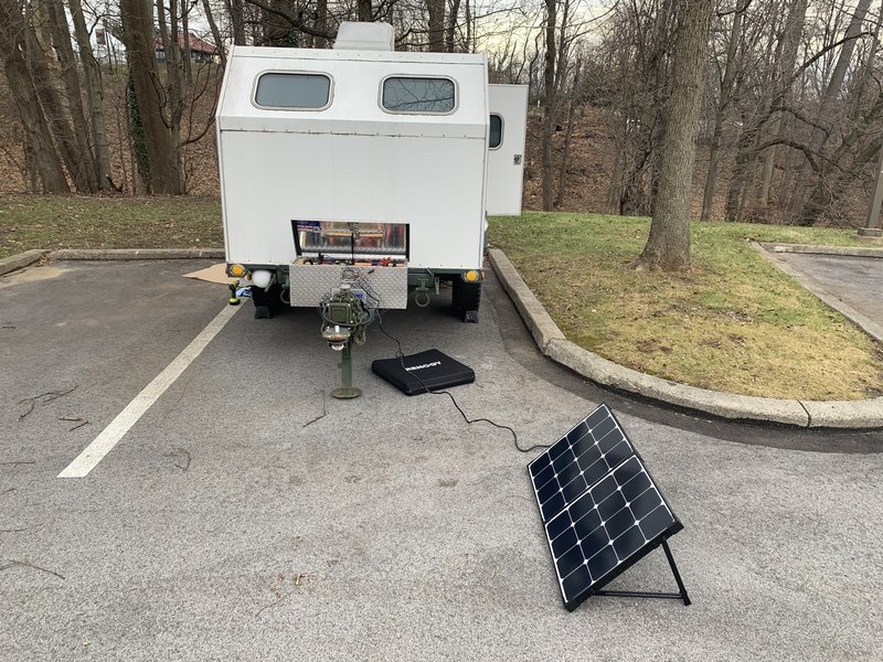

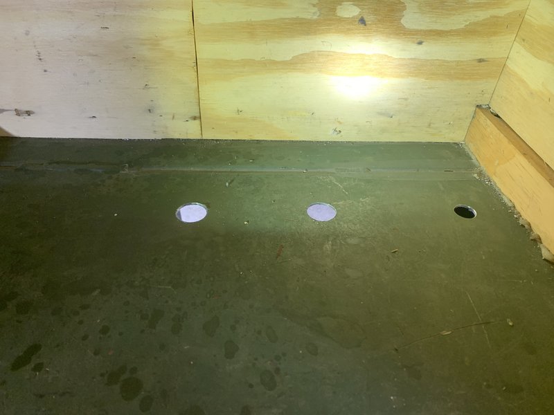

I was back at it today working on installing the Propex heater. It was very cloudy so I hooked up my auxiliary solar to try to get a little more power to recharge my drill batteries.
Last time I had installed the electrical but nothing else yet. I began today by putting the cardboard template in the cubby to help me know where to drill.

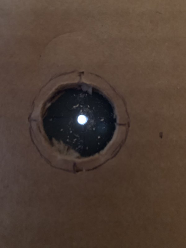

I started with small pilot holes to make sure everything was lined up. I’m glad I did, as one hole was 1/8” off and I had to redrill it.

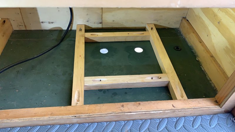

Next I drilled out the holes for real. This is after cleaning up all the metal shards and the cutting oil. Then I zapped the bare metal edges with Rustoleum.
The next step was to install the wooden frame that the heater will screw down to.
The Propex can be fastened directly to the floor but I wanted room for insulation. The larger hole in the insulation corresponds to the exhaust pipe, which can get hot. I don’t want it touching anything that can burn.

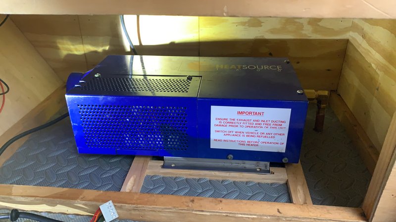

Here is the Propex in place on the frame.

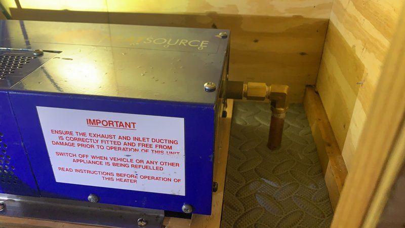

Attaching the electrical. It is very important to make sure the thermostat pigtail is connected before the power is connected. If not, a main fuse on the circuit board will blow and need to be replaced. After connecting the power I verified the unit can run its fan.
The gas connection. I used PTFE goop on the threads that is rated for propane and will completely seal the connections.
Underneath. Closest to the camera is the gas line, then the combustion inlet and the combustion outlet. The pipes still stick out 5/8” below the floor, so there is plenty of room to attach the intake tube and exhaust pipe.
While the seal around the gas line is with a rubber grommet, the seals around the intake and exhaust will be with this high heat silicone. I will do this step next time, as I ran out of daylight today.
