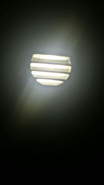

What sort of galley lights did you use?
So far ive got one on the hatch and one under the first shelf (yet to be fitted )
They are infared sensor switched so you just pass your hand underneath them at about 50mm to turn them on.
Ive got one as my main cabin light too.
http://www.hybralec.com.au/store/produc ... -20cm.html.
Ive got 2 300 series for hatch and cabin and a 400 undershelf.

Lights seem bright enough.

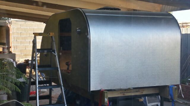

Postby dales133 » Sat Oct 17, 2015 3:01 pm
That was the last pic i ment to add,
Been up all night watching rugby!

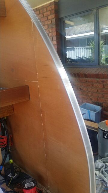

Postby dales133 » Sat Oct 17, 2015 10:46 pm

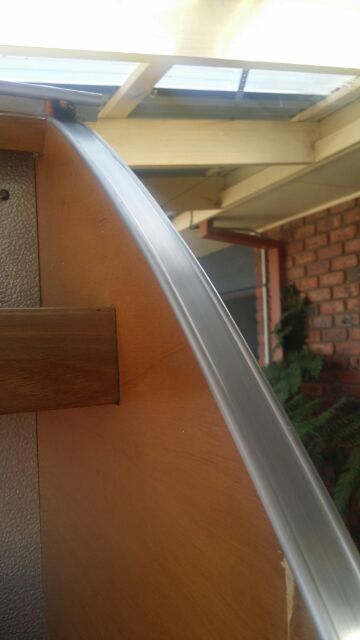

Havnt done much today but ive just started installing the galley edge trim.

Postby rebapuck » Sun Oct 18, 2015 11:36 pm
Looks smooth.

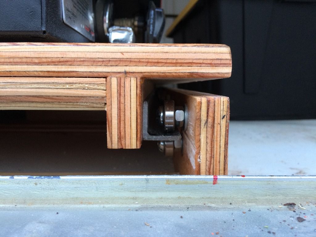

Got some rollerskate wheel bearings on ebay tonight to make some draw slides for the back.
Anyone here done this?

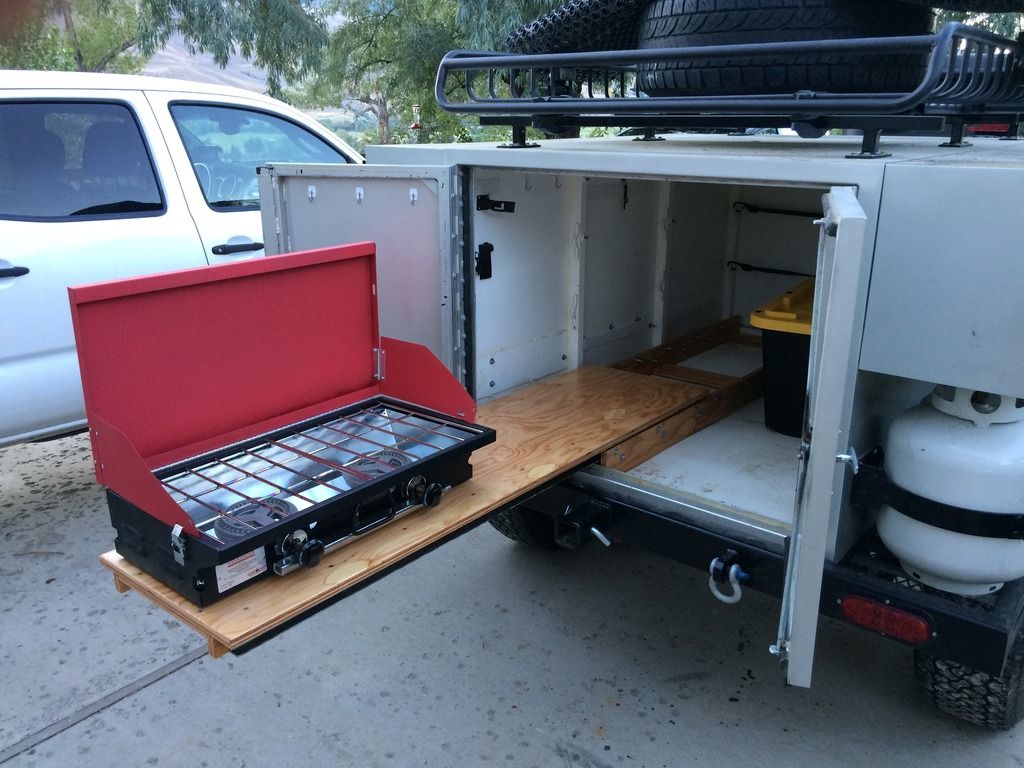

Postby tony.latham » Tue Oct 20, 2015 11:34 am
dales133 wrote:Cheers mate.
I built this 5' slide for my neighbor using skateboard bearings. Obviously it's critical to get the right distance between the bearings. I made a marking jig out of scrap aluminum and it went fine.
