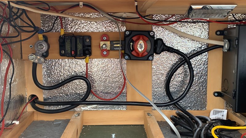

Time for a little electrical detour.
With the heater and propane tank installed, I realized that the electrical systems in my trailer we no longer floating. In other words, the heater/tank combo joined the negative ground of the DC system to the chassis where before there was no connection. I figured I needed to do something about that, so I started this thread:
http://www.tnttt.com/viewtopic.php?f=30&t=73359&p=1272006#p1271903
The conclusion there was I needed to ground the electrical system to the chassis using a more robust wire than the 16 gauge that fed the heater. I decided to ground the inverter to the chassis also, just to be on the safe side. That should have probably been done before.
Here is how things have looked for 5 years:
First I decided to install a main cutoff switch, because I thought it would be quicker and safer than always disconnecting the battery terminals when I needed to work on something.
Next I installed a ground screw through the metal floor. (After drilling holes for the heater, drilling this hole through the floor didn’t freak me out at all, lol.) The yellow 10 gauge ground is for the 12VDC system and the blue zero gauge ground is for the 1000 watt inverter.
Here is the system put back together. I taped around the positive leads to prevent accidental short circuits.
So in conclusion, the chassis is now negative grounded, just like on an automobile. Interestingly enough, the aluminum skin has electrical continuity with the chassis and the negative battery terminal also, just like the body of a car.
