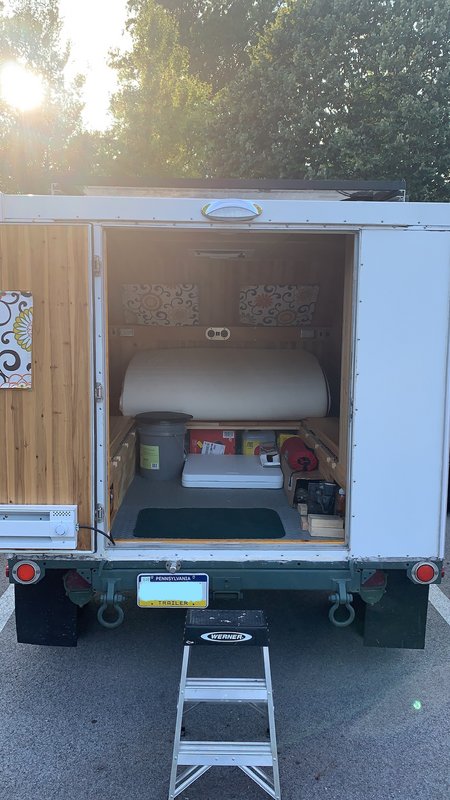

Some acquisitions for boondocking have arrived!
On the left is an airtight bucket for packing out wag bags of poo! On the right are four, 4-gallon aquatainers for water. Three will stow under the bed in the rear of the trailer (also helping to balance out some excessive battery weight on the tongue). The fourth can go on the bench to the left of the entry door.
Since there would be five wasted inches between the in-use aquatainer and the shelf above, I designed a removable dry sink to go underneath. This can catch any drips, but also can be used to wash hands, faces, etc. before bed.
The removable sink is a 9 cup Rubbermaid container. Waste water can be tossed in the morning.

Postby lfhoward » Thu Jan 28, 2021 8:52 pm
featherliteCT1 wrote:I really like that removable dry sink! :thumbsup:
Thanks Featherlite! :)
The aquatainer idea is in response to our larger 7 gallon water container freezing during our last winter camping trip. The large water container was in the kitchen side tent because it is too big and unwieldy to be put inside the trailer. The vent on it drips if you tip it sideways. After 24 hours sitting outside at 15°F, it was not usable. Since these smaller 4 gallon units can be inside the heated trailer, we will have water no matter how cold it gets.

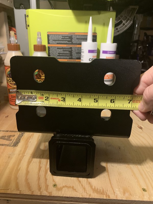

A trailer build is never truly “done,” right? Here is my next mod.
I am thinking ahead towards spring when I want to be able to bring our bikes with us on camping trips. Putting them inside the trailer introduces dirt and chain oil into the living area, so I want a hitch on the rear of the trailer for my bike rack.
This receiver is built for a Toyota FJ Cruiser by a company called LOD and sold through BumperSuperstore.com. It’s made out of 1/4” thick steel and is beefy. It should bolt right up to the steel crossmember on the rear of my M116A3. I’ll test fit it in a future post and figure out if I need to make any spacers or backing plates.
I like this receiver unit because it’s no frills and bolts directly to a beam both on the horizontal and vertical axis. Few stock receiver hitches are set up this way, except the 4Runner. This is a cleaner install than that would have been, and the receiver itself is tucked underneath so I won’t hit my leg on it while walking past the rear of the trailer with the bike rack off.
P.S. A couple more thoughts on this receiver.
This receiver ought to be strong enough for my HitchHaul hitch basket also, which is great for my work as a forest ecologist. I can fasten my chain saw and a gas can to the hitch basket with ratchet straps, keeping dirt and gas fumes out of the living area. I had been traveling with those items fastened to the Jeep’s roof rack when pulling the trailer, which works but is not convenient. This mod will make it easier to transport the saw and gas at the same time as towing the trailer.
The receiver will likely be bolted to the beam to the right side of the central landing leg, which stabilizes the trailer when parked. I don’t need this hitch to tow with (and it would be crazy and illegal to tow a trailer with a trailer anyway), so I don’t care if it’s not located dead center on the back bumper. The trailer is wide enough that the bikes and basket will not care.
