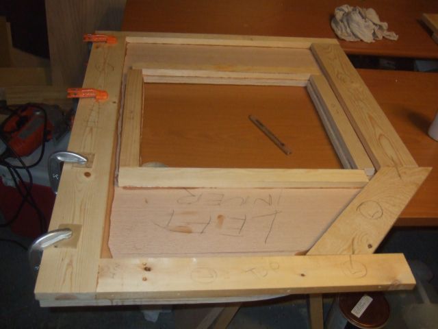

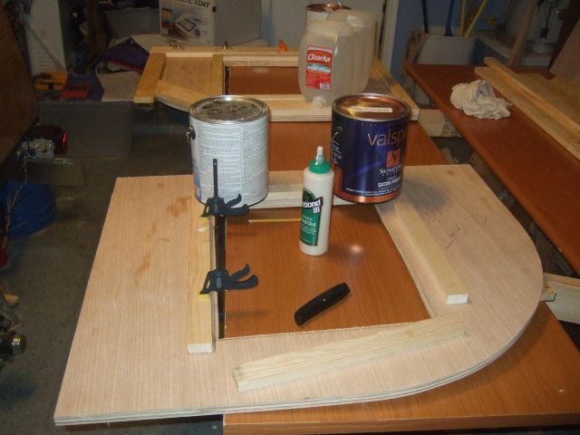

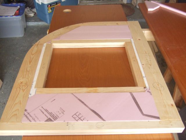

I'm framing the door with 1x to give some meat for the hinges, lock and window frame. Hi-tech gravity clamps from Valspar were very helpful.
Just about ready to trim. The glue is still drying on the right door.
Trimmed up the edges and window opening. This router gadget is HANDY.

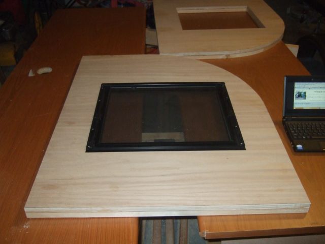

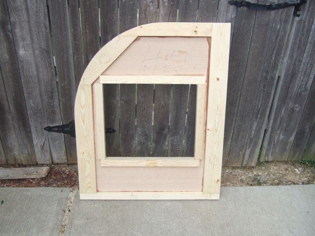

The cabin doors are coming along. It'll be nice to finish these since they have so many parts currently spread all over. The windows are 15x18 crank out types from Grant. I have a set of door hardware from him as well.
Note the ginormous size compared to the camping data surfer.
A little bit of insulation was possible in the doors, so we went for it.
The hi-tech gravity clamps were at it again.

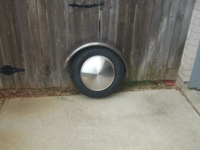

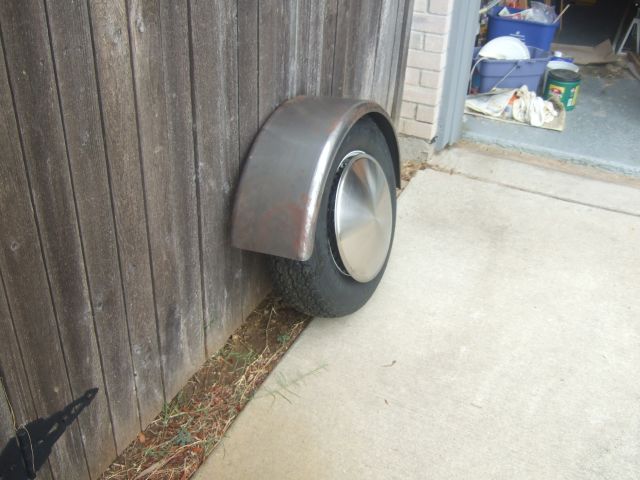

I've been really looking hard at fenders. I've seen many the looked cool, especially the swoopy late '30s reproductions. I keep coming back to a simple elegant style. I snagged these at Northern Tool for $27 each. The discs are from Hubcap Mike's.

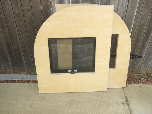

The gravity clamps came off this morning, so we were able to get a clear look at the doors. They weigh about 15 lbs each like this. With the window, door hardware, hinges, etc. they are 24 lbs each.
Inner side of the window. More trim to think about. How many edges are on this thing anyway. Oy vey.

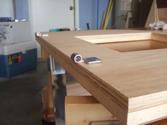

Hinge shot. I think I'll do some kind of spacer to help them stand off a bit in order to get better squish (more even) of the weather strip as the door closes.

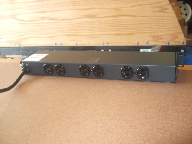

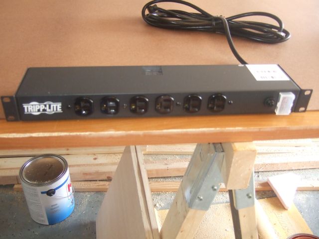

I'm taking a different route for 120v power. I found this neat rack mount "power strip" at a computer hardware store. It has 6 outlets on each side. More Power! Argh argh argh.

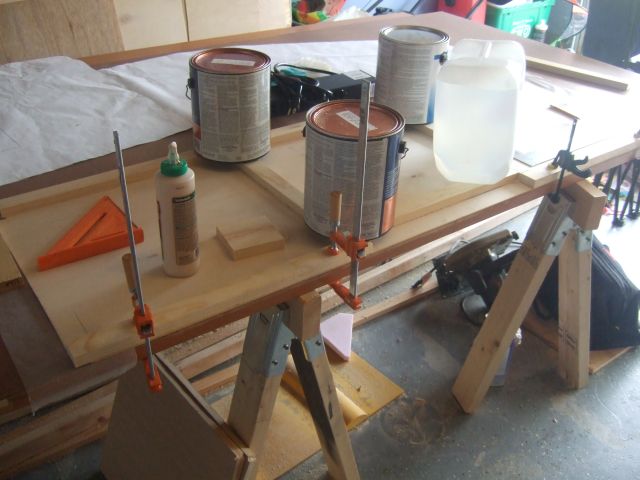

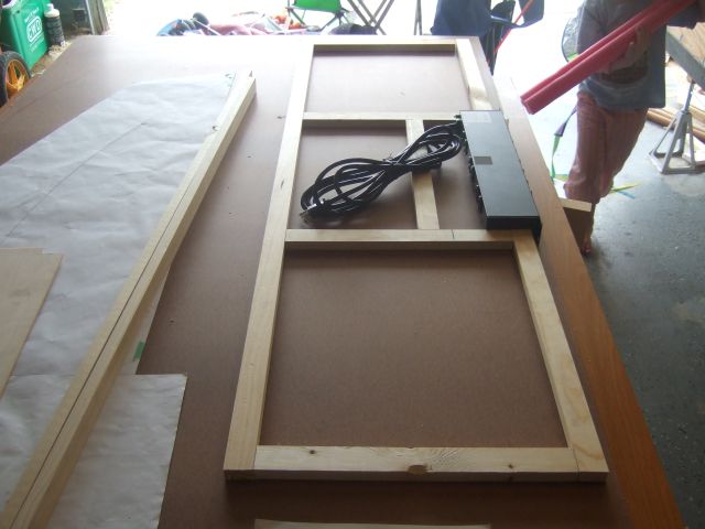

Bulkhead framing is laid out. The Working Stiff is home schooled, so I gave him a pop quiz in math. He had to add, subtract, multiply and divide in fractions to get all the dimensions for the framing correct. He scored 100%.

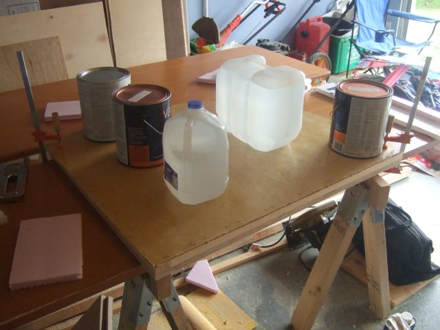

The bulkhead is laid up. Gravity clamps in action once again. The 4th pint of Titebond has just been killed off. Need to buy stock in that company.

I have really enjoyed looking at your build photos. Go Tripp-Lite!!! I use them in all my computers applications. I am just starting as a TD lover and i have just started in on making plans. I know nothing of the electrical part of this, but what does this plug into?

rhltechie wrote:I have really enjoyed looking at your build photos. Go Tripp-Lite!!! I use them in all my computers applications. I am just starting as a TD lover and i have just started in on making plans. I know nothing of the electrical part of this, but what does this plug into?
