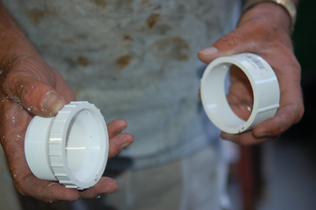

Oops...time for another update...after our aborted Father's Day Trip, we shifted into high gear in order to get ready for our upcoming trip to Lake Almanor for a week of camping over the 4th of July. Had to complete the Pet Cool installation before this outing as my mom was joining me for the week and would need respite!

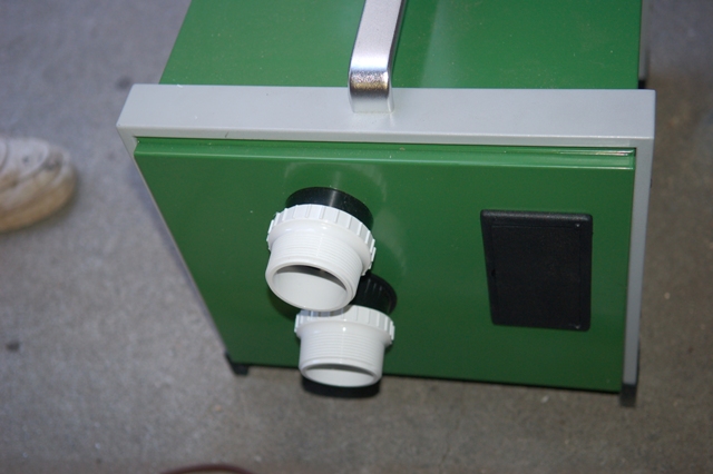

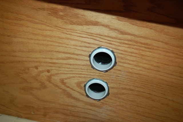

So, we used pvc couplers…trimming one end so they fit flush…
Both holes are held in the cabin with a flat washer/nut.

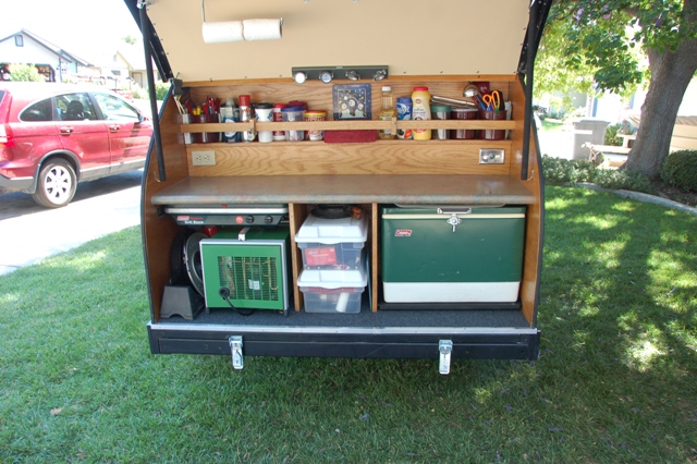

Pet Cool rides on the galley floor; with Coleman stove above it….upon arrival, and stove’s removal, it must sit on a little shelf so that the holes in the bulkhead could be placed high enough for the bedding not to interfere. The controls face the bulkhead, however… so we simply unplug to turn on and off. Worked pretty well. We may eventually put a kill switch for the galley outlet inside the cabin. For now we are only using it with the hatch propped; soon we’ll be putting a vent in the side.
PS Camping at Almanor was perfect. Mom and I spent the week up there with all three boys. They slept in the sidetent. Mom enjoyed the Pet Cool in the afternoons for a nap while we boated and such. Canopy set up was perfect. (Pics next time!)

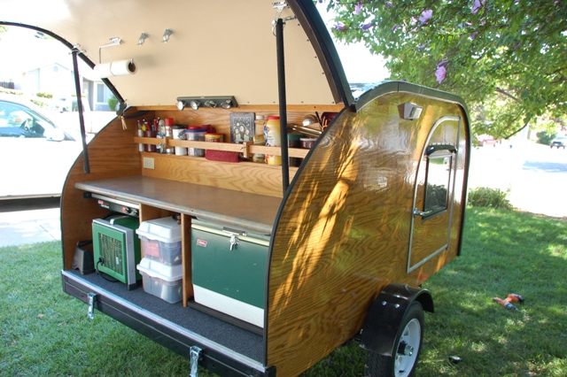

Now that we're preparing for our first long trip with the tear, we're working on some details...lined the hatch with 1/8 baltic birch. Cut it to width and and approximate length, mounted it and then routed it for a clean finish. Hauled it to the Durham Classic Car Show, so our neighbor...who's been a big help, could show it with his ’57 Chevy. Lots of attention…!

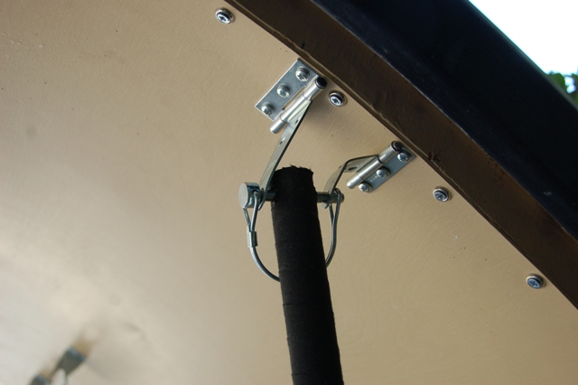

Oh yeah...we put in out hatch supports a couple of weeks ago...we used hinges to make swinging supports that stow against the hatch. Covered galvanized pipe with black friction tape...looks pretty nice.
We carpeted the galley using the carpet tiles we picked up from Costco for another project..finished it off with 1" aluminum angle...we have a scrap of diamond plate that will go along the bottom eventually.

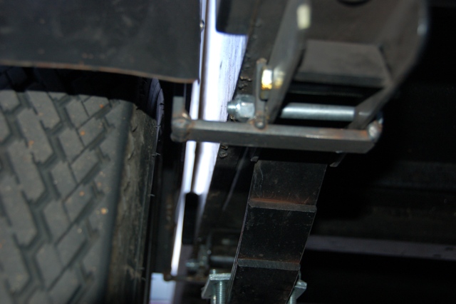

A few more build notes...we did get our fenders mounted. Welded some one inch steel bar into brackets that cinch right up onto the mount for the leaf springs. Then ran a bolt through. They are quite solid now...and will come off this winter for a final paint and finish now that we're done.

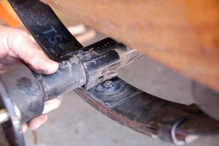

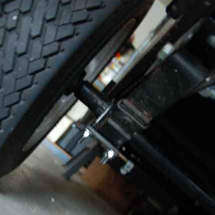

After the Dam Gathering we were inspired to get busy...so we flipped the axle on our HF trailer last weekend. Wanted everything to ride a little lower. We had done all our research and took the plunge. Went as planned for the most part.
Had to have a couple custom plates made as the originals were already curved a tad,
Lowered everything two inches...now we have to have the fender brackets extended :( (They're just sitting on a box) I'll post a better pic soon.

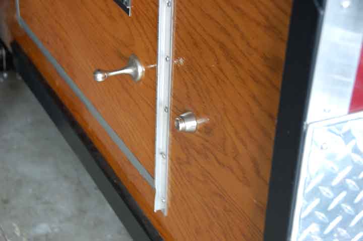

Notice the door stops...magnetic...look good and worked fine!
