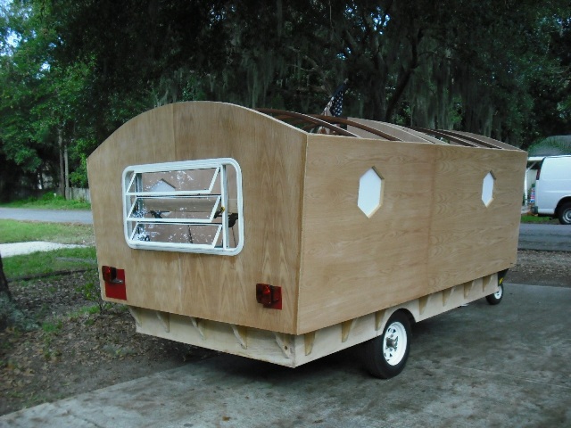

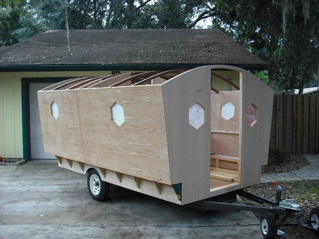

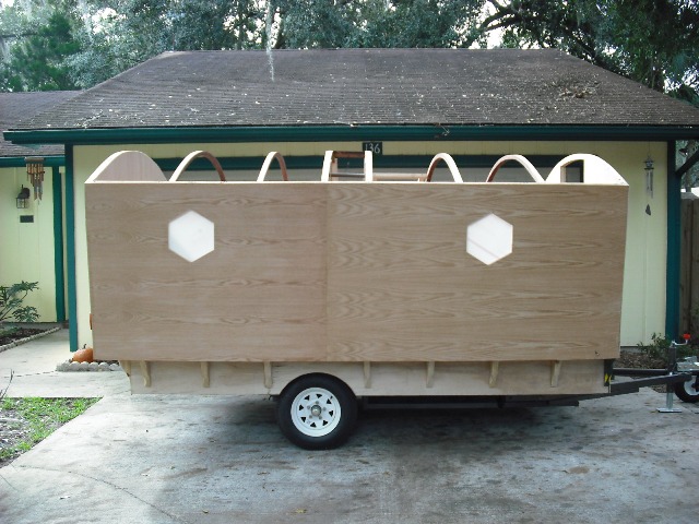

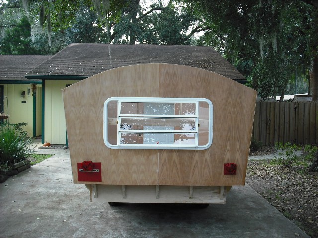

Postby Steve_Cox » Sat Nov 01, 2008 8:11 pm
EffieRover wrote:
Steve_Cox wrote:I might need some help with colors, trim ideas and stuff like that. You know when I built my teardrop Kerry finished the trim on it with photoshop :roll:
Can you post straight-on of the side and front to mock up? Or a 45degree corner? I'd like to work something up ... just for fun.
I'll roll it out tomorrow and take a few updated pictures(if it's not raining), side, front, back, 45 degree. This sounds like fun :thumbsup: .......
edit:
Here ya go! I stuck the back window in for the pictures. Modern RV window isn't quite gypsy wagonish, but I couldn't beat the price for an opening awning window that size. About $50 on E-bay.

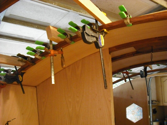

Postby Steve_Cox » Sun Nov 02, 2008 10:30 pm
I got the middle third of the roof epoxied on today. Got epoxy drips in my hair.... that was fun :lol:

Postby Steve_Cox » Mon Nov 03, 2008 7:55 am
Hi John,
:lol: Ok first of all, I don't care how ya say it up North. 8) Middle is is in the center down here. :lol:
I put the center piece on first so I could clamp both sides (front and back) to the roof spars.
