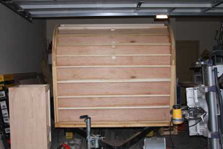

Postby wlivesey » Sat Jul 11, 2009 3:26 pm

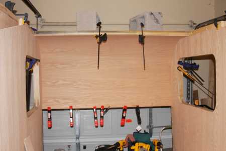

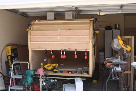

We made some progress today. We stopped working earlier than usual - it's too stinking hot outside... The heat index was about 105 degrees when we threw in the towel. We might, however, head back out there this evening after it cools off. By "cool", I mean back into the upper nintys. :?
Believe it or not, that's 1/4 inch Oak plywood on the bend. We scratched the lexan window idea...

Postby starleen2 » Sat Jul 11, 2009 10:16 pm
I see you have joined the "Whole lotta Clamps Club" BTW - Do Cement blocks count as clamps? :roll:

Postby wlivesey » Sun Jul 12, 2009 6:10 am
starleen2 wrote:I see you have joined the "Whole lotta Clamps Club" BTW - Do Cement blocks count as clamps? :roll:
That's not the half of it. I've got more clamps laying around these days...
I believe I've also joined the "I've bent wood club"!
I bought those cement blocks (6 of 'em) when I started putting together my frame. I had no idea I was going to use them for so many other things. Maybe I could start a "Whole lotta Cement Blocks Club" too.

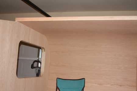

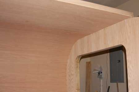

Postby wlivesey » Sun Jul 12, 2009 8:43 pm
Today we finished up the interior skin on the front and non-moving ceiling. We are really happy with how well the interior is turning out. It's a lot of time consuming work, but somehow, it's easier than I though it would be.

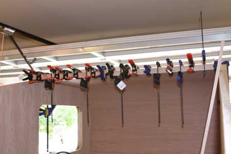

Talk about a lot of clamps...

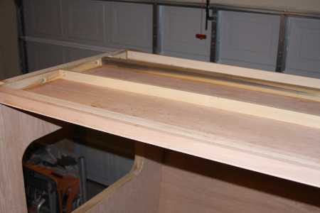

I used three, yes three, pieces of 1x2 red oak to form a super strong header for the hatch opening. Surely it's overkill but I like to be consistent.
The hatch is next!
