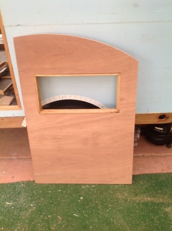

Postby Junkboy999 » Sat Jun 01, 2013 1:28 pm
There is alway more than one way to skin a cat, same for making doors. It looks like it will work out and you know the door and the opening will match and have the same size space around it. Keep it up.

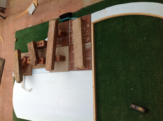

Postby RogHodge » Thu Jun 06, 2013 10:40 am
Laurie, you might have a look at this link, it has a few more pictures and some thoughts about wall/roof attachment
http://www.tnttt.com/viewtopic.php?f=21&t=56056&p=1016920#p1016920
Also if "fixing" the foam means glueing to the ply i shall show you what I did. You may have to procure some gravity clamps. These are very difficult to come by. I have patent on this. So be careful. See pic
I used titebond to glue. I'm sure TBIII would work just as well if not better. Gorilla glue would be extremely expensive and that stuff is kind of a pain to work with. But it would probably be even better.
I poured the glue out of my 1 gallon bottle and spread it around using an 1/8 inch notched trowel. The trial has been the best option so far as using sticks or fingers or putty knives is more messy and doesn't provide even coverage.
Slap the foam to the ply then apply gravity clamps wait for a day viola' it's done. Glue dries much more slowly in this situation since one surface is impervious to moisture. However it eventually does dry and the adhesion level seems quite high. Although I have not used full human strength to attempt to rip the foam off of the ply it is quite stiff and stuck and I believe sufficiently so for our purposes

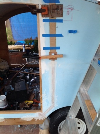

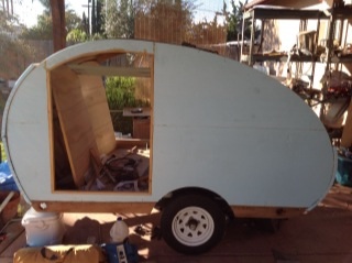

Postby RogHodge » Sat Jan 25, 2014 8:09 am
Well there has been progress,
And while my intent was to catalogue each step... Well, I didn't :oops:
Ok so here are some pics

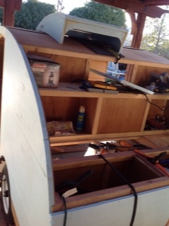

The first pic shows my vent cover, a bit massive I think. Likely going to be reduced
General galley shot and profile.

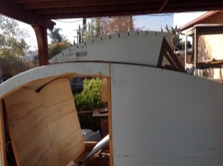

Postby RogHodge » Sat Jan 25, 2014 8:39 am
Well crud, if you navigate away from this page all text goes away :cry:
Imagine witty words of wisdom flowing forth describing each photo.
The brief version-

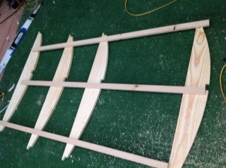

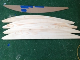

After hours of debate regarding style and materials I make a quick trip to HD
Template and pattern following bit creates 4 mostly identical 'ribs?' Notch the ribs in rather crude fashion. Gather the pieces for assembly- pray Alan Shepard's pre launch prayer. Glue and shoot the parts and Viola' I think it just might work!

Postby RogHodge » Wed Jan 29, 2014 6:33 pm

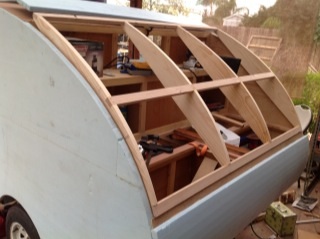

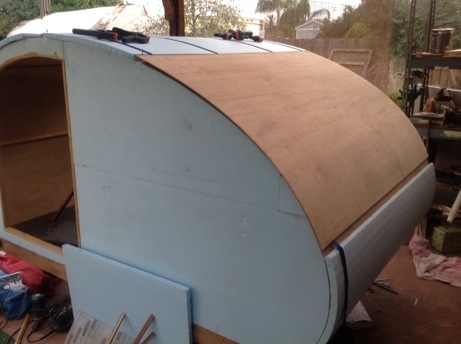

Galley lid and blue foam skin coming together

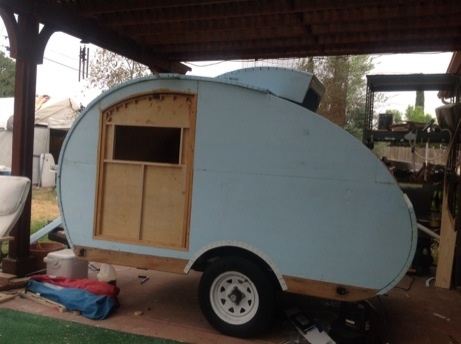

Re: Quazi-ultralight the undertaking

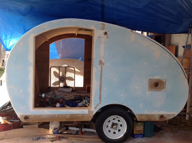

Postby RogHodge » Wed Jan 29, 2014 6:41 pm

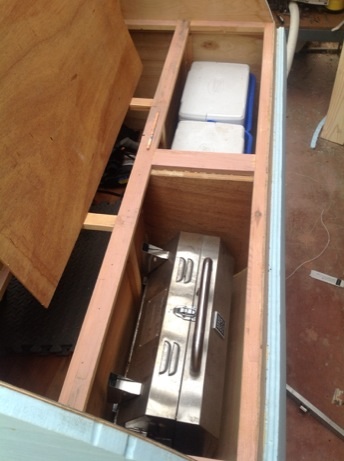

A few more shots of work in progress. I think we have a profile, BBQ and cooler storage- under galley, which I'm still not sure how to finish ??, and a door with window frame. And that massive vent cover will be changed to be much smaller

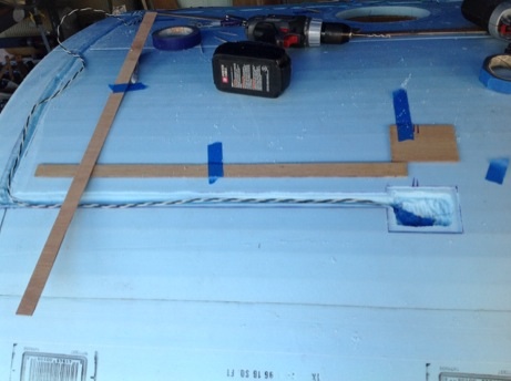

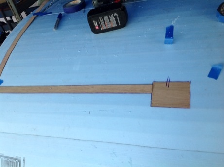

Postby RogHodge » Mon Feb 17, 2014 1:46 pm
I have decided to 'Channel'' the wires. Most of the process if going to be recorded at think above, but since my first patient didn't show up, I'll put a couple pics here.
The original plan was to cut a 1" channel in the foam and cover that with a foam strip. Seemed like a good idea, but in practice was a bit af a hassle. Plan 'b' may seem like more work but I think in practice it is more usefull. I took my handy dandy sharpie and marked an outline where I wanted the channel. Set my dremmel to cut 1/8" deep. Used the' router' base attachment and free handed the 1/8' recess. For a few wires 1" seemed sufficient. At times I went closer to 2".
From there took another bit-rasp type- and hogged out the channel, careful to leave a 'shelf' of recess on each side. And Viola :thumbsup: as you can see I cut some strips of 1/8 ply to cover the grooves. Glued in with a little titebond II and smooth over with the vinyl mud.
Since I'm sound more of a hybrid I have no danger of going all the way through the foam, unless I go crazy, since I have the inner ply layer. I'm sure this technique can be adapted to many other projects :thinking: maybe 'central air ducts'?

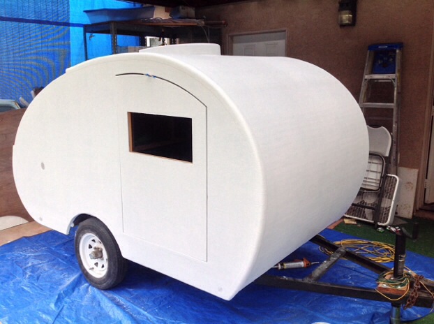

Postby RogHodge » Sun Jul 20, 2014 10:30 am
In my usual yet unintentional style, I left for an extended period and one have returned with the hopes of receiving an encouraging word from faithful followers.
So there we are ready for canvas, which I suspended from the pergola to facilitate the process
While sharing the pics with a friend I was asked if I was going to perform a magic trick :thinking:
So I did.
